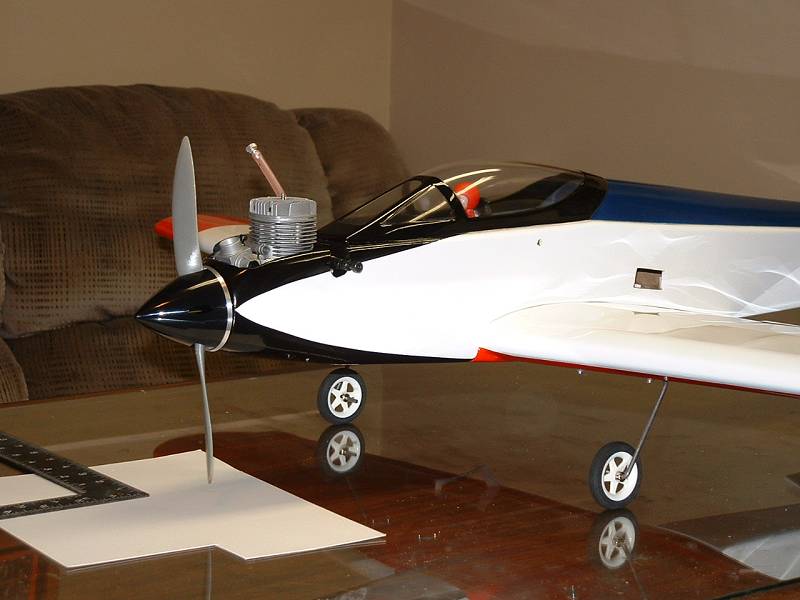

OK speed boys, I have a small Kobra with a 46 stuffed in it. Anything larger than a 9" prop hits the ground. What would be a good conversion for a 10x7 or 11x5 2 blade to a 3 blade?????? To many RPMs with a 9".

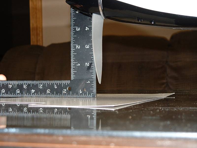

Here is the problem, picture shows a 9x7 prop and the tail is not completely level. Only a 1/2 to 3/4".
