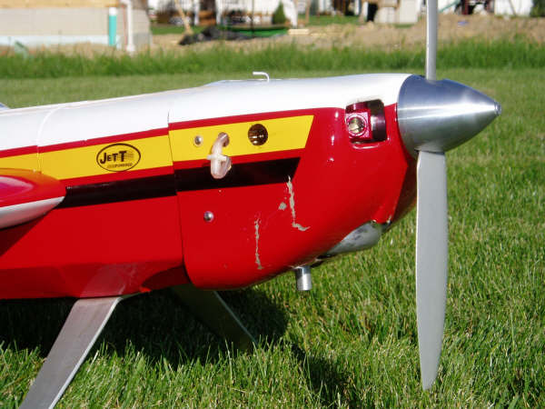

I just do this......
either a filter (best way) or an inline connector.
In fact, this installation originally was a dubro valve. I had not used one in a while, figured I would give it a fair chance. Lasted on there exactly 3 flameouts. Why no 3 line? This is a bubble tank in there. Experiment was successful... learned what not to do.
Appearance is 100% secondary to 100% reliable.
Three-line system is fair game too. A few of the planes I fly are configured that way when using conventional tanks.
