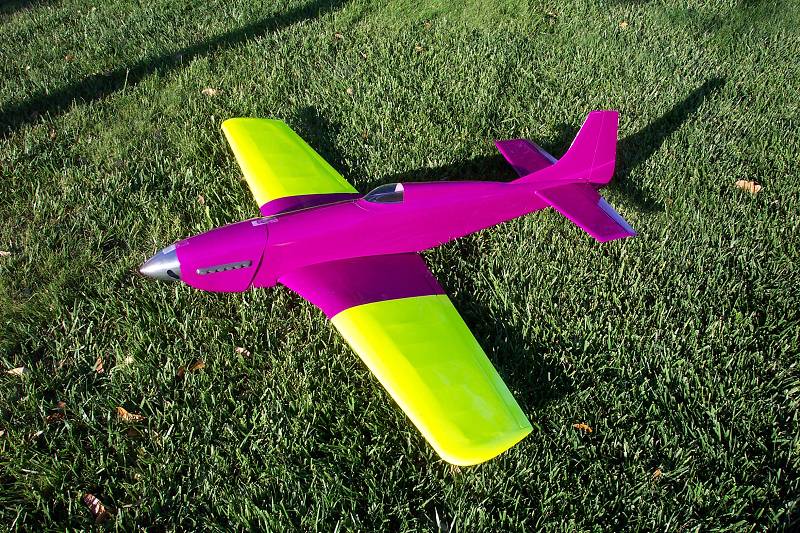

Ready to load the guts. Carbon and glass reinforced throughout. No cooling scoop on bottom, small streamlined canopy. Black on bottom, the florescent purple and yellow don't come out well on camera. This plane I can see and it won't get confused with other planes by the turn marshals.
Yes, in the Rockwell trim (stock P-51) it would creep away from the stock YS 110S when they were fed 20/20. The gold class, tweaked, god knows the nitro content,..... well that may be another story.
I looked at pitch speed too Danno. It seems to be well exceeding it. The “Speedboy” phenomenon is back
. The 11X8 @ 16K is much faster than the 10X9 @ 16.3K go figure.
I was all done and ready to fly all I had to do is check the C.G. It was 3/8” off , nose heavy.
So I moved the battery from the LE of the wing and strapped it to the top of the wing at the TE just over the servos. Still a tad nose heavy.
Apparently my mods to the tail feathers and fuselage made it lighter aft.

I flew it on Thursday and it flies very nice and light, only a few click off trim. CG is perfect.
Had the wrong glow plug in the engine and that was quickly rectified. The first flight was short and ended in a dead stick but nice landing, floated in.
Second and last flight was 8 minutes at WOT and made a nice engine on landing.
I need to add some 2" wide black stripes near the wing tips. That yellow is undefined at distance and speed, its just a blur, too easy to over rotate for a turn.

Well it was a lot of good news, bad news, good news.
First off, the mods didn’t seem to make that much difference so I won’t be going that route again, just not worth the effort for a plane that can die so quickly. I got positive comments on the colors. The black stripe helped.
Now for the shocker: On the day before the race, fourth flight for the plane I had just completed a good practice round and everything performed great so I decided it’s time to land. The landing was perfect just like the others before. The plane was almost rolling to a stop in front of me when THE WING FELL OFF! The two wing screws were totally gone so the only thing that had been holding the wing on were the positive Gs (Which is so totally unlike my normal fling style). No damage except for the tips of the prop as the engine was at idle when it happened, but now I had one prop left. I replaced the prop and remembered to put blue lock tight on the screws this time.
I flew another practice round and did a few victory rolls and went to land. I made a landing attempt but the plane didn’t want to come down normally so I went around figuring the cross wind was to blame.
As I did a left turn to come back to the runway I noticed I had to use a lot of aileron to turn it. Setting up for the landing it did it again but I pushed it down anyway. It all looked good until at about 5 feet it snapped inverted and went in breaking the tail section off and trashing the spinner.
Totally confused and POed, I packed it up and went home. It was at home when I discovered the left aileron under power was down almost a ¼”. The wing only had a small scratch at the tip. It wasn’t the wind I was fighting, it was that bad servo. That made me feel better, I was about to swear off bad cross wind landing warbirds.
The tail is back on strait but the canopy and engine cowling have road rash and I’m going to leave it. I missed this race… next time.

Pure evil. Bad, bad, bad. You're not the only one who has been betrayed by faulty equipment. There are so many ways to get bit.
The wing screw deal is strange to me, then the faulty servo, sounds fishy. I'm glad to hear it is fixable.....check the engine mounting with a good amount of muscle before you fly it again.
