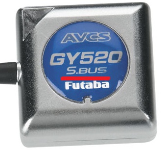

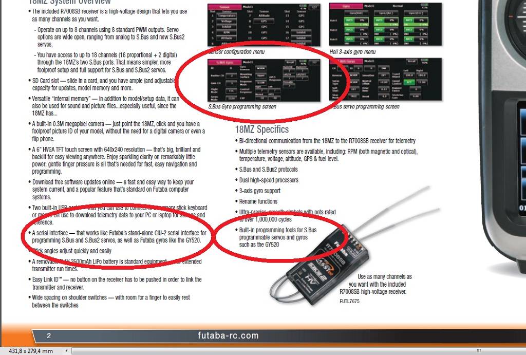

I'm rather sure I saw S-BUS Gyro programming feature in some early video of the MZ18 but now when I need it I simply can not locate the menu [&o]
Also manual is silent about the feature but futz2011-futaba-catalog.pdf -marketing material states:
• A seriaI interface — that works like Futaba’s stand-alone CIU-2 serial interface for
programming S.Bus and S.Bus2 servos, as well as Futaba gyros like the GY520."
• Built-in programming tools for S.Bus
programmable servos and gyros
such as the GY520
I have used full hour to browse through menus but can only find SBUS servo programming menu Please advice.
and final question: Any idea when fuel level SBUS2 sensor will be available? Will it be compatible with JetA1?

This is explained on page 32 of the instruction manual. You program a device such as the GYA750 at the device, itself, but you also use parameters in the gyro and governor menus of the transmitter. You do not program the device from the transmitter.
We have no information on a fuel quantity sensor, so we cannot comment on it. Whenever, or if, Futaba releases information, we'll know.

OK, it depends upon the device. The CGY750 is not programmed via the transmitter.
The GY-520 gyro is not a S-Bus unit. It would need an S-Bus decoder to operate on the S-Bus:
FUTM4191 SBD-1 SBUS DECODER 1600MM US$69.99
FUTM4192 SBD-1 SBUS DECODER 1100MM US$67.99
These parts can be ordered through any hobby retailer who sells Futaba systems and accessories.
To program a unit from the transmitter, though, you just plug it in and enter the servo programming screen. The available parameters will show up as the transmitter senses the device that's attached. Otherwise, your best bet is to purchase the CIU-2 interface and download the software to do it from your PC.

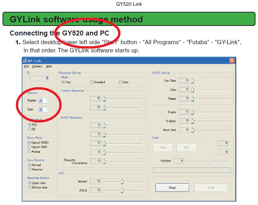

Sorry, I was reading our web page and was thinking about how it's programmed. Here's what we say about programming the GY520:
http://www.futaba-rc.com/gyros/futm0807.html
"2 Ways To Program!
Directly, using the GY520's push-button and 2-color LED.
Remotely, using a PC and the optional CIU-2 USB interface. Both required. Click here to download PC software (zip file)."
If you want to program it, you'll need the GYLink software and a CIU-2 USB interface. You need to connect the gyro to the computer via the CIU-2 interface. You cannot plug the gyro directly into the computer.
The instructions for the PC-Link software detail how to set the GY-520 to the S-Bus. It's on page 8.
If you're going to run it on S-Bus, it looks like you have to connect an S-bus output to the gain channel, and an S-Bus output to the rudder channel. The CIU-2 interface and GYLink software are used to set which channels of the transmitter will be sending gain and rudder information.

It seems that there is no need to have CIU-2 at all in order to utilize SBUS control method (if GY-520 has default setup values)!
The Gyro can be connected by default with SINGLE cable to receiver's SBUS output (I think it was rudder channel input of the gyro to sbus output of the RX but may remember wrong now). Then Rudder = SBUS channel2 and Gain = SBUS channel3 (unless default values was changed earlier with CIU-2 by someone). So just set function assignments on your transmitter accordingly and use the sbus signal. If you need to change default channels then CIU-2 is necessary as MZ18 can not do it like with Servos
