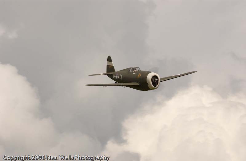

how much does that "Bob Cambell P-40" weigh ??
my friend's 106' Span P47 weighs 37 pounds and is powered by an older Sachs 4.2 (69cc), with a Bolly (24x10) Carbon it's very well powered,
the key to "this" setup is the Carbon Prop, it wasn't as fast with the Menz Wood..

The plane I have is a bates 97". The plans call for a 60cc to 100cc. I need a single cylinder or an inline twin. Any Ideas?
Old 10-14-2010 | 03:50 PM
Joined: Sep 2003
Posts: 5,643
Received 51 Likes on 49 Posts
From: VT
Default RE: Need an engine
(97"/60cc to 100cc)
DA is a good powerful Engine with great support !! looking at my friend's P47 I'm sure the DA-85 would do the job,,
on the other hand you don't need the most expensive Engine and you do not want a cheap-O brand, my other friend has a First Place 90 (maybe it's a 95 ???) and it has been a very good engine so far, it has been flying for 3 years, and it's powerful for sure,,
see my friends P47 (106"/ 37 pounds, Carbon Bolly), look close and you will see the older Sachs 69cc,,,
