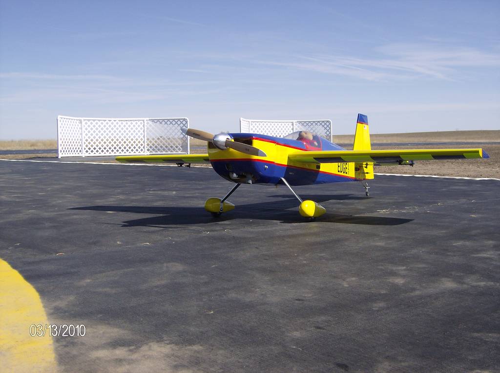

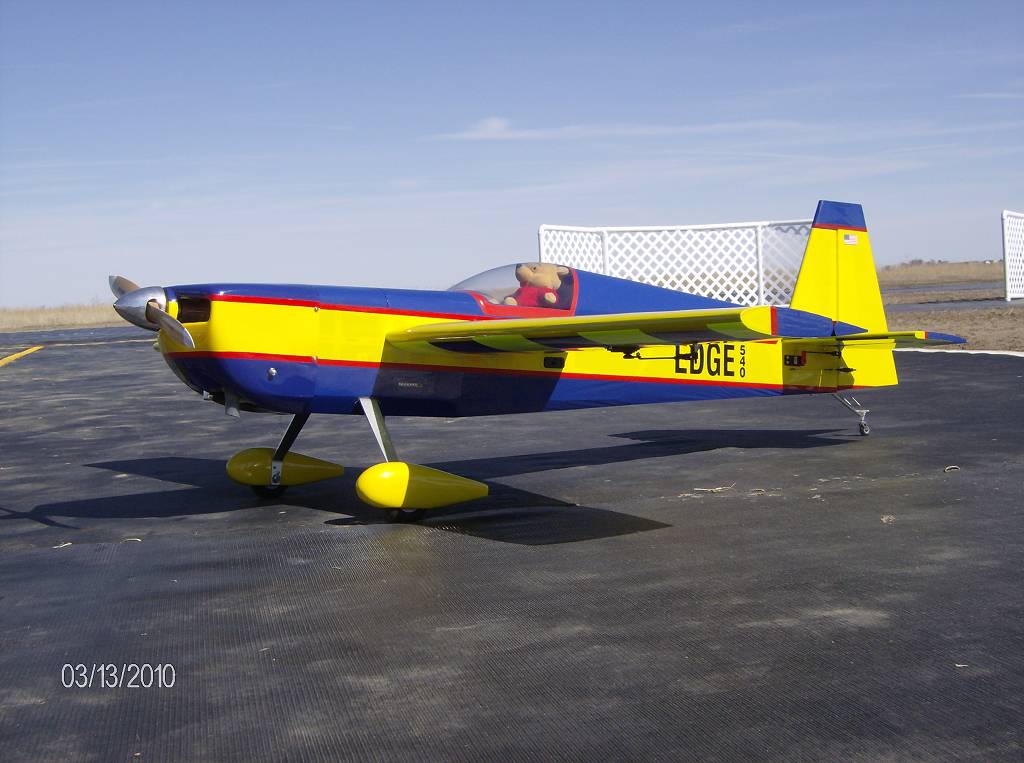

I can't explain all your problems. I have one of the original DLE30 with th side carb & it runs great! 1/2 gallon of fuel isn't a heck of a lot to get it broke in & idling proberly. Your oil & prop are good brands. Mine wouldn't idle very well either until I got atleast 2 gallons run through it. Some of the forums suggest that break in doesn't accure until 4 gallons +. This is just another opinion. I can't explain the vibration, except that most gassers vibrate more than usual until they get closer to break in. Mine did. It's fairly smooth now & I can get my idle down to 1550 - 1600 rpm. This is just slow enough to keep my Edge from roll on the runway by itself. All I can say is hang in there. It's a good engine, side carb & all. I'm sure many are going to tell you to change it to rear carb. "I'm not going to fix mine if it's not broke".
