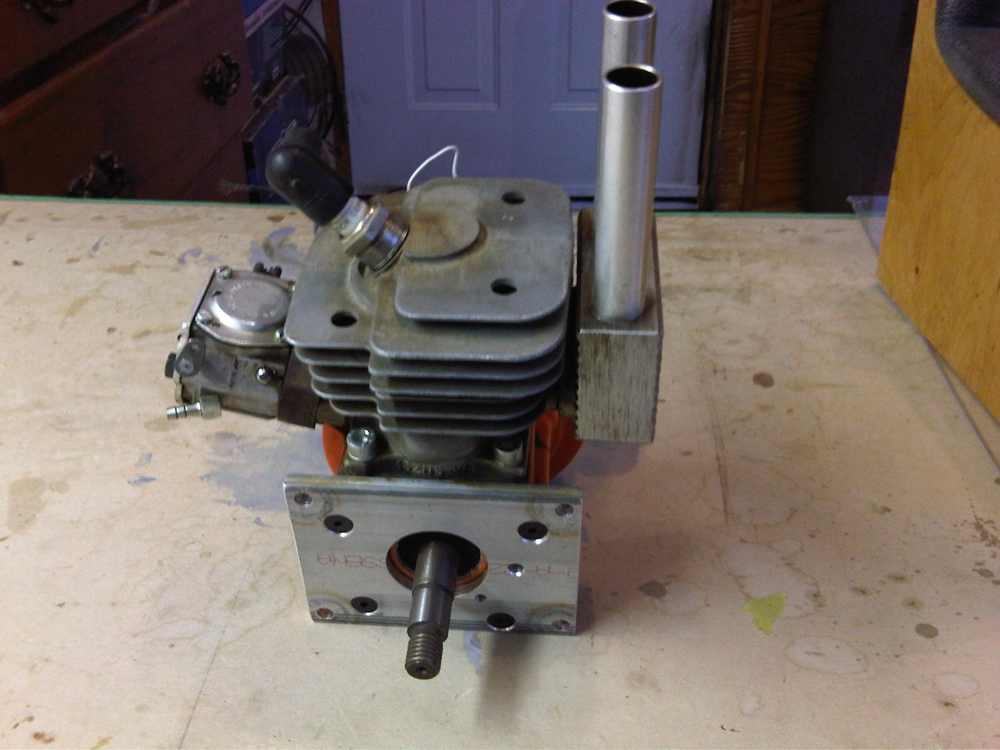

Need help identifying this engine
Came off a 1/3 scale 96" wing span Laser 200
Anyone know what engine this is?
Frank

Looks like it has a 45 mm bore?
3.2 Sachs Dolmar chain saw conversion

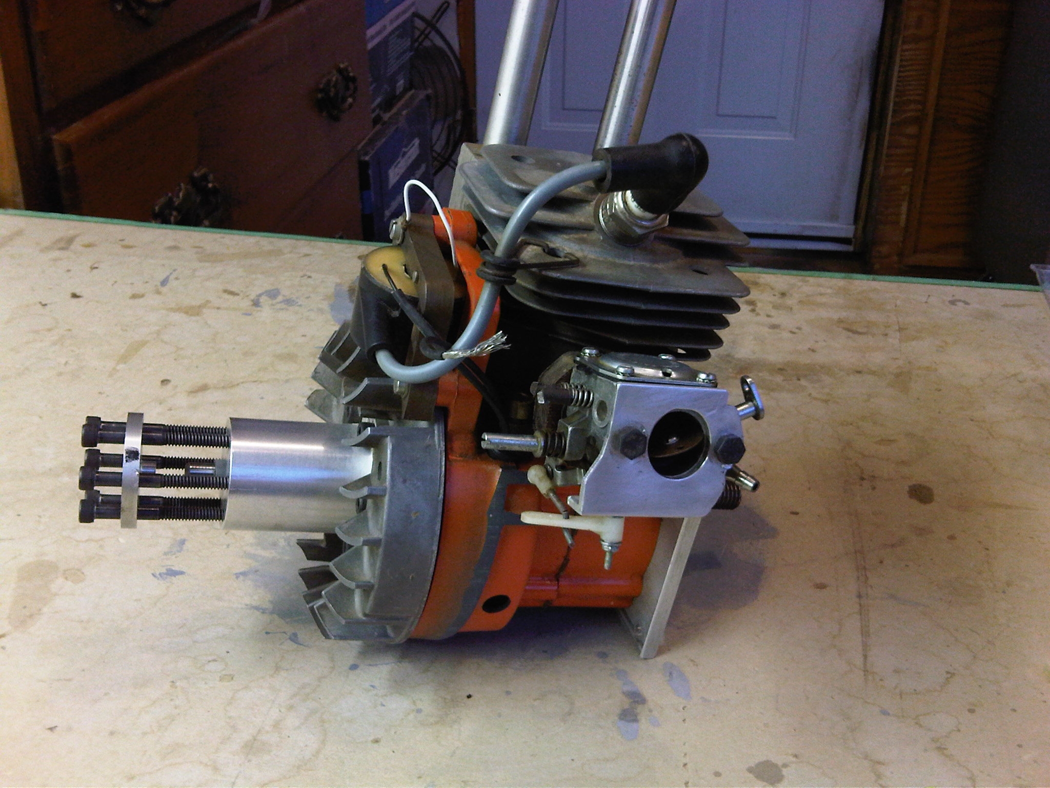

Sachs Dolmer 53 cc engine. Not sure who did the conversion but looks a bit like the ones Bennett sold though most of his had a single prop bolt. Has the Bennett muffler on it. Good engine though not as common as the 3.2 ci / 52 cc engine.

It could be a Brija converted Sachs 4.2. I think Dick Bennett did sell them.

Not a 4.2 because of the 45mm bore shown on the cylinder. I believe the 4.2 has a 49 mm bore.

As Truckracer said it is only 53 cc. It is not a 3.7 it is a 3.2
More of a 22 X 8 and maybe a 22 X 10 engine.

Not a Brija (that would be me) conversion. Very similar but yet several differences. I always painted the engine case after trimming, carb linkage was mounted directly on the crankcase, all crankcases were tapped for smoke, all flywheels had the fins removed, ignition did not have a ground wire, backplate was thinner and releived for the spring starter which they all had and I never built anything but a 4.2. As a side note to the new owner, I doubt there is any normal living human being with an arm big enough to hand start that engine/ignition combination and the reason all of mine had spring starters. That one will require an electric starter.

A 3.7 Sachs has a 47mm bore...
