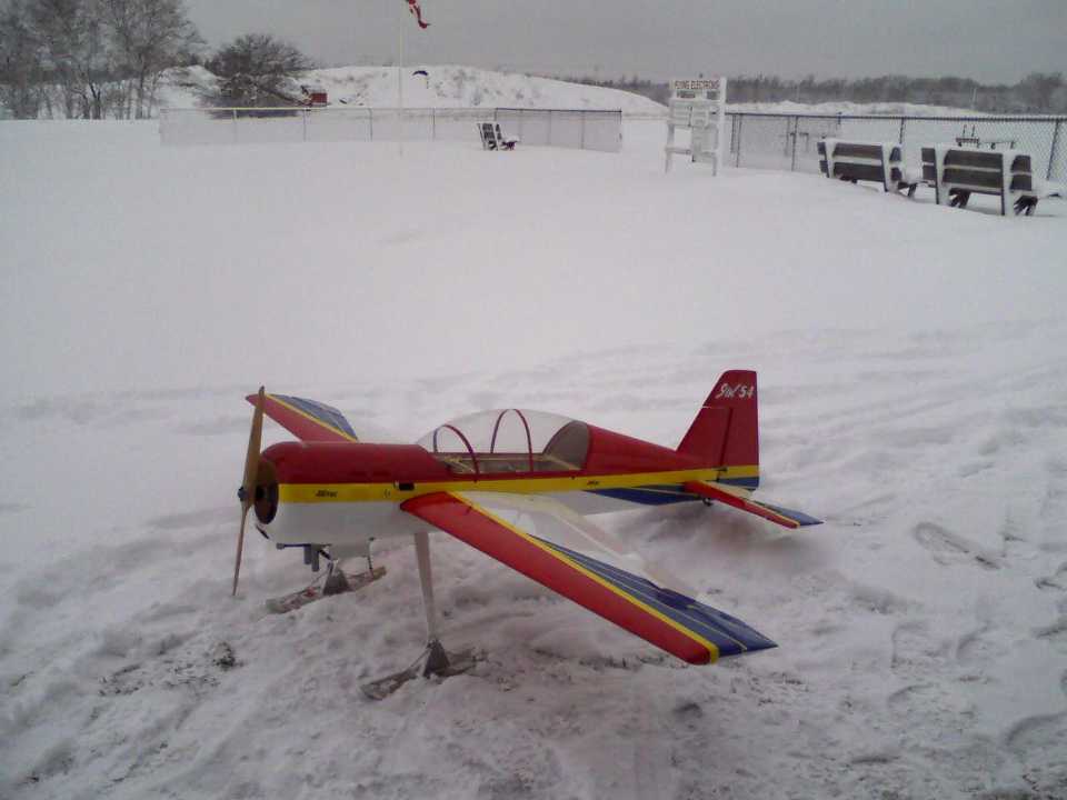

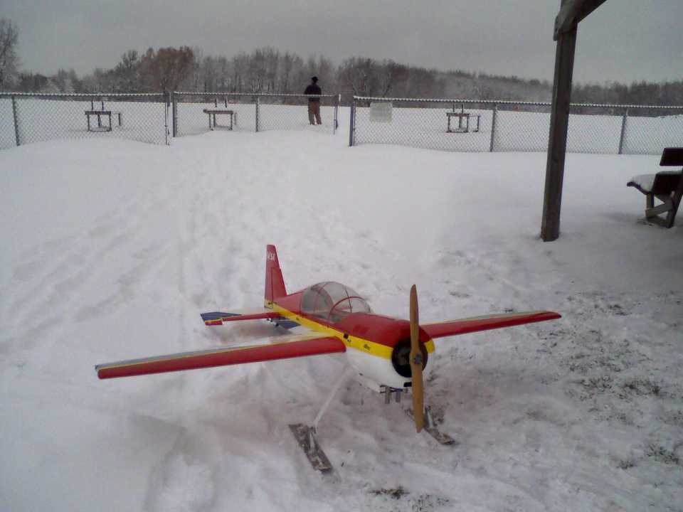

Actually that's ideal break in temperature for a gas engine. It will be very happy. In fact it would be happy in that temperature all its life. You have to richen the needles quite a bit to fly in those temperatures. I'd say a 1/4 turn more rich on both needles. That's what I found out from flying in snow:
ID:	1534431   Click image for larger version

Now if your radio system had on-board temp...you could moniter the temp & have a trim tab to open & close the air flowinto the cowl. Man that would be neat!!!! I used to fly in the winter.....years ago but that was with Glow engines. Off the lake in any direction...was fun if the sun was out a bit! Capt,n
