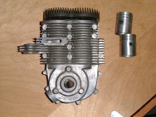

here is some serious offset
If you look around -there are some really quirky engine designs - which usually had too may faults to make em popular

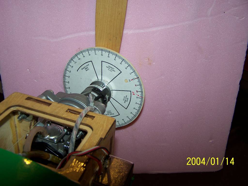

Look at no#4 with a timing light and tell me you see.I need some one else to check this and tell me I haven' lost it.I have sent parts to Ralph so he can check this.
BCCHI

#48
I will place my airplane on my airplane test stand and put a timing lught on the engine soon. If things go good.. I should learn and post.some data here. Hope this photo uploads...pretty hard to do lately!
Capt,n
