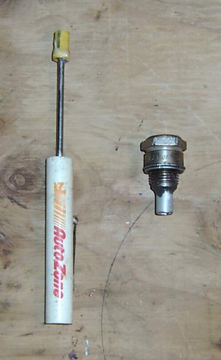

I would like to check the timing of my engines using Milton's video but I can't find a source for a piston stop. Can one be made from a spark plug or who has them? Dan.

Default RE: Piston Stop Using A Spark Plug
Hi,
I have seen piston stops for sale, but I can't remember where. I just gutted a spark plug, and used JB Weld to install a piece of aluminum tubing for the stop. You could use a dowel, but the tubing allows the air to escape and lets the engine turn over easily when doing timing chores.

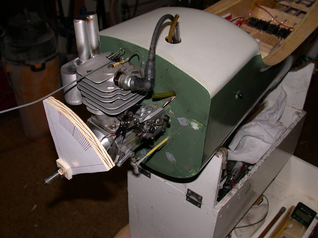

Between Milton's video and TOM's recommendation to eye ball TDC through the spark plug hole, I did a set up as seen in the attached image. Much to my surprise, the spark plug fired at 28 degrees. Definitely a benificial thread. Dan.
