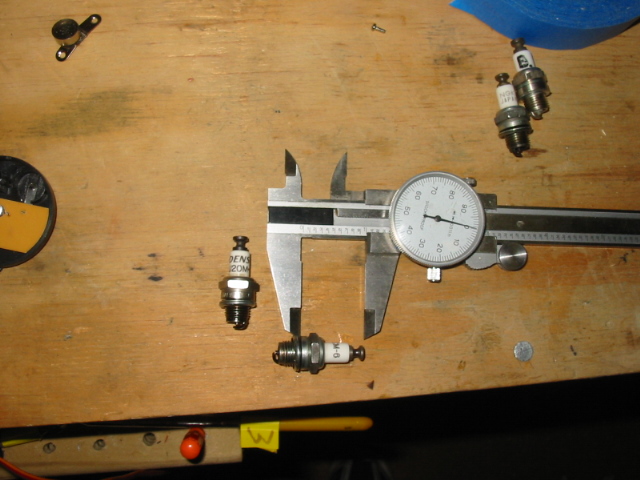

Can anyone tell me how much difference in height there is between a 5/8" taper seat plug and a CM-6 plug with an adapter?
I have a tight cowl situation with a twin and need to know how much distance I can save by using a CM-6 plug with adapter as opposed to the current 5/8" hex taper seat plugs in the engine.

Av8tor, the CM6 is one inch high + .075 for the gasket. The Denso is about the same, and can be bought at Advanced Auto supply.....far cheaper. The adapter you use could be custom made to shorten the total length somewhat. You are handy....you may come up with something better than a over the market adapter. Best Regards Capt,n

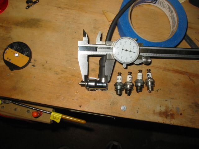

The Rcexl ignition I have has a resistor inside the cap & the CM6 plug is a non resistor sparkgplug. It sure seems like a small rubber boot may work as long as the braid had a short wire with a lug bolted to engine ground. I guess a guy could set one up and do some extensive range checking. Capt,n
Below are photos. The caliper is set too 1 inch. With cap & gasket = 1.25 inch. All plugs in photo are 1 inch...with-out gasket.
