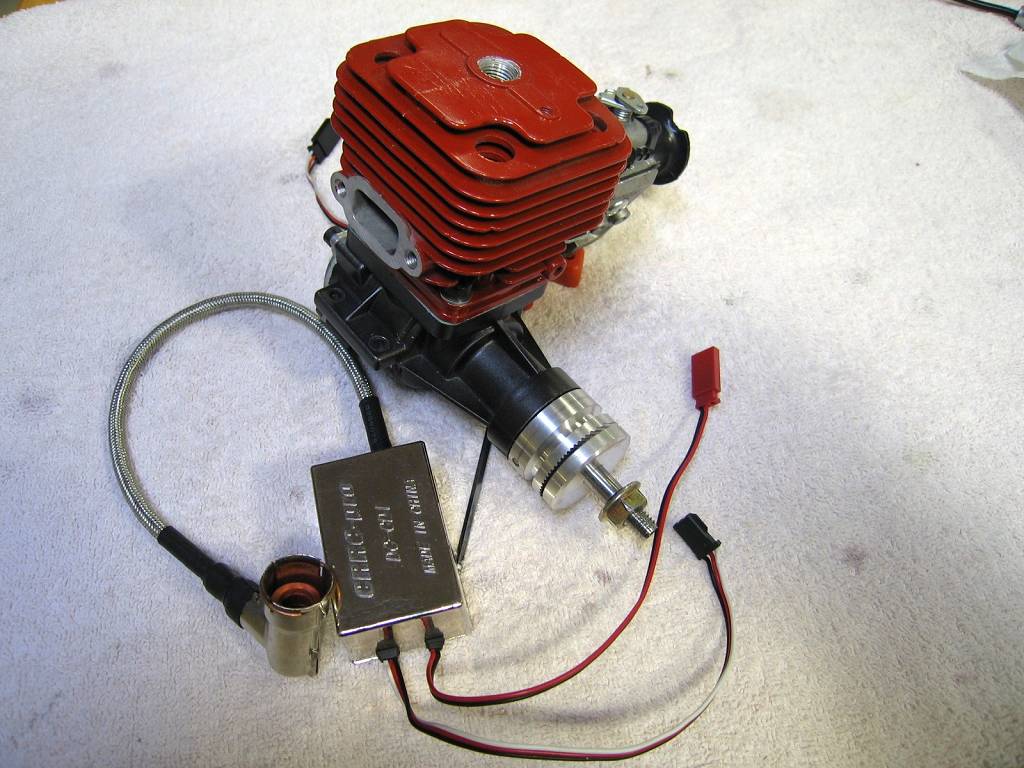

i just got a new motor a few days and i can't get it to fire i know its getting fuel and compression i don't think i'm getting any spark i did a spark test like i would have on a small block chevy so i was wondering if i was doing it right or is there a spiecal way to do it with rc gasser motors

my motor is a crrc 26cc

here whats going on i got my volt meter and checked it i'm getting power from my battery and when i turn on the switch to the ignintion the plug sparks but when i turn the crank i get no spark

You might want to check the connection between the sensor pick-up and the ignition module. There could be a loose wire or poor contact between the individual pins. Also check the area underneath the senor to see if maybe they forgot to install the triggering magnet. You can test the sensor with a bar magnet too to make sure the sensor is working. The sensor is a hall effect unit that needs the correct pole of the magnet to trigger it. It could be the magnet is mounted backwards and is not presenting the correct pole to the hall effect sensor.
If you are getting spark when you turn on the system chances are the ignition module is okay. The ignition sensor is not triggering the system and could be just bad...
Hope this helps

If the ignition module looks like the two in the first picture it is not worth wasting time on they are famous for being worthless right out of the box, replace it with an Rcexl ignition module and sensor. If it looks like the one in the second picture with the engine, you can use the Rcexl throubleshooting guide I wrote here http://www.rcuniverse.com/forum/fb.asp?m=10187833
The second version ignition is better but the plug cap could be much better, again an Rcexl replacement would be a big improvement. Also check that the gap between the sensor and magnet isn't to wide, about 1mm or less is prefered.
