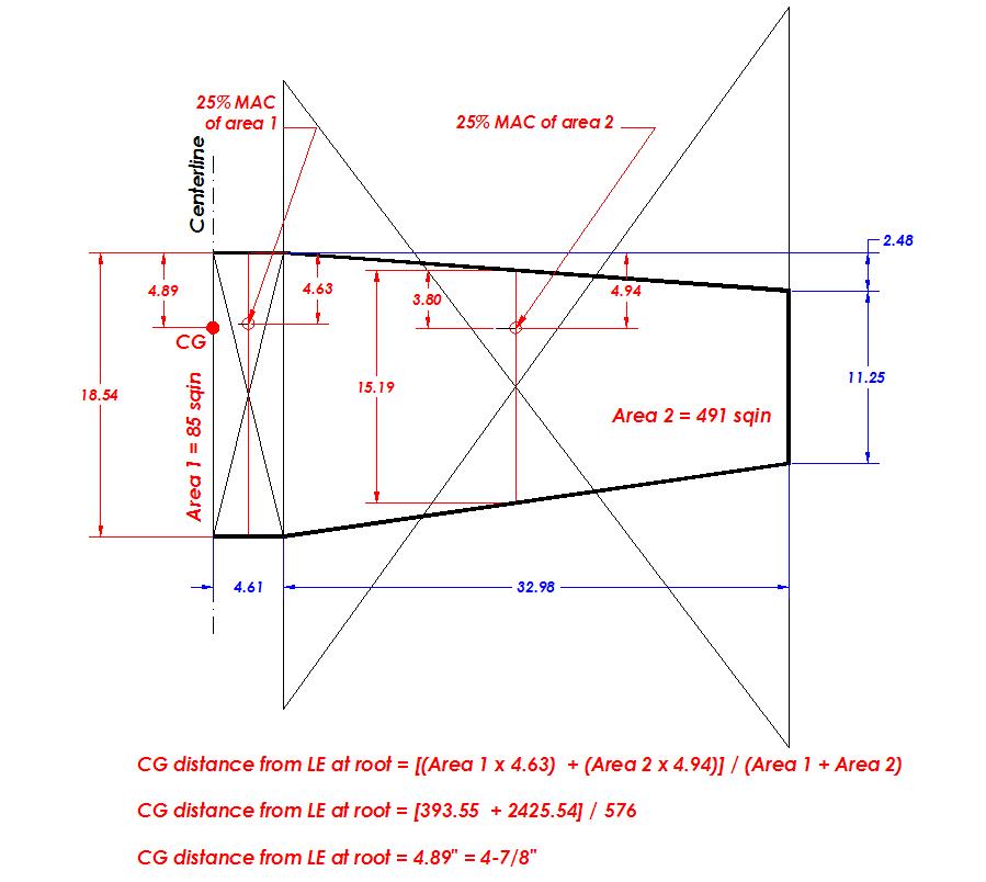

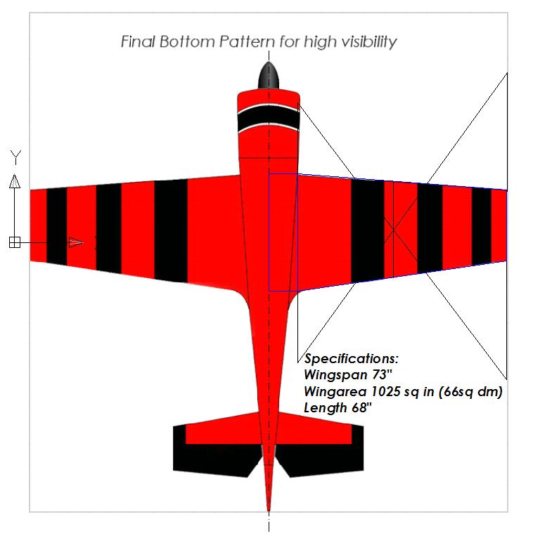

As suggested above, I would verify any radio mix for the throttle first; second, I would make sure about the CG location.
The rig for CG is very precise, but it is useless if the location of the CG is wrong to start with.
Specifications:
Wingspan 73"
Wingarea 1025 sq in (66sq dm)
Length 68"
By looking at the pictures of the manufacturer's website and going back over the dimensions and proportions that we used earlier here, it seems to me that we are still off about the proper CG location.
http://redwingrc.com/planes/mx2.html#mx2_photos

Dave,
Using a picture form the manufacturer's website, I have re-calculated the CG at 25% of MAC.
I did it graphically at scale, resulting in 4-7/8" measured aft from the point where the leading edge of the half-wing intercepts the side of the fuselage.
That is a conservative location and a safe point to start testing a more aft location in little increments (1/8" at a time), until you feel the airplane as responsive as you like it.
Once the elevator becomes twitchy, it is time to return one step back and leave it there.
If you verify that your MX2 balances approximately at 4-7/8", you should find the problem somewhere else (mix or thrust angle).
Another idea, if everything else fails:
Verify that the thrust angle doesn't change when throttle is fed.
That could happen if there is any problem with the structure or engine anchoring.
Again, best luck!
