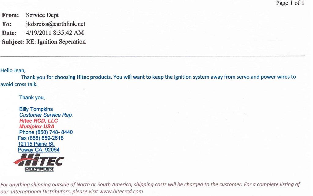

Here is Futaba's advice about the matter.
http://www.futaba-rc.com/faq/faq-gas.html
I'll attach JR's and Hitec's response.
The answer is "Don't do it".
ID:	1636989   Click image for larger version
