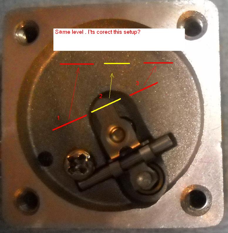

Hello Mr. Michaelchow
carburetor finally goes wrong. I opened the pump and the setting is unlike that of Walbro carburetor. My question is part 2 should be level with the pump body (2 and 3). Look in the photo.
Thank you.
Jimmymugurel
Thank you.
Jimmymugurel

Jimmy, while piston move from TDC to BDC, fuel transferred via this hole, the fuel pressure make the floater up, and pressure on spring, and then <font color="#0066cc">rocker</font> <font color="#0066cc">arm</font> down. when piston move from BDC to TDC, floater down and close, and <font color="#0066cc">rocker</font> <font color="#0066cc">arm</font> up. floater control the fuel transition rate.
So please push <font color="#0066cc">rocker</font> <font color="#0066cc">arm</font>, and see if spring can backspring when your finger leave from <font color="#0066cc">rocker</font> <font color="#0066cc">arm</font>, same level is not neccessary.

Hello Mr. Michaelchow,
I tried today, but can not adjust the carburetor. At idle, gas flows out of the carburetor. And the maximum speed is not getting enough gas. At intermediate speeds is the phenomenon of four strokes.
Finally I ordered a new pump and a carburetor to Himodel.
Thank you for your help.
Jimmymugurel
Jimmymugurel

Hi,
Finally I installed a Walbro carburetor. Now the engine runs very well, although it does not look the same.
Until winter comes, I hope to try it and a model airplane in flight.
Mechanical engine is very good, I very much run at very high temperatures without any problems. The problems seem to not like all carburetors.
