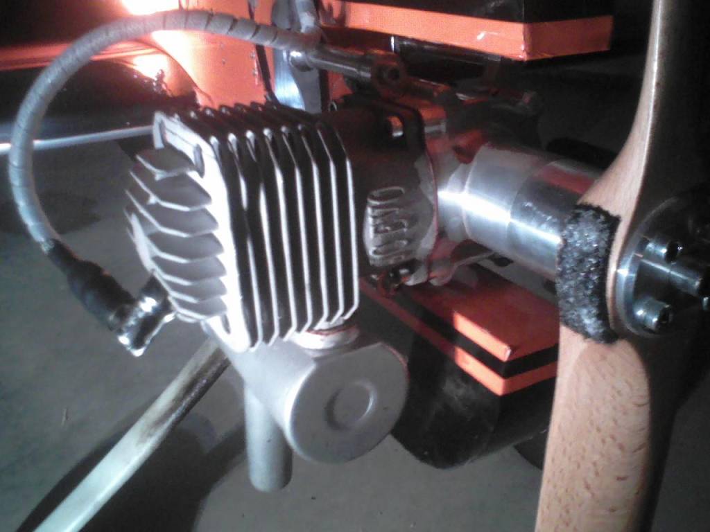

I was absolutely in love with it for about 4 gallons of use and then it started to leak at the base gasket. So in looking at the cylinder I learned that the lining that JC uses in there cylinders is crap. Mind you your cylinder fins are different from what i have.. So I really hope they have addressed the lining issue. I love the design of the engines primarily because it has HUGE ports it was designed to pump a lot of air which translates to HP. Also I love the finish in the case but they had to top it off with a grossly thin lining that wont handle the abuse of ANY excess carbon so here Is my suggestion.. I looked at the pistons out of a da200 that has over 20 gallons of use and They were in pristine Condition from the perfect airplane engine loving oil that redline makes.. Here is a clip that shows proof of it.

Here is a pic taken through the exhaust port at the New Warrantied cylinder in my engine.

I had to have mine warrantied and they did replace the cylinder .. the one in the pic above Check out how they addressed the leak issue I was having.. It was superb

Was not me, If all is right there is no need for sealer on the cylinder gasket.
Can you show us a picture of the top of the cylinder.
Would like to see if it was replaced with one of the old style cylinders.
Milton

i'll have to look at my pic files from last summer for the top of the piston.. He did say it was a new style piston but after I texted him these pics the communication stopped..ORIGINAL: BadAzzMaxx

It is still working however. I looked at the piston last saturday and its still doing pretty good no carbon build up and only wearing on the bottom corners of the skirts.
We looked at it because it started rattling like it needs a crank bearing.

Is that picture after the cylinder was replaced, if so it is still the old style cylinder.
Probably all they had at the time, New cylinders have only been available for the last couple months

no this pic is of the engine new I am sure the cylinder is the same though.ORIGINAL: BadAzzMaxx
