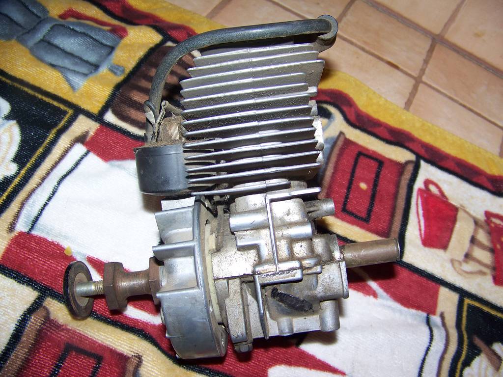

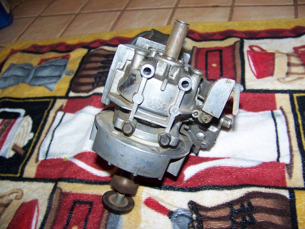

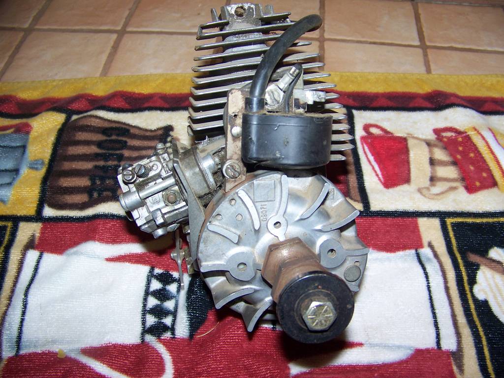

Okay, here are some pictures of the engine

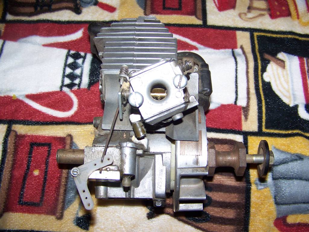

Two more pictures if they help

Sure as heck looks like a Quadra to me?

Duane, did you notice on two bolt holes for the muffler?

It an old style Quadra in the 35cc to 42 cc range.
I understande that the bottom cover of the crankcase is different between the 35cc and the others? But I don't know what thee difference is.

Very early Quadra 35. Had 1 just like it.
