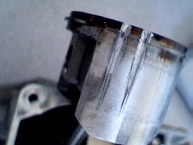

My ZDZ80 siezed in flight on Friday. Dead sticked it with minimal damage to the airframe.
The crankshaft would turn some, but with much friction. Took it home and after removing the cylinder head found the culprit - the C ring (retainer for wrist pin) on one side had come loose and was free in the cyinder!
Never had this happen before with any engine I have had.
Engine had about 20 gallons thru it, and about 18mo since purchase. Was running with 91octane and 50:1 Belray H1R.
Anybody lost a C ring on this engine before ??
Pic of piston attached

An update -
I emailed Amelung Sunday night and received a response today.
Based on the description of the failure and photos attached - he is willing to repair the engine under warranty. That is excellent news! I am impressed when a company stands by its products!
In the email, I disclosed that the cylinder was removed. There was no commentary on that point from them.
The C clip was not loose in the cylinder, but rather, embedded in the cylinder wall. Upon closer examination, it appears that the material forming the outer wall of the retaining groove failed - allowing the clip to depart the piston.

I just had a ZDZ80 piston fail this weekend! Not due to a wrist pin clip though. The piston just lost a piece from the ring to the top including a chunk of the ring. The engine kept running long enough to get lined up with the runway then quit.
Although there is no warranty on mine, only the piston, ring, and cylinder casting were ruined. The pieces just exited the exhaust without getting into the case. I'm gonna repair it and fly it again, but the parts won't be available for several weeks!
