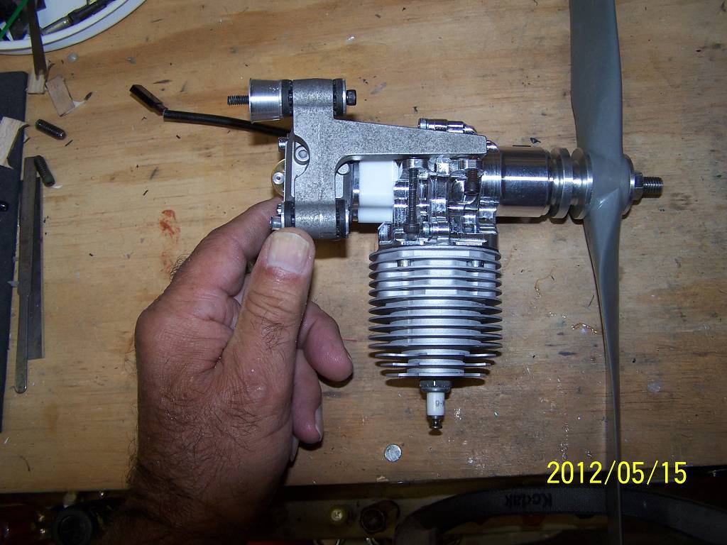

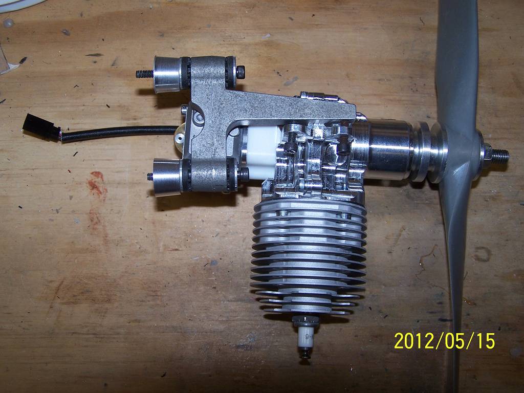

DYou know after reading all the replies...I decided to get going the best I can. Again I am sorry these things happen and that it causes some grumpy-ness.
So I want to post a way I think may work good for another way of mounting the Mintor 22cc gas engine. By using a off the shelf item...by Dubro. I did make some spacers that could go between Carb and fire-wall. Some one asked about making this engine configured for stand-offs like many engine are. This may work too with some rubber inserts to absorb vibration. May test run the engine soon and find out. Capt,n

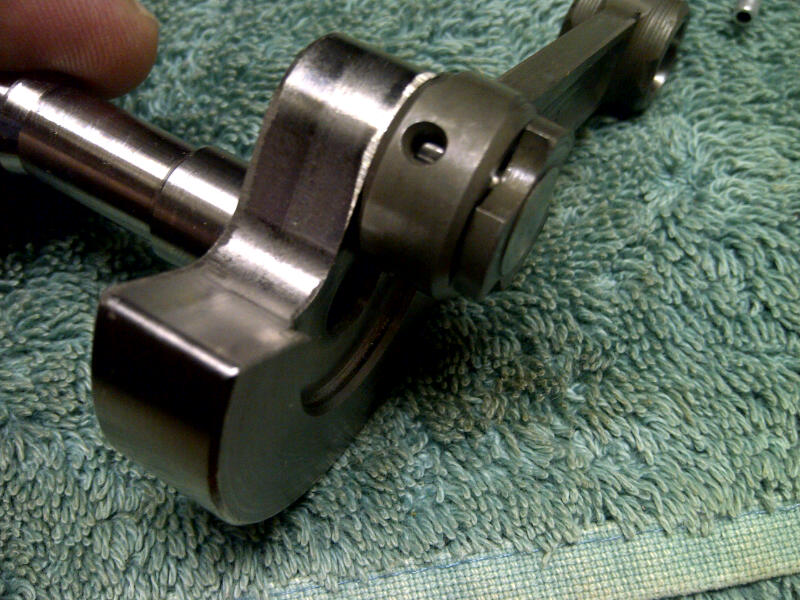

ORIGINAL: Lightspeed1551
Can any one tell me if the 22cc connecting rod has bearings or just brass bushings?
needle bearings, not sure you can see much in this pic but heres one anyway..........
