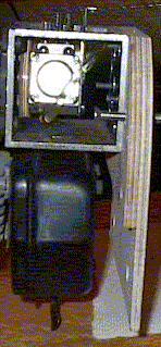

Not sure what you mean,but if you are referring to the carb being buried in the cowl behind the engine and air intake to it,its not a problem IME.
Keep in mind many of our most powerful designed for purpose engines (ex,,,ZDZ,3W,DA) are set up the same way.A "cold" air intake is easy to arrange....if its needed.
I just put a tape on a Ryobi in my shop and it measures 6.5" from the rear of the carb to the front of the prop driver,with a Bisson muffler in place,with the B&B mount adding maybe 1/4" more.. For comparison A 38 cc Quadra 400,(which uses a side mount carb and muffler) in my 1/3 Spacewalker with a bell mount measures exactly the same at 6.5".

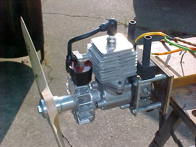

I just recently completed a Ryobi conversion and I would like to share my experience.
I discovered that a simple piece of squared aluminum tubing makes a good engine mount for a Ryobi conversion. The dimensions can be 2.5"x3" or 3"x3" with a 1/8" thickness. Make a template for the mounting screws, transfer that to the mount and use a 2" hole saw to cut an opening for the carb.
I also used aircraft ply to create the carb spacer. After tracing the shape using a carb gasket I cut the spacer using a scroll saw. I then used 30-minute epoxy to seal the wood. To ensure a perfectly level spacer I placed it, when wet with epoxy, between two flat steel surfaces and placed 50 lbs of weight on them. This pressure resulted in a flat glass like finish on the spacer.
The only things I had to pay for were the prop hub and additional gaskets. I balanced the flywheel but I did not machine the fines. The stock muffler does cause some back pressure but it does allow you to pass any noise testing.
I hope this helps.
Norman

Here's a shot showing how I made my mounts and the homemade muffler. I'm getting 7100rpm now on a Zinger Pro 18x6. Here's a tip, if your motor starts going rich when you fully open the throttle (4 cycling), clean your spark plug! Mine started doing this with only about a gallon of fuel run through it on the test stand. Cleaned the plug and regapped to .018 and it's running like a champ now. The homemade muffler gave me a little over 500rpm increase.
