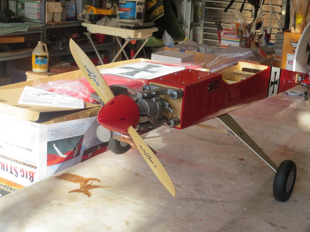

I am installing an RCG 20cc gas engine into a new model, and I need to know what the prop shaft dia. and thread size is. I need to know, so I can order a spinner adapter for my new model.
The instructions state to use 25~40/1 oil mixture. From what I read...it looks like I'll be using 25 to 1 ratio for my oil/gas mixture. I've been told to use outboard moter two cycle oil...any suggestions ?
I would like to replace the carb on this engine...any suggestions ?
What replacement spark plug should I use ?
This is my first gas model, all my other models have been glow fueled. I built a 60~90 size Big Stick and mounted a RCG 20cc engine to the nose.
Thanks for the help,
Soft Landings Always,
Bobby of Maui

Just curious, what's the thought behind replacing the carb?
NGK CM-6 is the plug most are using, gapped at .024 for more consistent mid range. Available at auto supply for 4.00 or less. Some outfits are raping buyers....
Nice idea on the exhaust!
To the best of my knowledge the RCG 20 is supplied with a Walbro carb which is just about the best there is for our small engines. This model and engine combination is very good first choice for a gasser and should provide you with lots of enjoyment so enjoy.

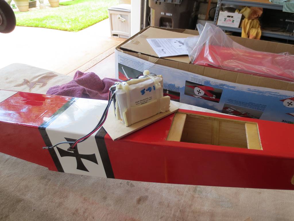

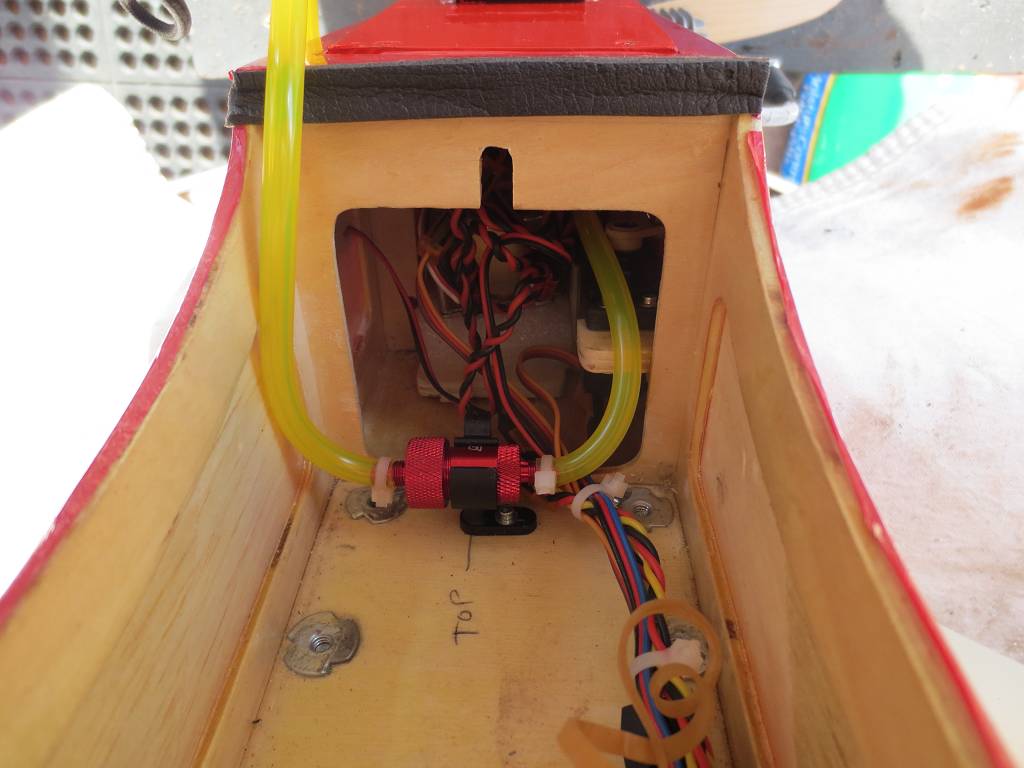

I ended up going with a 500cc fuel tank, installed over the CG. The throttle servo is up forward in the forward bay, with the electroic unit for ignition, and both batteries will be set way aft in the tail, for balance (I'll make a hatch aft for this-and still to do).

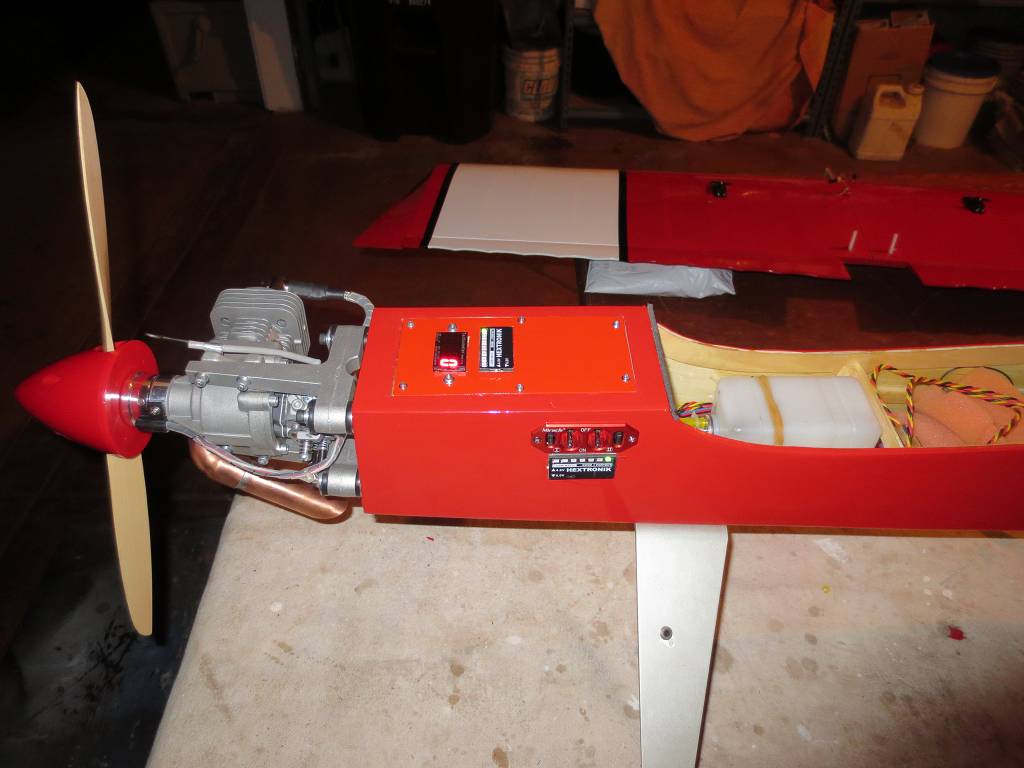

Hi Guys,

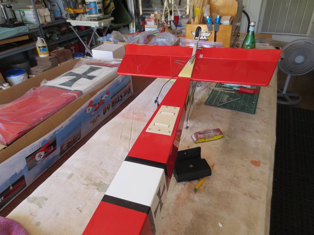

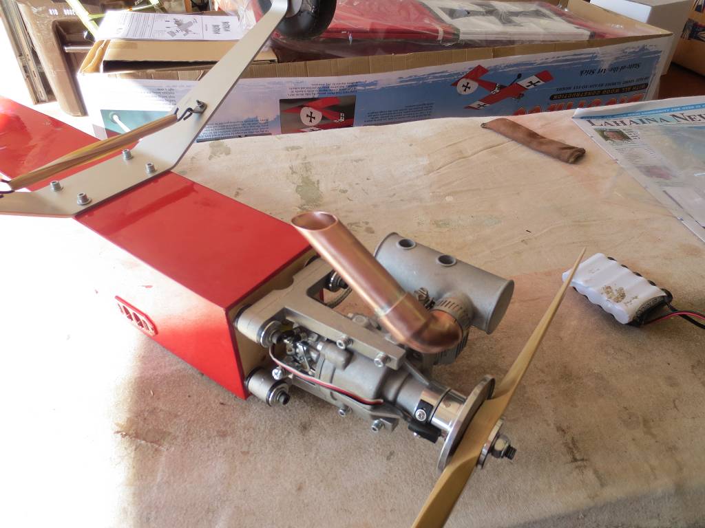

I finished my new model and found out that an 8mm x 1.0 does not fit a RCG 20...the thread is to fine, so I ordered a 8mm x 1.25 nut and adapter for my model. The model came out to 9 lbs. even, with two 2000 ma. batteries mounted aft near the tail, on the bottom of the model. The balance came out spot on and no lead was added to balance the model...the two aft mounted batteries did the trick. I'm going to use a 15 x 6 prop on the model and I ordered 5" DuBro ballon airfilled tires for more prop to ground clearence-and yet to receivce from Tower Hobbies. The carb on my model is a Walbro and I am going to use Royal Purple 2 cycel oil for my 25/1 oil fuel mix.

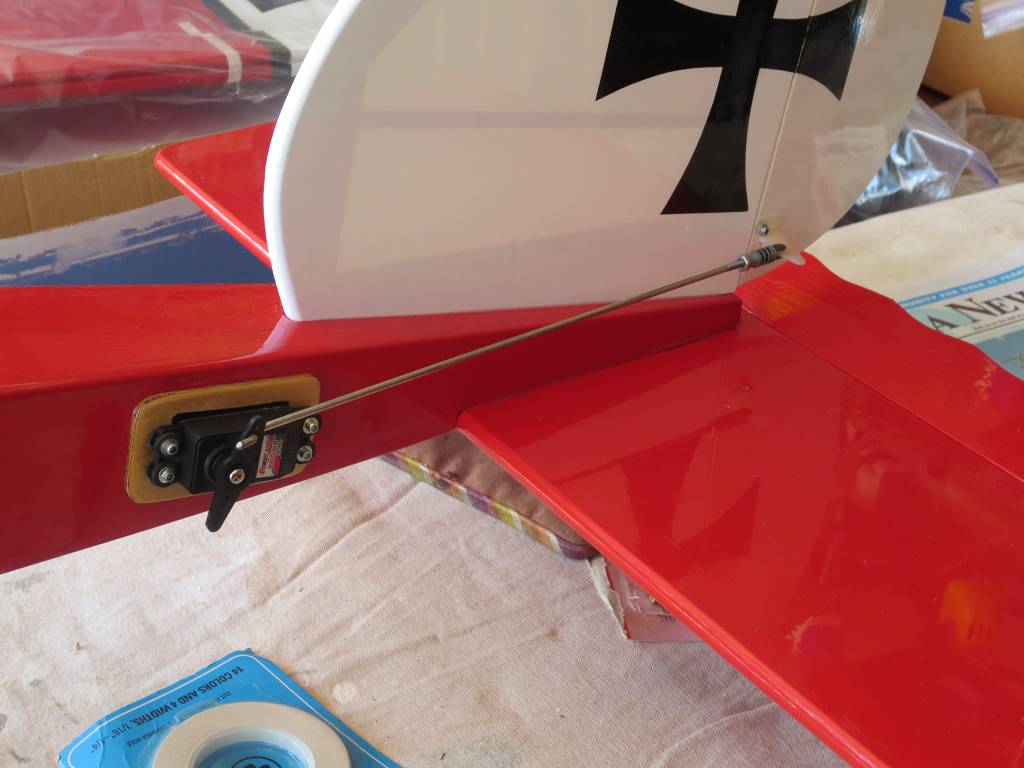

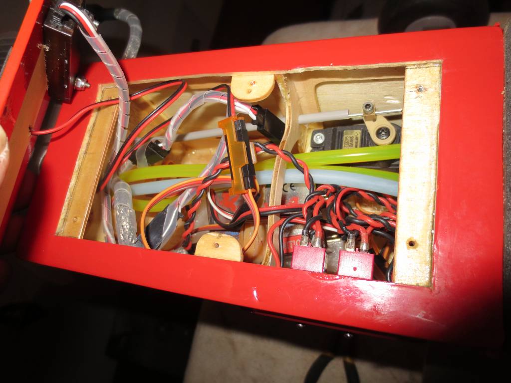

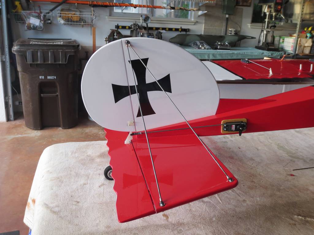

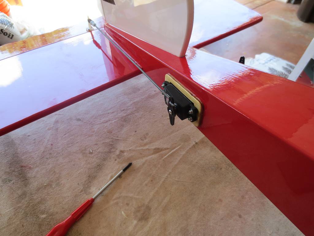

I mounted my servo's aft and installed a solid tail wheel assembly for the model.
I ended up with four "Y" connectors in my model...I wish someone made short "Y" connectors, like the ones that cme with my DLE RPM sensor. All my servo connetors, as well as inline connections, have safety clips installed.

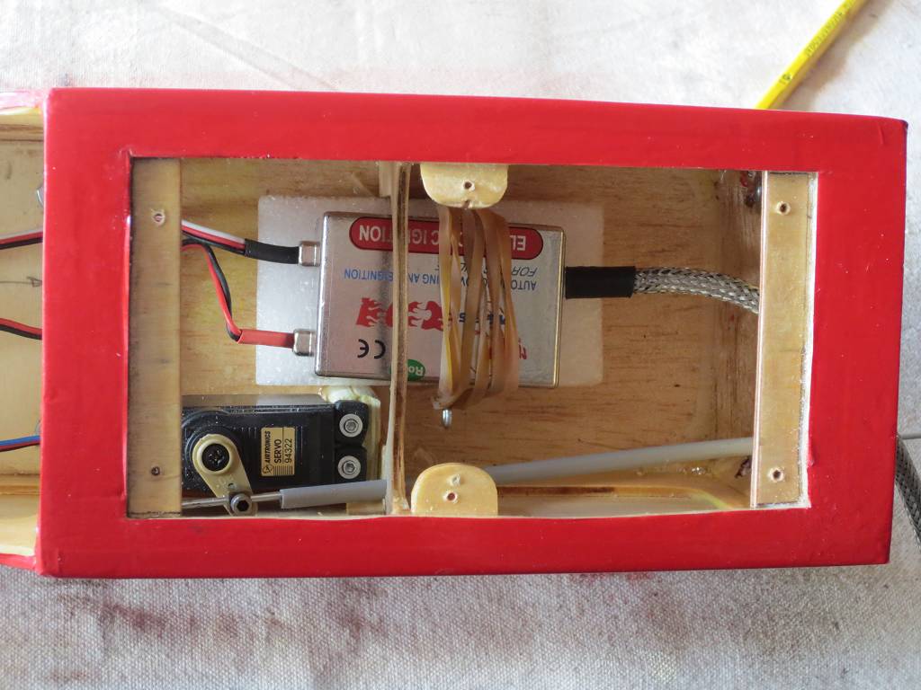

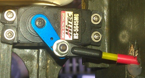

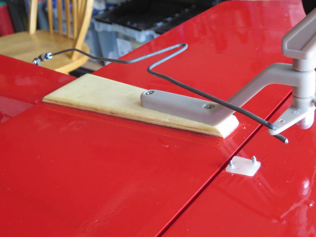

I used metal control rods to connect the engine to the servo (I used a Airtronics 94322 servo) to contrl the engine. I also used a metal control rod to connect a choke rod to the engine for start up...any proplems with this set up ? I'm using a Airtronics 2.4 10G system.
It was my first Gas model build and was surprised at all the goodies that go into a gas model. This model is almost to small to install all the requirements needed to support a gas engine...but feel it should do the deed just fine.
Thanks for all your support,
Bobby of Maui

If you are going to run a 15 6 prop then you will miss all the fun you can have with this engine, it will rev its t*ts off and give poor performance, 17 6 and it will drag that plane about like you would not believe.
Hey Bob, looking at your 3rd and 4th pics it looks like you are using a metal rod for the throttle servo.
Do those rods screw into a plastic connecting rod inside that sleeve or is it metal all the way through?

Good catch 3136. That is a definite no-no. Just those two point's being metal, throttle arm to metal control arm, will cause RF. And wear really quick from vibration also.
Hey Bob, the dubro ball links are great, I also put a washer between the nut and link for extra safety.
Use a nylon pushrod in a sleeve and that will give you extra protection from the dreaded rf.

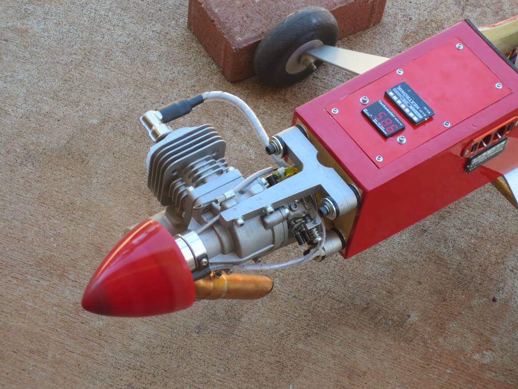

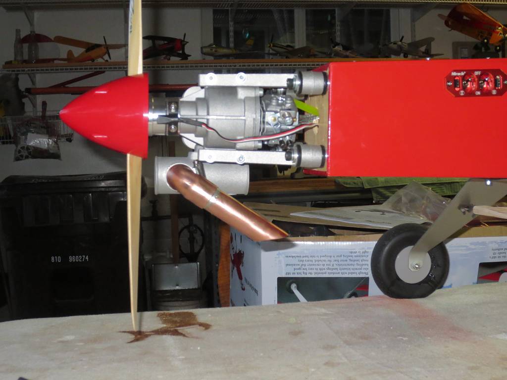

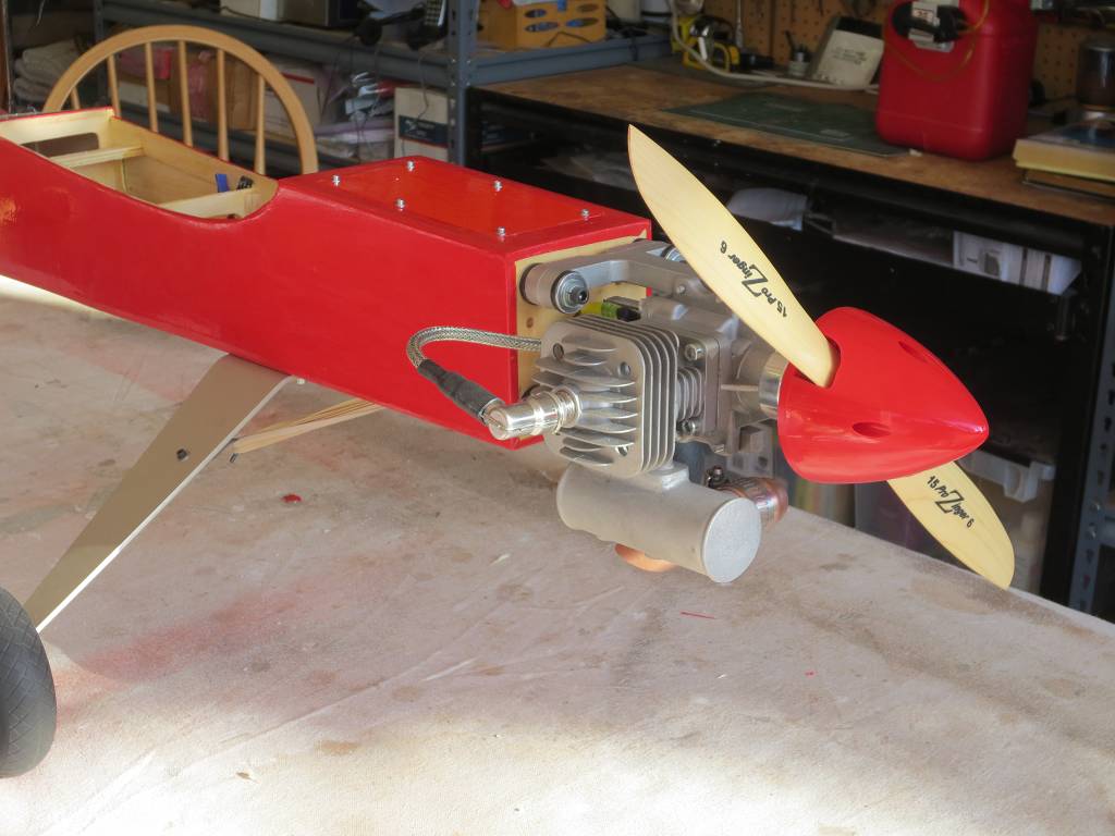

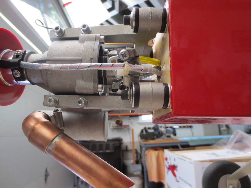

I do not no if your ignitions is all set the way the pictures show?
But your spark plug cap is not all the way down on the CM 6 spark plug.When the cap is on all the way It should cover the hex of the spark plug.Push hard with the heel of your hand,They go on hard and come off harder.

God Bless...thank you for all your advice. I will need to change out my choke pull and engine servo connection to the engine. I will hook up DuBro ball links like 3136 advised. My control rod for the engine and choke is metal...all the way through. I was led to believe that 2.4 radio's are not effected with RF nose from metal to metal contact. I stand corrected and will make the changes stated.
I will double check my spark plug connection to make sure its seats properly.
I will need to by 5" DuBro balloon tires and go with a smaller tail wheel. My prop to ground clearence with a 17" prop would almost hit the ground with my current set up...bummer. Ok...changes coming.
By the way, up front next to the RPM indicator is a voltage check...when the lights on...mags are hot and this is connected to the ignition battery. The voltage check, below the radio switch, is for the receiver.

I took your advise and placed ball links into my choke and throttle linkage. I did have a bag of 2/56 ball links, and hardware, so got busy and changed them. Next I ordered 5" DuBro balloon tires, and a .60/90 size tail wheel assembly, and will remove my 120 size I now have installed. I have only 2" of prop clearence with the model sitting on its tail...and 1" with the tail in the level placement. No where near enough clearence and the new tail wheel assenbly and larger tires should allow 17" props with no clearence problems.

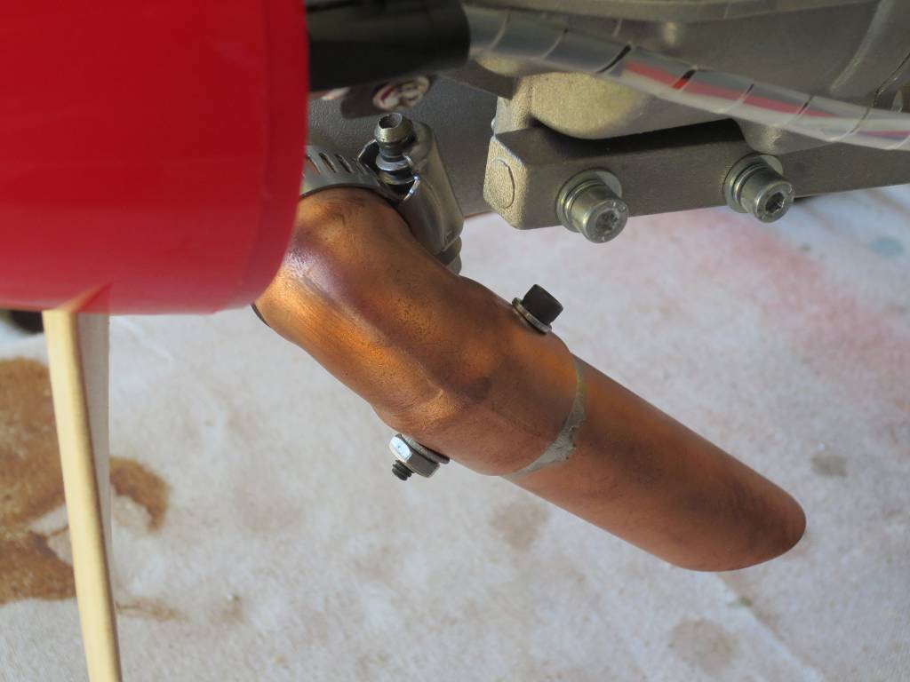

Hey Bob, 2 cycle gas engines are not like glow, just set it a little rich and fly it, otherwise you may overheat it and ruin it.
The gas engines run a lot hotter and the centre of the prop will not cool it enough, it needs air flow.
The rpm needs to be multiplied by 10 so it looks like you are revving it too hard and need a bigger prop.
I have tried anti vibration mounts and found that they make it actually worse, but I have not used the one you have.
When you run the engine on the ground for tweaking, make sure you have the wings on, as they dampen it a little.
Have fun

Bob,
I am building this very same Stick for a friend, however, we are installing the 15cc RCGF. I have found the 15cc RCGF engineon 15x7 propto be more than sufficient for my H9 Ultra Stick 60 providing unlimited vertical performance, hence, we are using the same set up. Your Stick with the 20cc will be an absolute blast once you get past the prop clearance issues.
Can you provide details on the hardware you use to connect the vertical fin to the horizontal stab? What length and size push rods are you using and what type of ends and fastners?

I used plain old 4/40 wire rods (cut from 36" long rods-12" 4/40 rods are not long enough), for the tail brace wires. I went to Radio Shack and bought pre-tinned connectors, the one with no plastic covering-with the screw hole in the middle-w/a wire connetion tab. I fit the wire into the slot/tab and just silver soldered the wire to them. I made the top rudder connector first-screwed into place, for flight, then moved the wire to where I wonted to place the outboard stab connection, and cut the wire. Then I marked how the tab was to be set on the wire...then just soldered the tab to the wire-after removing it from the model. You will need to bend the tabs a bit to fit the angles of the wires to the stab, from the rudder...but Its really quite simple to do...and make sure you have the proper screws and hardware on hand for the five attachment points. I've done this on my models for years and it works. It gives you something to hold on to and also beefs up the tail feathers a bit. I used 4/40 cap head screws, washers, lock washers and fiber lock nuts...double saftied. I have a good collection of hardware on hand...so I just go to the cap head screw length that works best and attach the goodies. 3/4" long cap head screw for the top of the rudder and 1/2" for the stab connections. #2 washers, lock washers and 4/40 fiber lock nuts.
