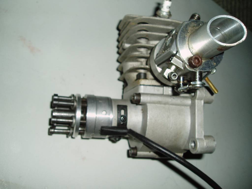

Here is my set up for a Rcexl ignition. Have to be really careful when drilling the holes for the pickup. I've been pleased with the set up.
I have switched the HDA 6a carb for a WT540. If I ever get around to it I would like to try the Bully TN carb and the Bully Dynamix carb.

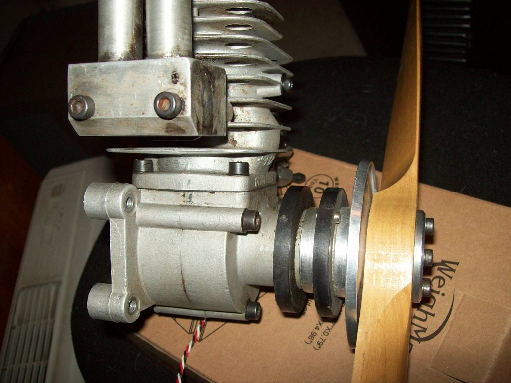

After comparing your photo to my engine, mine looks more like yours then Speedy's; I don't have ribs on the prop shaft portion of the case either. I'm assuming they were milled off by CH, but if so they did a great job as it looks as though they were never there. How did you do your pickup? Just drill a small hole and epoxy in the magnet? Did you need any additional parts, like a collar for the prop shaft, or just drill into the existing part?

I prefer always to spin out a collar on my lathe. Slip it over prop hub and I use a small set screw to hold timing. Too re-set the timing its then easy....just rotate the collor.Get a small magnet at Radio shack. Capt,n

Hey Captn, good to see you again. Unfortunately I dont have a lathe. I was thinking perhaps I could just use the 'rings' from the old ch unit but Im not sure the magnets would be correct. Any thoughts? Just ordered another carb from Speedy, great guy by the way. Im on the fence, still, again, as usual, (take your pick!) about swapping out the old ch which is functional, but apparently not great from what I am hearing. The only hang up is the plug type, 3/4 14mm (odd mix match of verbage there) with the BPMR6A plug thats in it, and the pickup situation. Hobby King sells a unit that would work, basically their version of the Rcexel, of which I have one that works great on a G20, but I am not sure if their 14mm boot would fit my plug, could be 5/8, could be 3/4??? And it still leaves me with engineering a pickup magnet. Do you know if the Rcexel units come with the hull sensor at all? Im figuring its would all have to be bought separately correct? Getting closer though to getting this 'great deal' of a motor going (kind of a 'stone soup' situation its turned out to be).

To go with the Rcexl I will need to pull the old CH sensor and pick up 'rings', Speedy mentioned a puller, any advice on how to get the front end apart, or should I just cut them off?
