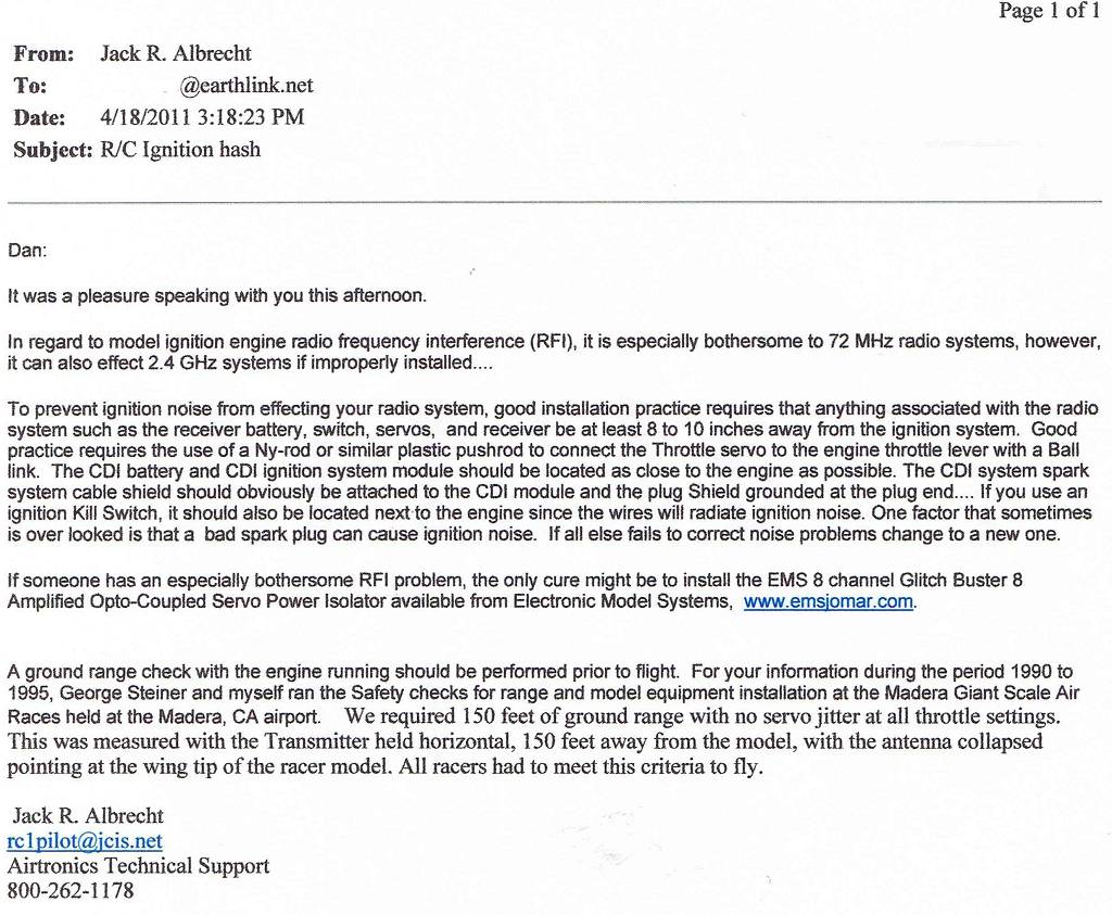

bohiaa, here's what a few of the RC manufacturers have to say about the subject. First Futaba:
Guidelines for setting up gasoline engine models.
All ignition equipment, including an electronic kill switch, must be mounted at least 12", and preferably 14", away from all radio equipment, including throttle servos, etc. Ignition kill switch should always be on opposite side of fuselage from radio kill switch. All pushrods going to anything related to the engine must be non-conductive (just nonmetal clevises is not sufficient).
You're always better off listening to the manufacturer than someone on RCU. dan

Answer me this: What frequency does an ignition module with a cracked case or frayed plug wire put out? personally I have no clue and I think it would take a Sectrum Analizer or Network Analizer along with a problematic ignition to find out. That being said, why risk your airplane because you feel the need to dis-prove well documented methods?

Speed, you have to assume that the ignition system, which includes the spark plug, has the capability to generate any frequency from DC to light and you better protect youself from it. It may not be at the frequency that you are transmitting on all the time but all you need is a few seconds of it and you're in. So, assume it's there and follow all your manufacturer's guidelines which are just good RF principles. They know best since they designed the RC system. Dan.

No. It's not necessary. Like seat belts. Fire extinguishers. Condoms. Designated drivers or liability insurance.
But if circumatances are such that it causes a problem your hindsight won't rebuild a crashed plane. I follow the 12" and no metal-to-metal rule and have never lost a model to a "glitch", "hit, "brown out" or other excuse pilots use.
It's pretty cheap insurance. Usually (I fly mostly magneto) I need to get weight closer to the tail; so a remote throttle servo is an advantage.
