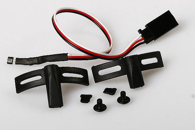

Hi
regardind this sensor
i see many sensors like this at ebay they look the same but i see one for each DLE 20-30-55-111 and so on
my question is what to buy for my DLE55?
they look the same but the prices are different.
thank you

They are all the same RCEXL sensor

All the sensors are the same, You just have to make sure you use the right sensor bracket.
There are long and short brackets like in the first picture.
The best is to use the universal if you do not know which one will work for you, They will work with most any engine using RCexl ignitions and some that do not use RCexl ignitions. It is the second picture.
Milton

is it possible that this sensor will go bad over thetime (sort time)?
ilan

If you let the spark plug cap come loose, the spark will happen in the sensor and quickly ruin it.

Yes it is possible, I have seen a few that would fire the ignition as the magnet went under the sensor and again as it past the sensor.
Have also seen one that when the magnet went under the sensor the ignition fired contentiously.
Tell us what problem you are having and maybe we can answer you better.
Milton
