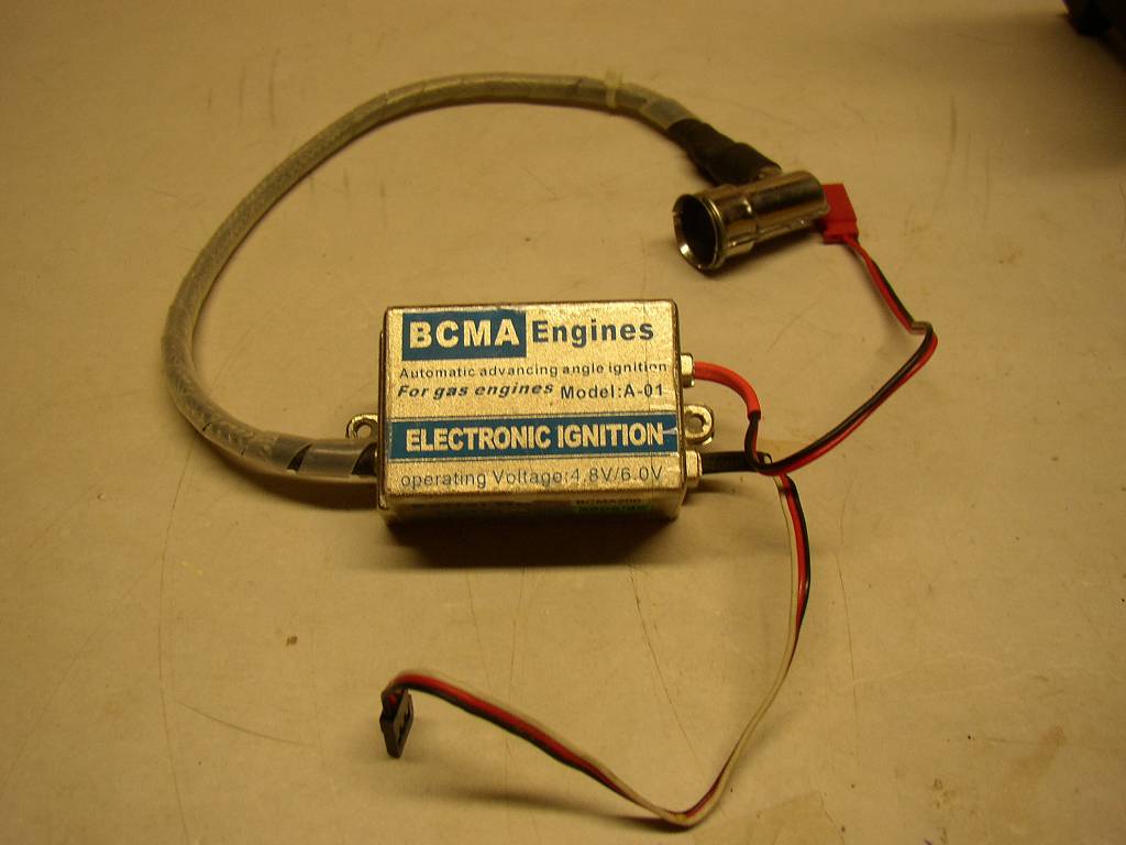

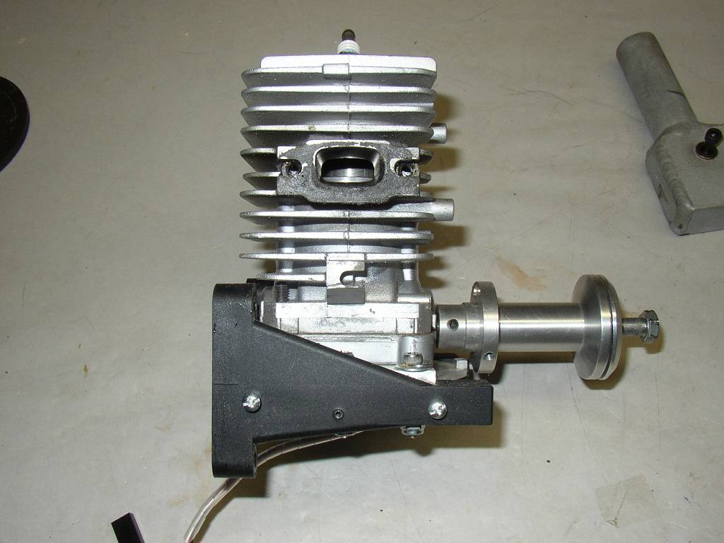

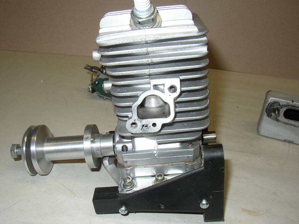

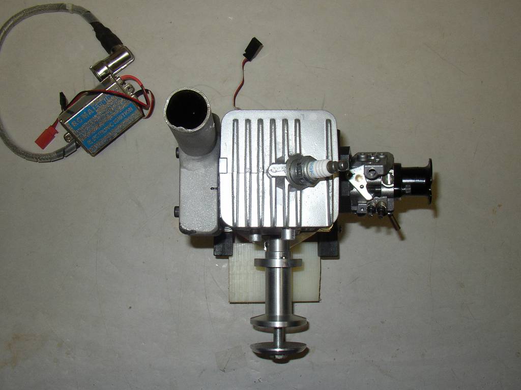

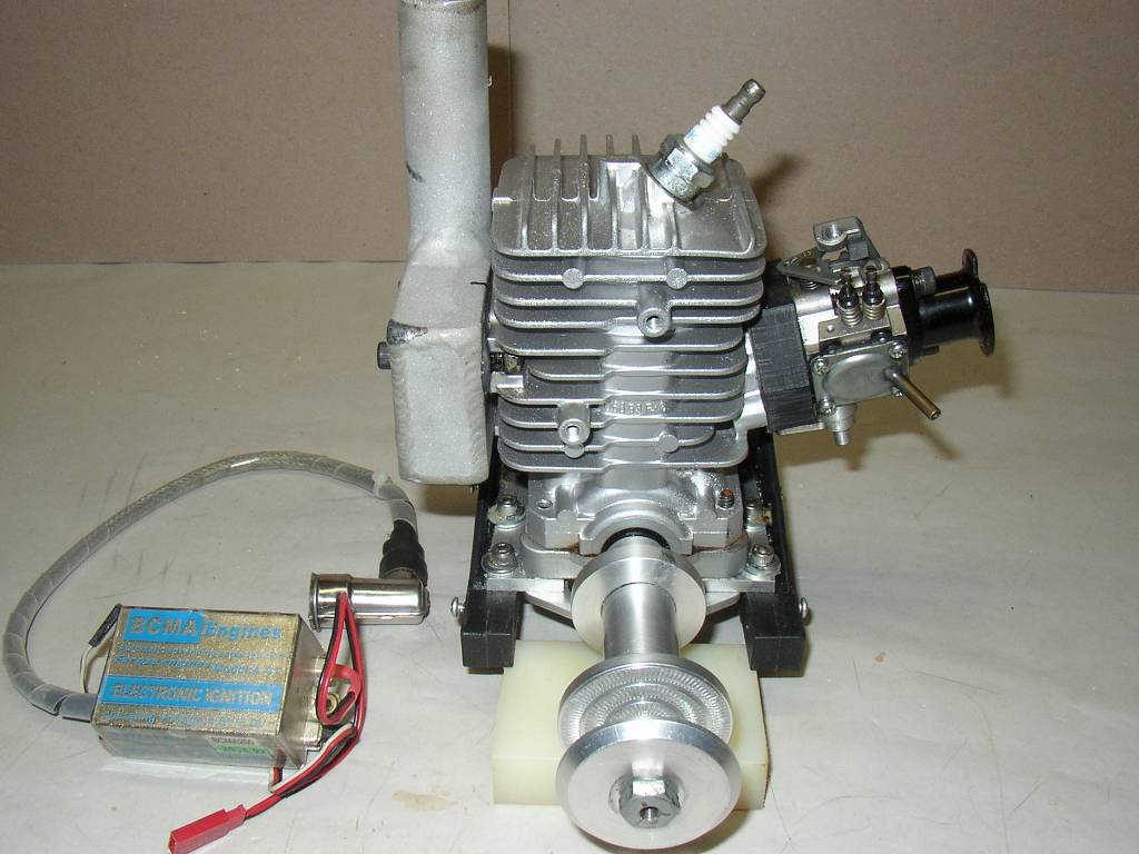

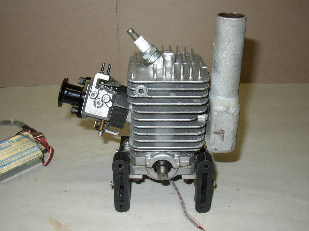

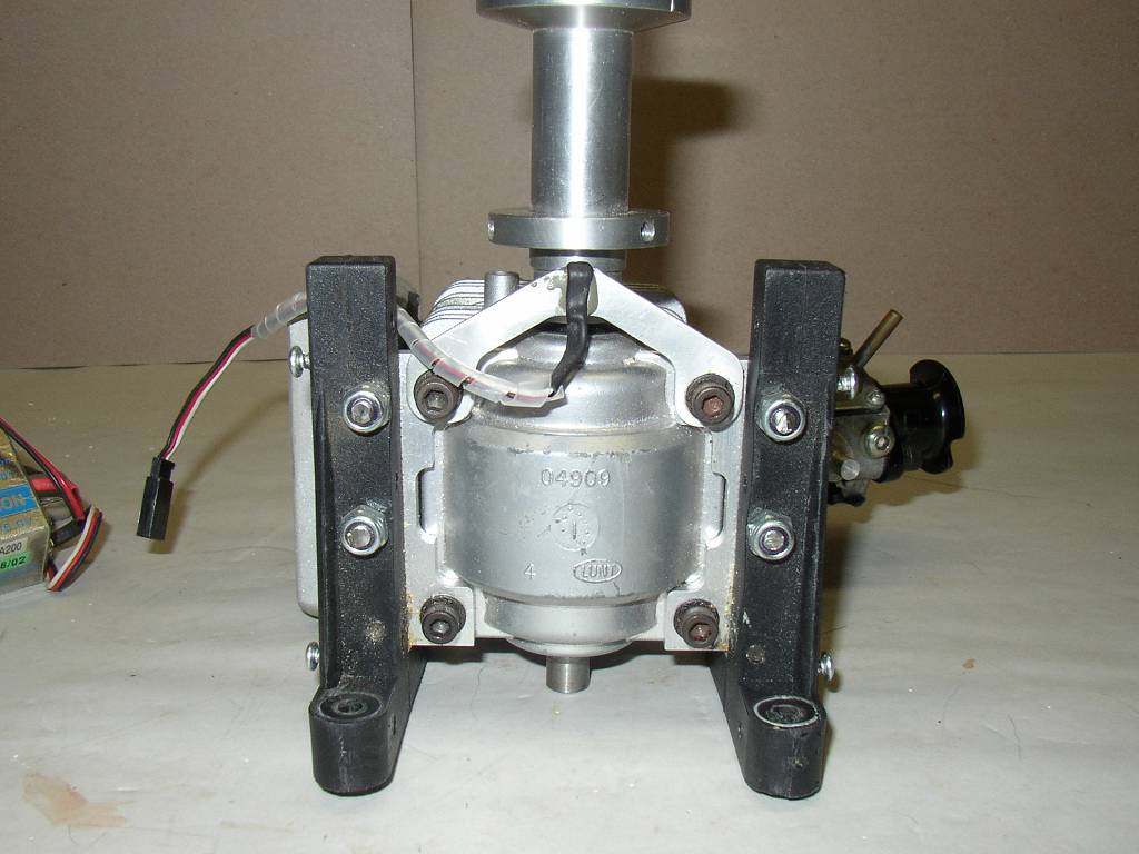

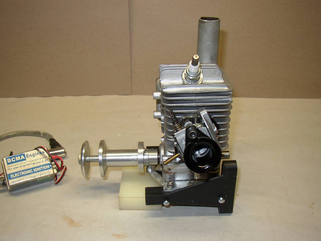

I have a BCMA 40 or 44, I don't know which. Can anyone tell me how to tell. Plus where I can find info, or a manual on the engine.
I search and I can only find old threads on it, which don't answer my questions, and the web site everyone use to use, seems to be down

The BCMA is a re-branded SPE and also the same as a MT40
If I remember right SPE is now MLD
Any two stroke gas engine out of China will have about the same manual,

It looks like a 42cc poulan

Sure does, I never looked at the pictures before posting, Just has a RCexl ignition with a BCMA label.
The BCMA were rear mounted.

I am thinking the only thing that is from BCMA is the ignition.

Hey if it runs good...run it like you stold it. I am sure it is a Poulan. Capt,n

After your suggestion of it being a Poulan 42, I searched it, and it is a Poulan 42.
I will now find a plan to a plane that I can build for it. I have no idea what yet!

it actualy looks like one of my mufflers

I'm not sure it is a Poulan 42cc. The Poulan 42cc had the ignition coil mounted in the chain saw; not on the engine. Looks like this engine has mounts for a coil on the cylinder. It might be a Poulan 46cc.

Is it a simple piston port or is there a reed block in there?

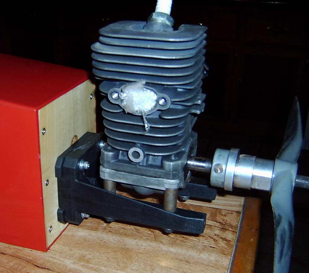

It is piston ported. Here's a pic of a 42cc.

thats the old style 42 they changed them for the EPA on the newer models. The 46cc has an oval carb adapter that slides on, but at this point it could be anything they all been sold and bought by so many companys.

It looks like you have yours on a stik. That is what I was thinking of building for mine. What inch wing do you have? What inch wing would you sudjest to use?
I'm going to scratch build mine so any size is ok. I'm thinking maybe a 70-80" wing. I have the plans for the 101" Bud Nosen big stik, that I could shrink down, or I also have the the plans for a 50" sweet &amp; low, that I could blow up. but I think I'd rather have a shoulder wing.
