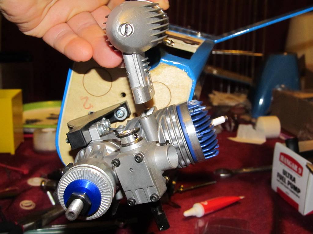

I'm currently installing the 10GX in a Hanger 9 Toledo Special. Only hangup so far is that even with the 13mm extension the muffler is just to long and won't allow mounting to the engine. I'd order the Bison Pitts muffler but have no idea how big it is. Anyone used this muffler for this aircraft or have some pictures from various angles mounted to a 10GX so I can get some idea if it would possibly work before I shell out for the muffler. Thanks.

Joined: Sep 2005
Posts: 16
From: Spartanburg, SC
Default RE: New Evolution 10cc gas engine
ORIGINAL: GBR2
I am building the same set up and I have run into that same problem. I'm thinking of getting a macs muffler and 8mm extension to fix the issue.
