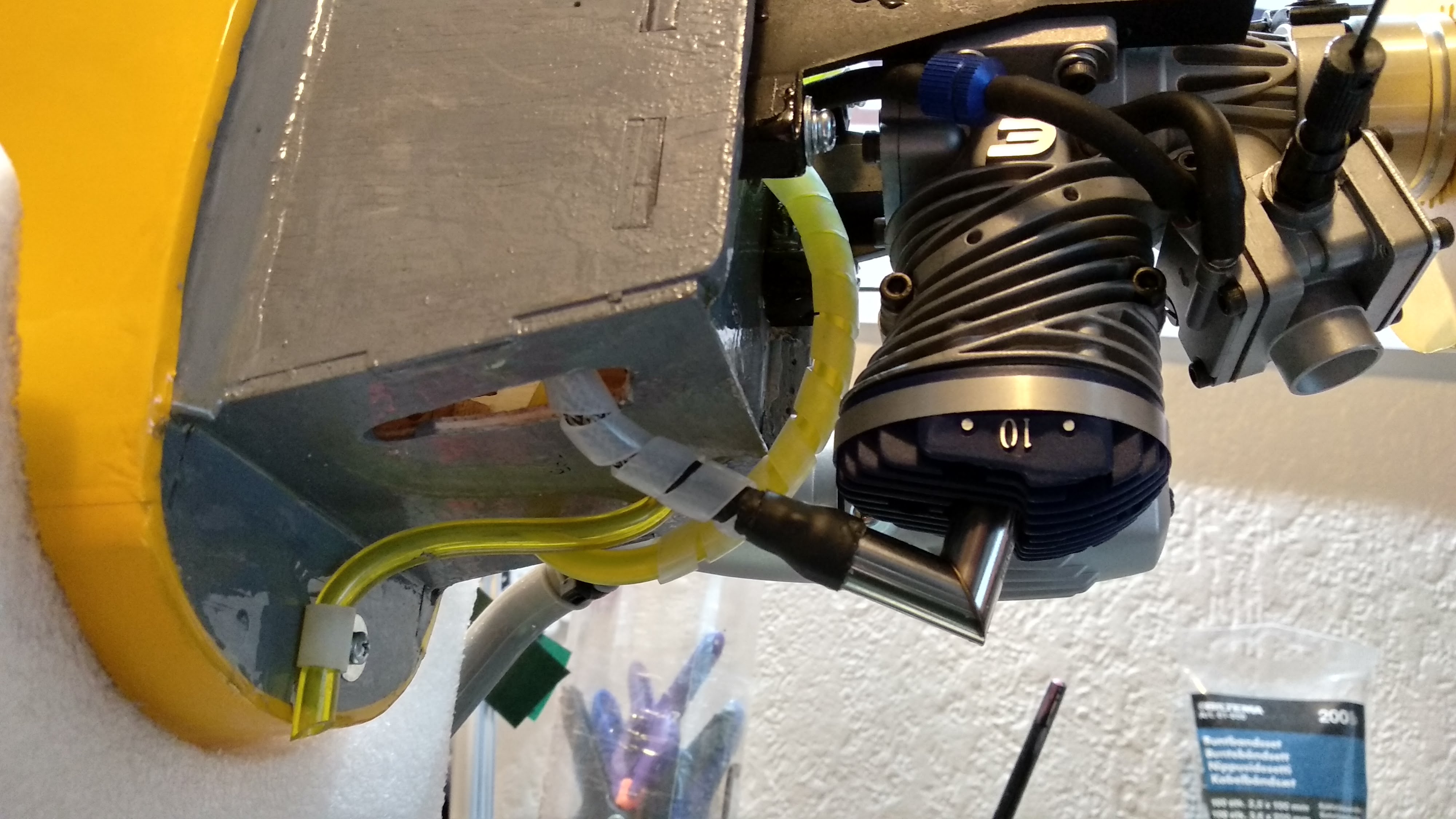

My simple comparison of the Stock muffler against the OS muffler with regards to sound? The 10cc in this video with the OS mufflers is running on its first tank and is running really nice on a APC 10x6 run-in prop at max RPM at almost 13k... amazing for a brand new engine... very easy to tune and very reliable..

Default Very nice
engine sounds good with ether e
muffler. The OS one sounds a little deeper,

Would have been nice if both mufflers had been tried in otherwise identical scenarios. With one run on a test stand, and the other installed on a plane, My impression is that the plane added/changed some harmonics.

Yep... as Al says, the differing mountings can resonate differently.

Yes I agree, it definately changes the harmonics, will make a new video once I have them both in a plane and at the field...that changes the sound quite alot... just gotta wait for the all the snow to melt first
