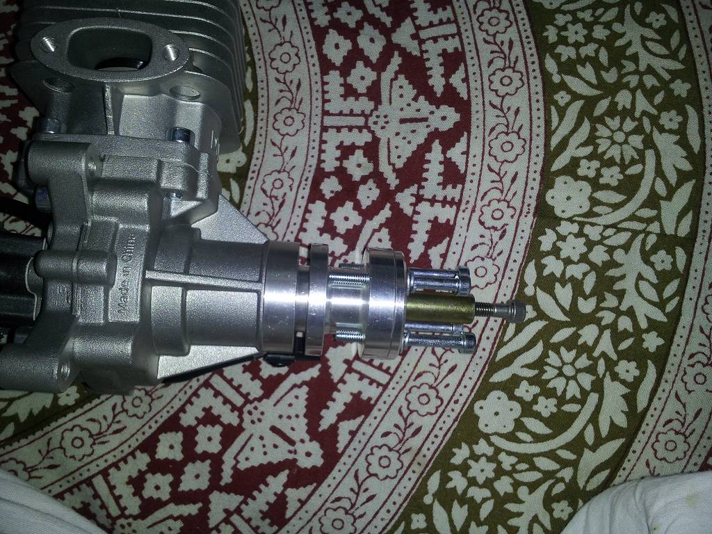

Hi,
I am preparing equipment for my next build which will be a 30cc with a dle. I and trying to figure out how a 3" spinner fits onto the dle 30 considering there is no centre bold for the adapter. I will be ordering the spinner (3" Truturn wideblade from Tower) soon and want to order the adapter along with. Can someone explain this to me
Ameyam
Ameyam

No, this will be a new standard spinner, I just need to know how to install it.
As I understand, the centre bolt / shaft in the dle 30 is only there for centering and alignment? I would use a drill jig to drill out the prop hub and the spinner backplate, then install the backplate and prop between the washer and the main engine hub and secure these in place with 4x4mm hex bolts that screw into the hub. Then get a suitably long 5mm hex bolt and screw that through the spinner cone into the hole in the crank. Is that correct?
Ameyam
Ameyam
You do not need an adapter. The shaft that the prop slides onto is threaded down the center. You just use the appropriate bolt through the center of the spinner, threading into the center of the stud. Very easy. When ordering your spinner from Tru turn, ask for the appropriate bolt.

I figured that out, but the specified spinner come with a 10-32 bolt whereas the DLE30 required 5mm bolt. I can take a 5mm bolt locally provided the head sits flush with that socket in the spinner cone. If I am not mistaken, 10-32 is smaller, my concern is that the head will project out of the cone

well, I am getting the 4bolt jig for the dle anyway. If fitted with a spring washer under the head, the bolts will never come off
With regards to the spinner bolt, TT told me that they supply a 10-32 with their spinners & I dont need tht 5mm bolt for mounting the spinner. I doubt that but I will do a test fit and see. Else, I will simply take a standard 5mm bolt and turn the head a bit smaller on a lathe to make it fit in the spinner cone recess
Ameyam
Ameyam
OK, the real issue is the center hole in the backplate. The center hole in TT backplates is 3/8th". The DLE uses a 10mm diameter crankshaft extension, which requires reaming the center hole to fit the larger crankshaft extension. This is not something you want to try doing with a drill press at home. The hole must be perfectly centered or you're in real trouble. TT provides a backplate modification service, they will properly ream the center hole and drill the 4 bolt holes for a fee of $9.50
Now, to the issue of the 10-32 spinner bolt and the M5 threads in the crankshaft extension. Last night I didn't realize you could use the 10-32 TT spinner bolt in an M5 thread. A bit of a loose fit, but perfectly acceptable for this application, as the torque used on the spinner bolt is quite low.
So, there's two ways to mount the TT spinners on the DLE 30. Have the backplate modification done, or as I suggested, go to the single bolt adapter, then just order the correct hardware package from TT. That gives you the correct prop nuts with the 10-32 thread in the tip, and a press in 8mm bushing to properly center the backplate on the 8mm prop shaft.
Both ways will work fine. My personal choice would be to go the single bolt route, that way the stock spinner backplate can be used on other engines simply by changing the press in bushing to fit the prop bolt on any other engine with a standard prop shaft.

And the spinner centre hole needs to be widened. I dont see any reason why that cant be done with a bench press or even a hand held drill. Since there is already a hole there, the widened hole will have the same centre as long as the initial center is adjusted properly
Ameyam
Ameyam
No, a drill bit will tend to walk or go off center. With the spinner turning at 10K RPM, there's little tolerance for error.
I realize you're at a disadvantage shipping wise being in India, but if you haven't as yet ordered the spinner from Tower, you could order the spinner directly from Tru-Turn with the backplate modification already done. Another option would be to take the backplate to a local machine shop and have them enlarge the hole and even drill the 4 bolt holes for you using the DLE drill guide.
