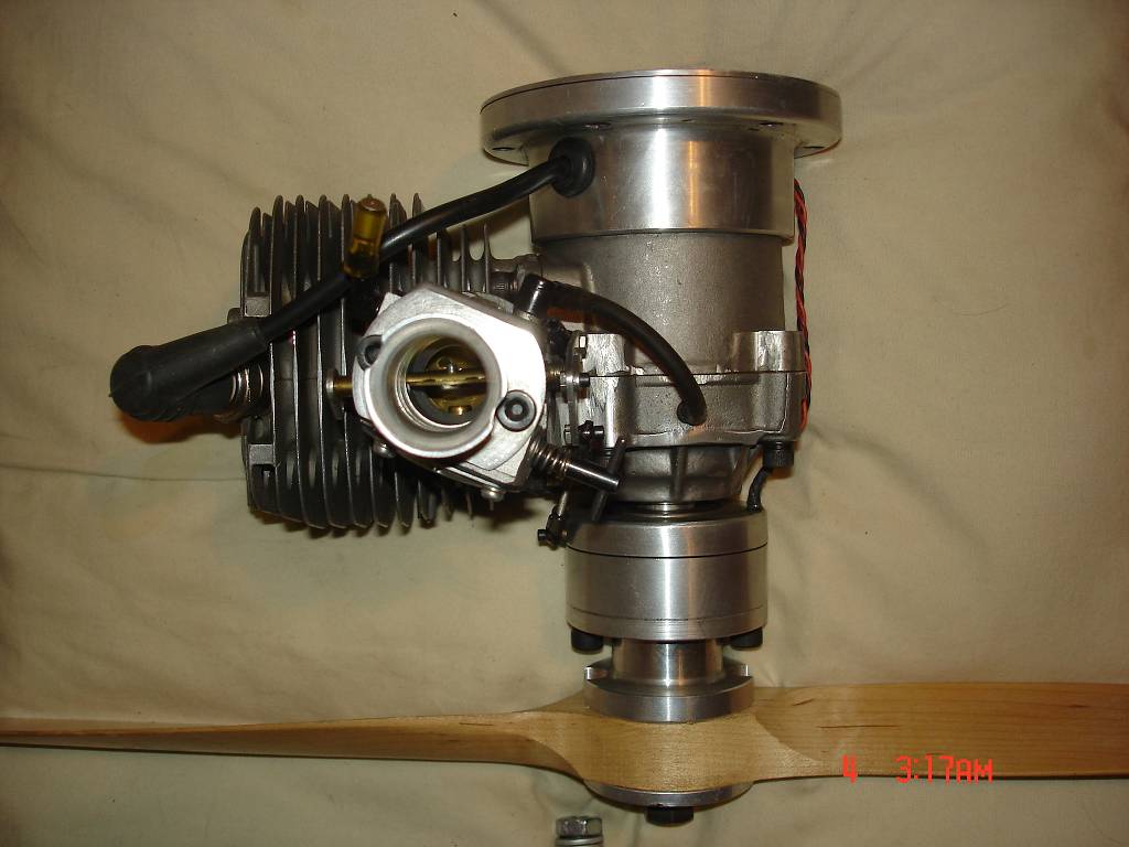

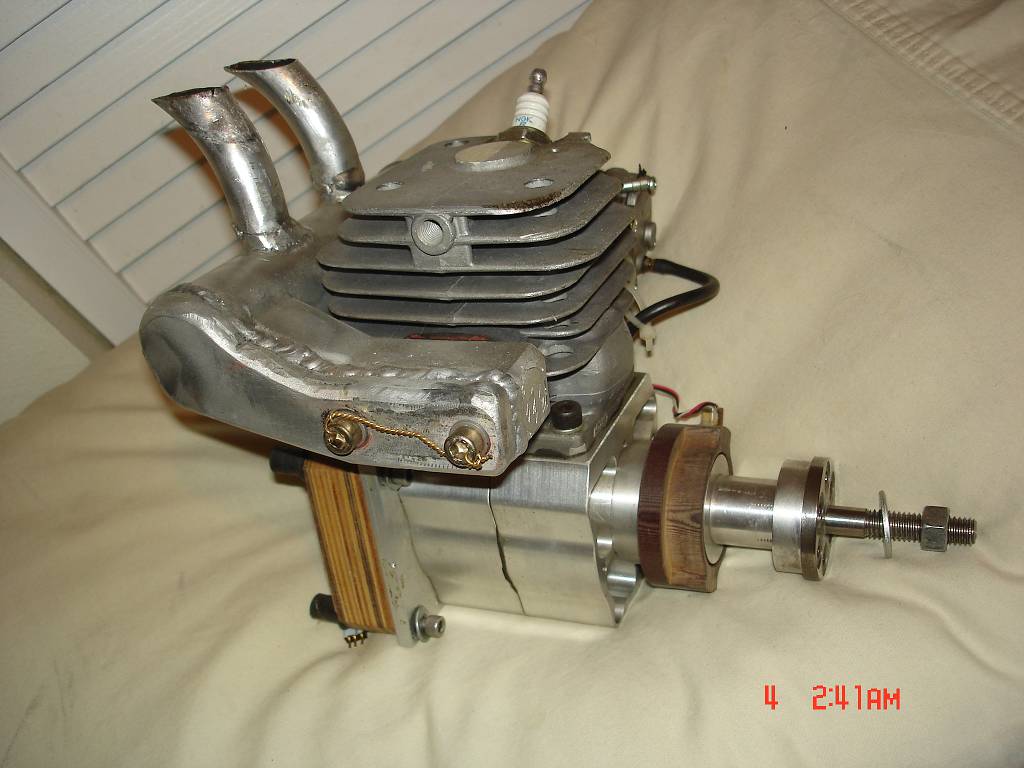

I have the pics up. I am doing one post per engine to aid in clarity. Here is one I need identified. It has a "44"on the front of the cylinder. It looks to be in the 40 cc range. It has a Walbro 21-245 carb, and it also has the CH ignition. Does not have an mechanical advance on ignition. This is a very high quality engine. Any thoughts?
ID:	1852176   Click image for larger version

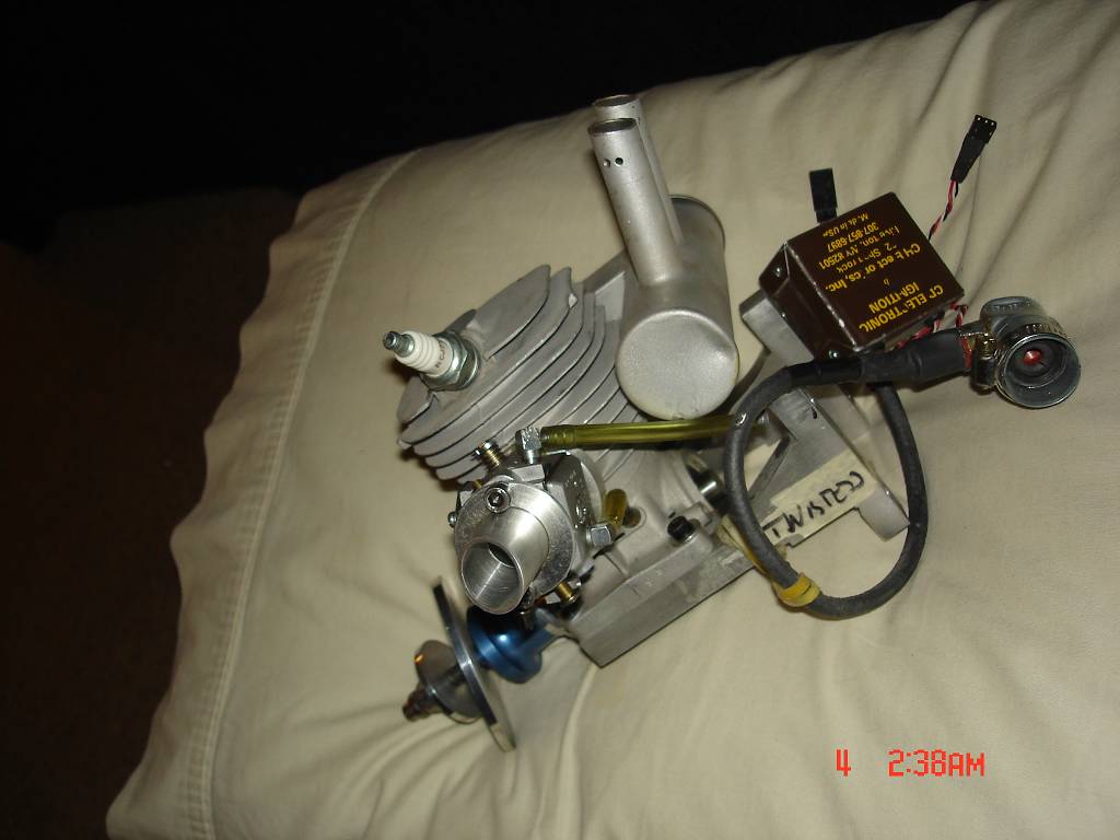

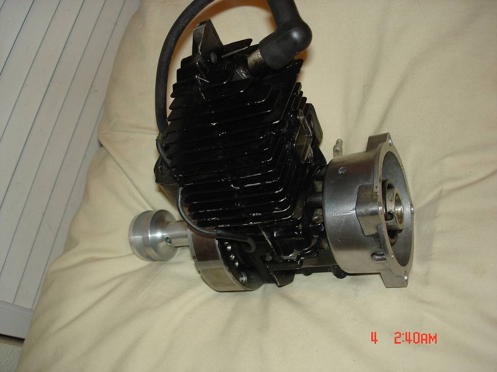

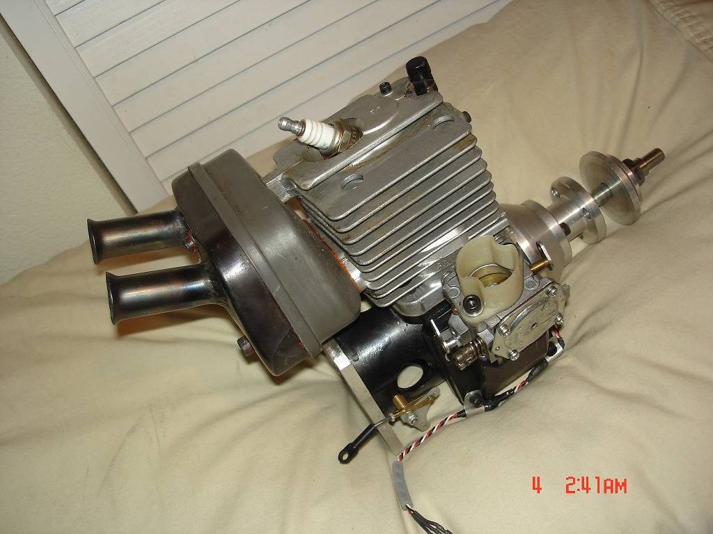

Here is another one. It is mostly painted black. Not sure if this was stock or not. Magneto, side carb, Spring starter. Looks like a
Bennett mount From the size appears to be in the 30cc size. Any ideas?
ID:	1852178   Click image for larger version
ID:	1852179   Click image for larger version

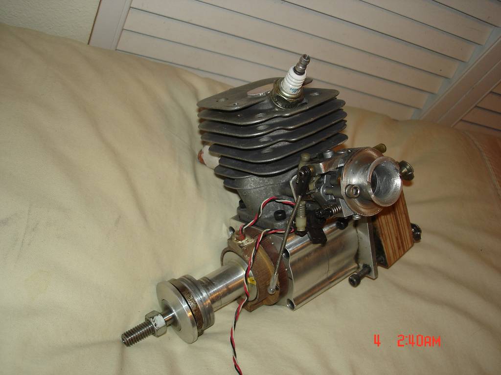

On we go! The lettering on the front of the cylinder sais, 44zn18. This looks to be between 45-65 cc. CH ignition with mechanical advance. Odd wooden disc used to mount the hall sensor.Smooth lower case, polished. Top end looks a lot like a G62. Any ideas here?
ID:	1852181   Click image for larger version

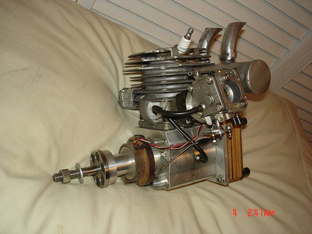

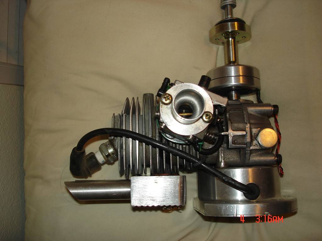

This one is big. Maybe a 75cc? Front case sais, 49ZN2. Bottom end smoothly finished, top end looks like a Zenoah, Fuel line running from carb to case, Wooden disc for hall sensor, CH ignition as well. Mechanical advance on ignition. Thoughts?
ID:	1852184   Click image for larger version

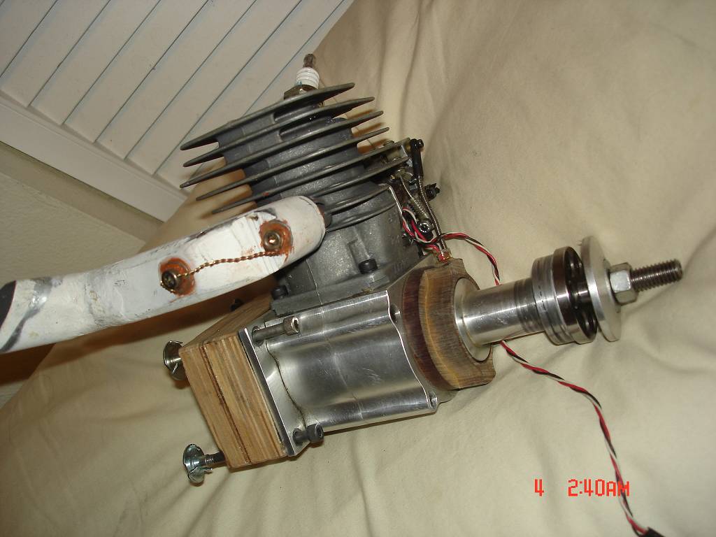

Another big and very nice engine. It sais Made in Canada on the case. Interesting feature on this one is a sort of compression release pin on the top front of cylinder. When pushed down, compression decreases and you can hear the bleed off. Raise it, and the compression is strong with no hiss. Interesting carb mount. It has a tapered block mounted to block of engine. Tillotson carb, CH ignition.
Pretty cool all this stuff!
ID:	1852186   Click image for larger version

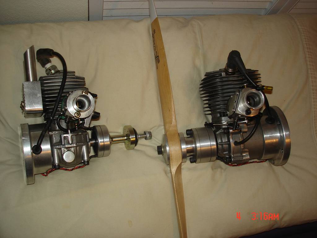

# 4 and the last one are Quadras, a 35cc and 75cc. The 75 is a real powerhouse and will swing a 24X10. The 35 is pretty goggy. The engines with CNC cases are A&M Sachs based engines. The first I think is a BME44.

Those are Ralph Cunningham engines and they have his ignitions. Mechanical advance The jack is for the 4.8V battery to run the igntion

I think #3 might be a sachs.<div>
</div>
Old 02-14-2013 | 08:06 PM
Posts: 1,343
From: Orange, NJ
Default RE: Identify unknown engines
ORIGINAL: vertical grimmace
This looks like the Sachs 3.2
This one maybe the Sachs 4.2. by A&M. Not the Zenoah.

ORIGINAL: speedracerntrixie
That looks like an old Quadra conversion which is not as powerful as the 75XL or the mag 75. It still packs a punch though.

ORIGINAL: 91zulu
So this would be a 75? A 24" prop is in order with this one?
Old 02-14-2013 | 09:18 PM
Posts: 1,343
From: Orange, NJ
Yep a 24x8-10 should do the trick. But also remember it also depends on the plane you put it in. Example for the G62 a 23x8 is the sweet prop for that engine with the mag. I found it pulled the Zirolli Stuka with authority but the same engine in the Meister 109 it was a 22 x10. So do some testing on the bench just to see the numbers you get. The engine may be still strong or it could be weak. Try to get to between 6800 - 7200 just to find out what the engine has in it. If it is not getting to 6800 with a 24x10 then you will have to prop accordingly.

This is a BME 44
I have the pics up. I am doing one post per engine to aid in clarity. Here is one I need identified. It has a ''44''on the front of the cylinder. It looks to be in the 40 cc range. It has a Walbro 21-245 carb, and it also has the CH ignition. Does not have an mechanical advance on ignition. This is a very high quality engine. Any thoughts?
