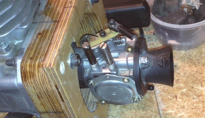

I've just been back yard running my two 3w-50i motors to make sure they are working before I put them in a plane. Both carbs were bone dry and I had to take the diaphrams out and moisten them before they would draw fuel. 3W also recommends sealing the carb block to the crankcase with anerobic sealer. I've got both running now but one is missing at full throttle, and is about 300 rpm less than the other. Anybody got any ideas? I've already replaced the plug and cleaned the carb screen.
Sam

Sam, can you take a picture or two of your carb? I was wondering if it is the same as mine....
Jerry

Jerry,
Here is a pic of the carb on one of my 3w-50i motors. I've converted both to run on RCXEL ignitions, and when I test ran mine, I used the same ignition, battery, tank, etc. i just switched the engines on the test stand. Getting the motors to pull fuel has always been a problem until they were "wet". My first big breakthrough came when 3W suggested I use that anaerobic sealer. The second was when I just bit the bullet and took the diaphrams out and put gas on them and then reassembled the carb. If you're drawing fuel you should be able to see the fuel move down the fuel line to the carb each time you swing the prop. I've also heard that you can "bounce" the prop against compression in a back and forth motion and it will activate the fuel pump enough to pull fuel to the carb. Hope that helps,
Sam

Just a quick update on my "missing at full throttle" issue. I checked the timing on the ignition and found that it was about 45 degrees BTDC! I don't know how I could have messed it up that bad but when I reset it to 28 degrees it ran great. I also pulled the carb block and found that the anaerobic sealer had pretty much disappeared, so I cleaned the surfaces and reapplied the sealer. I also found that the carb was not wanting to close all the way which was making the idle fast and tricky to adjust. I loosened the screw that secures the butterfly and then fully closed the carb, setting the brass disk in the center of the opening, and it now has full travel and seals great.
On the test stand the motor pulled fuel by "bouncing" the prop back and forth and fired right up. At full throttle it ran perfectly, and after tweaking the needles it transitions and idles well, as well as stops when the carb is fully closed (by the OEM spring). Also the RPM is identical to the other engine now.
It is a rare day when something is attempted and something is accomplished! Jerry I hope you get your motor running good.
Sam
