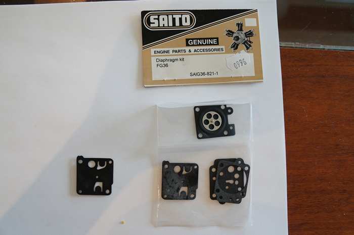

That part has been superseded by a new diaphragm kit, the item number in the US will be SAIG36171. This will suit the FG-30B, FG-36, FG-40, FG-57TS and FG-84R3D. I'll advise ETA when it becomes known.
Craig
Originally Posted by kwik
Well, those who say that there doesnt exist a Diagraphm kit for the FG 57 has really led us astray.
Here; I ordered this kit from hobbyplastic. It took just a few days and I had it in my hand.
The parts fits the FG-57 as well, so I have replaced mine now.
If you cannot read the small text, it says;
SAITO Genuine Engine Parts & Accessories.
Diagraphm Kit.
FG36
SAIG36-821-1
It angers me that those who should know, doesn't know.
