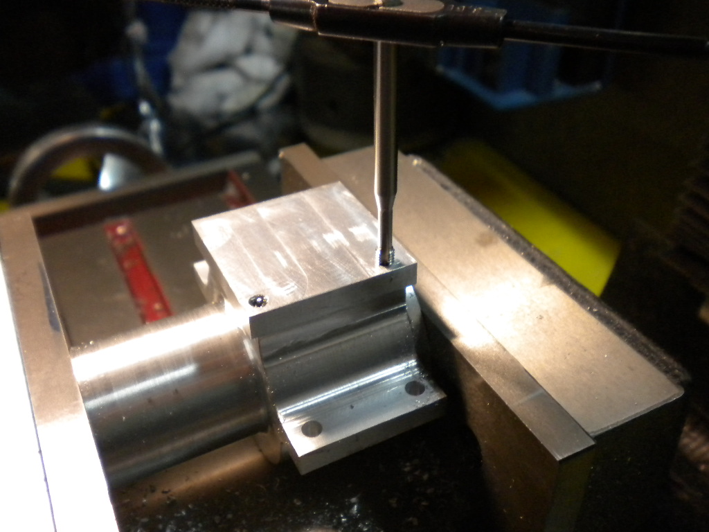

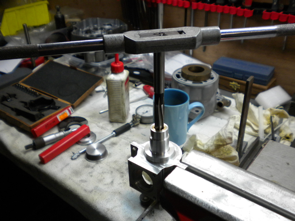

Some more pictures of my work so far, first 2 holes drilled in the back plate, for the spanner , than the mounting holes of the motor , and then the holes to secure the cylinder, the first hole drilled and tapped (M4) but the second hole drilled on 28 mm instead of 30 mm, stupid of me but I've fixedas you can see on the pictures

Nice work, cool project. For me, it is like looking at art.

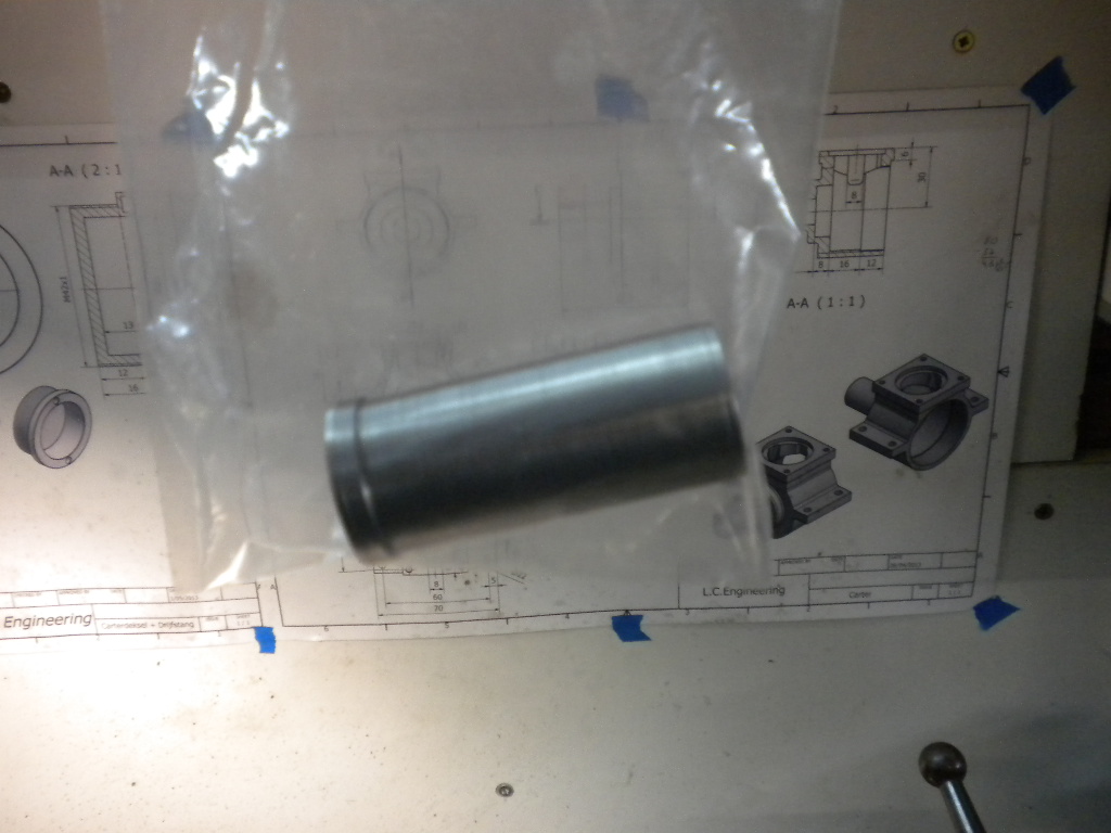

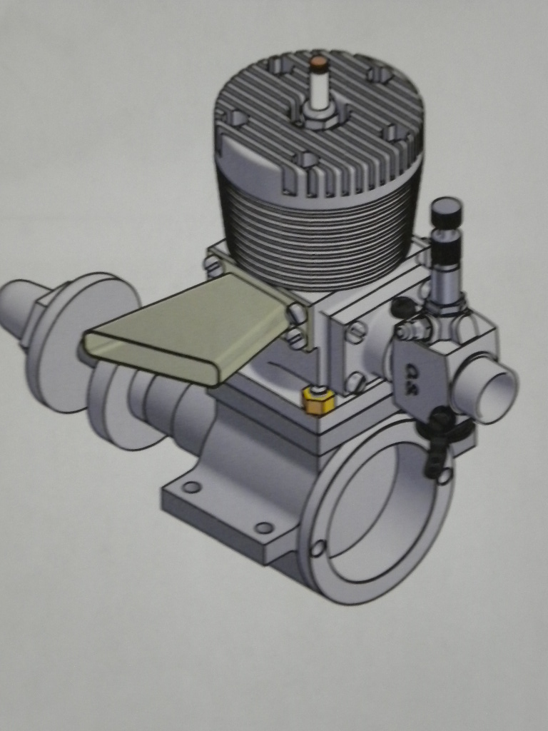

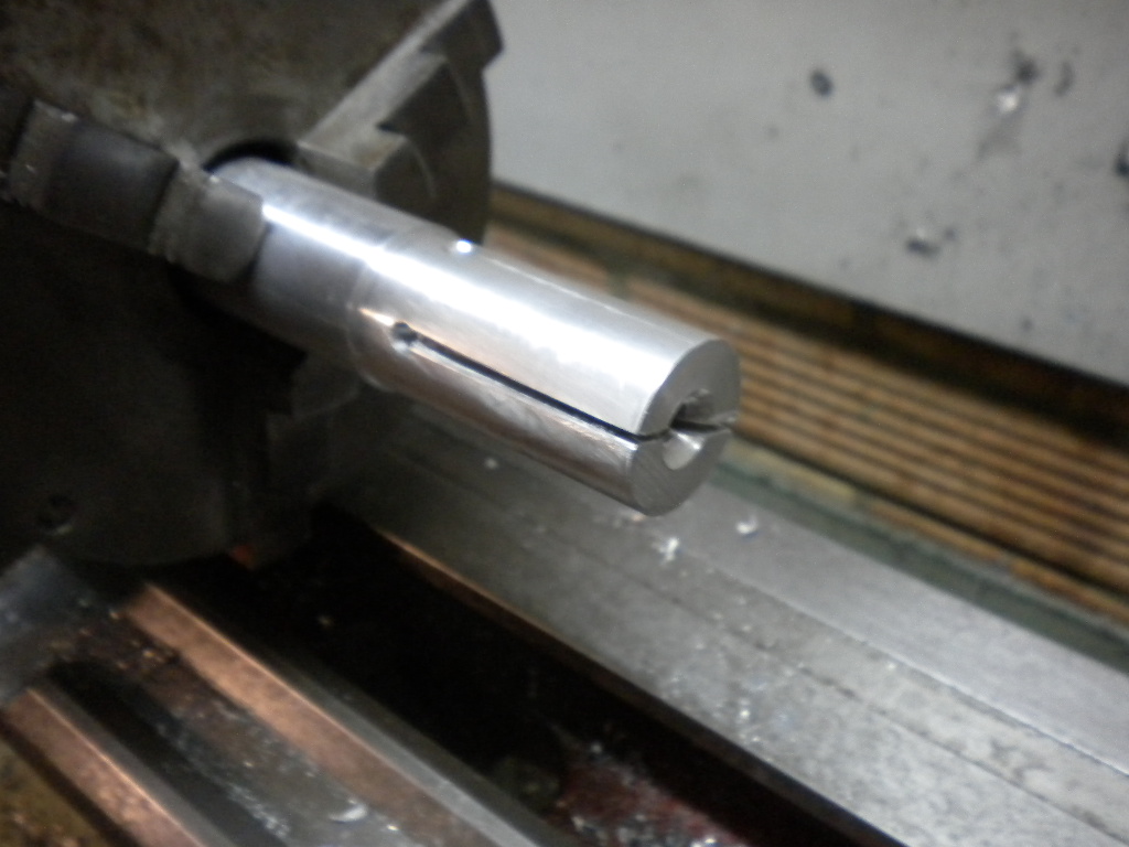

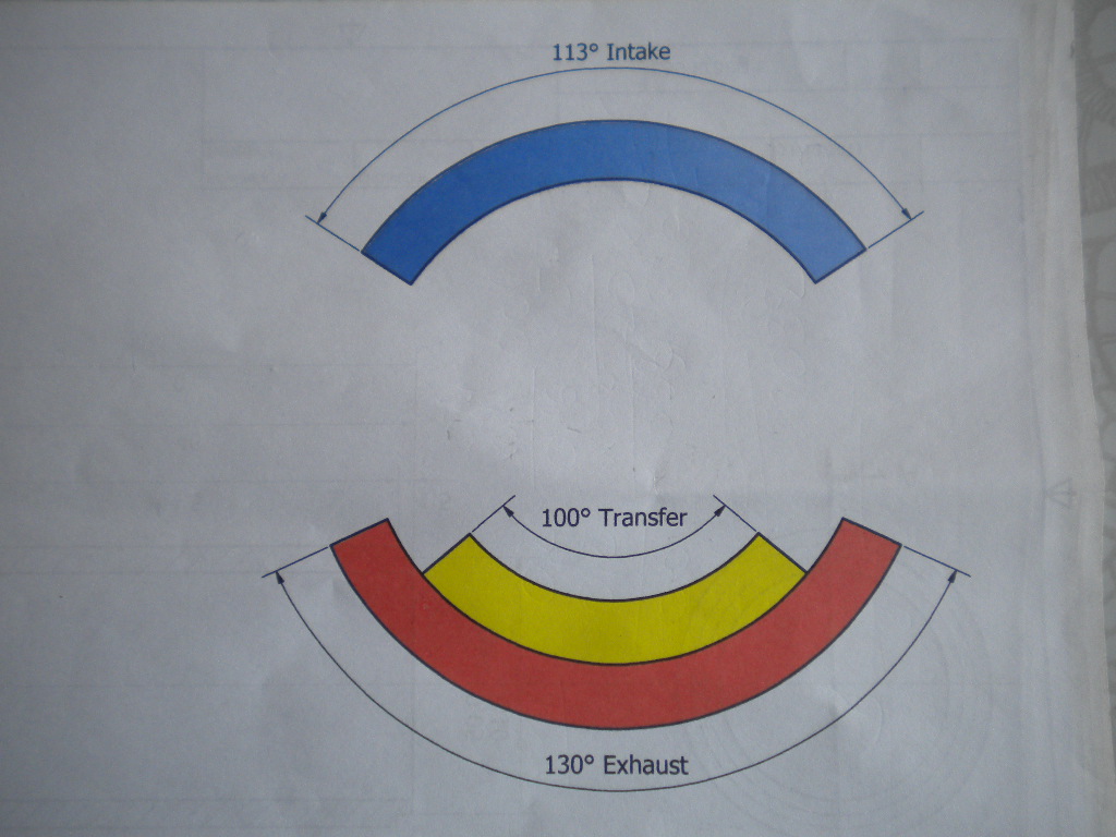

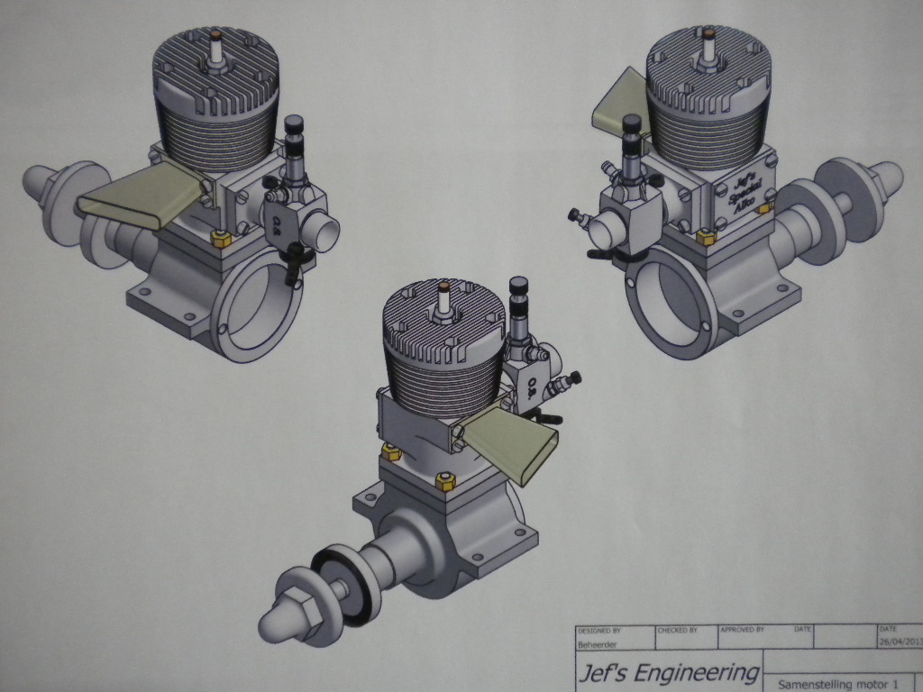

The drawings that I made of the engine, with an OS carburetor of a .40 engine
ID:	1881098   Click image for larger version

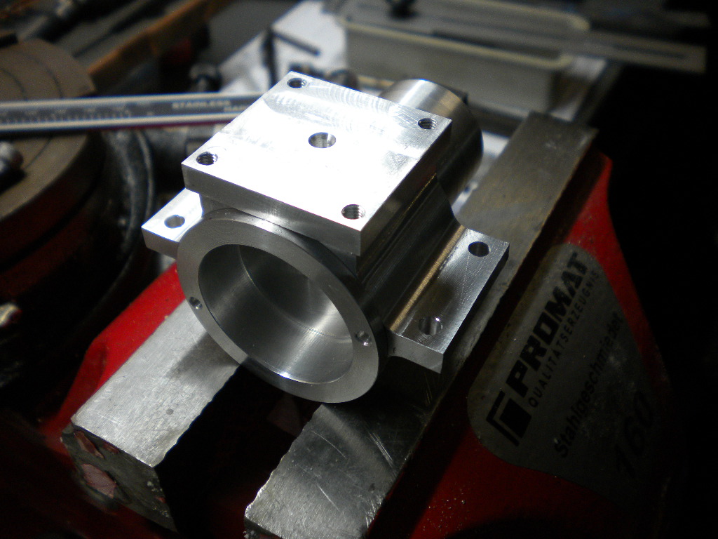

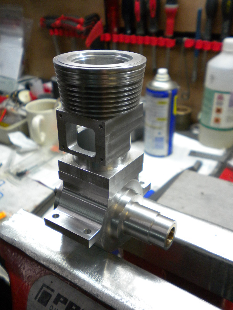

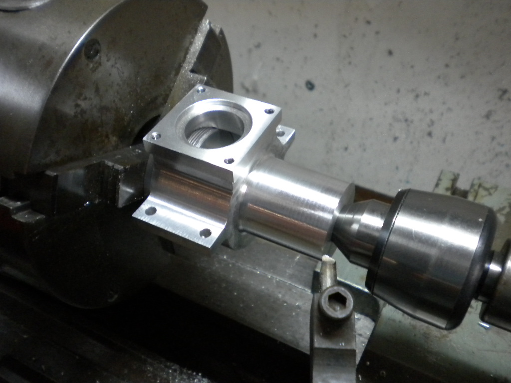

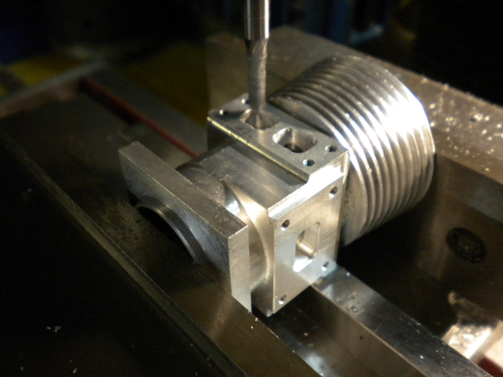

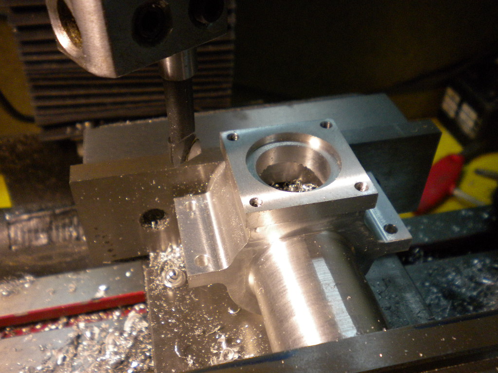

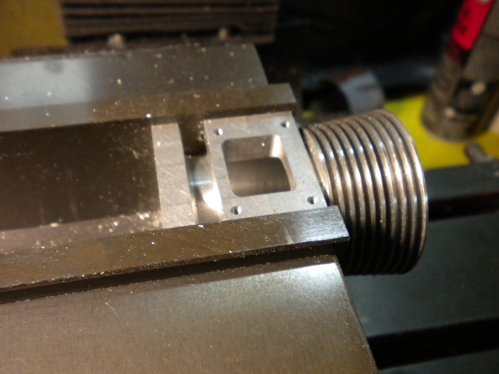

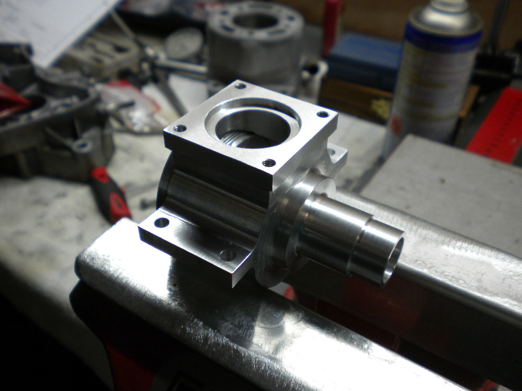

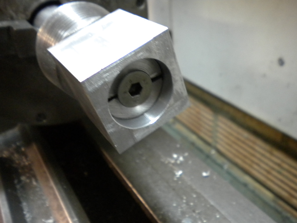

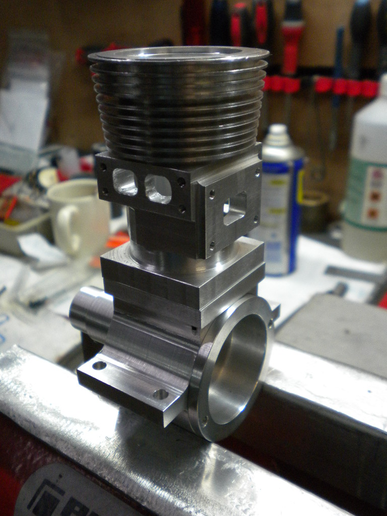

The crankcase is almost ready , only some milling for the connecting rod
ID:	1881229   Click image for larger version

Old 05-13-2013 | 10:14 AM
  #36
Joined: May 2002
Posts: 6,852
Received 33 Likes on 32 Posts
From: Mandeville, JAMAICA
Default RE: Homebuild petrol engine
Very nice and if it runs half as good as it looks you will have a winner.
Old 05-13-2013 | 11:28 AM
  #37
av8tor1977's Avatar
Joined: May 2003
Posts: 7,245
Received 6 Likes on 5 Posts
From: Tucson, AZ
Love it! Keep those pics coming.
What is the turned down area on the front bearing snout for? A timing collar/ring?
AV8TOR

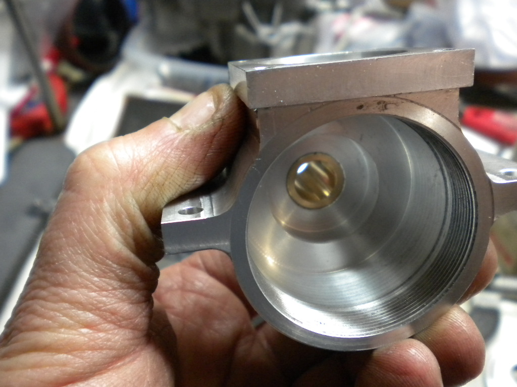

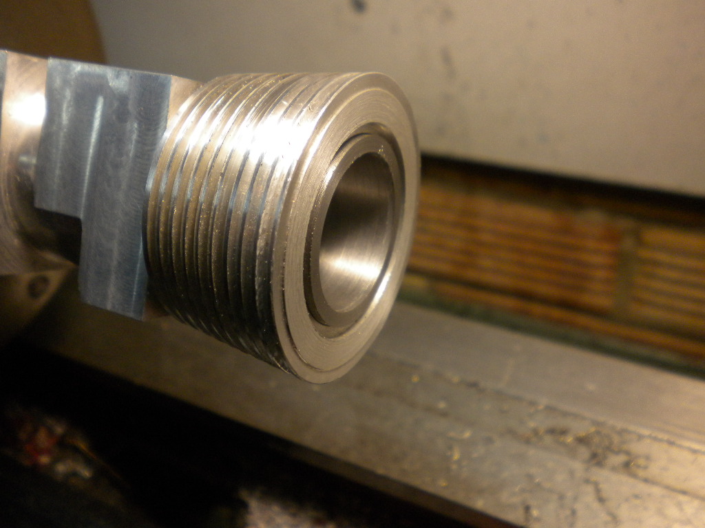

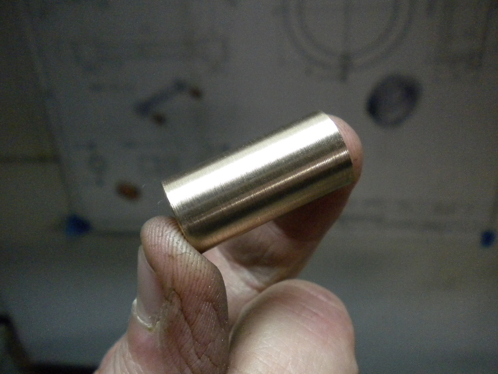

The bronze main bearing is also ready and pressed into the cranckcase with loctite and reamed to 10mm

Yes , it is for the ignition .

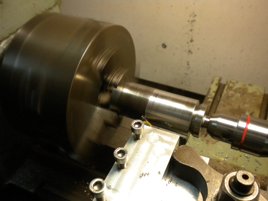

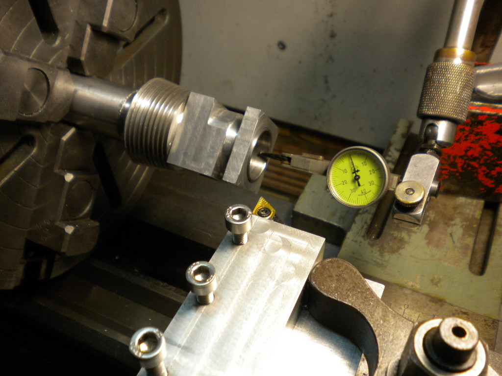

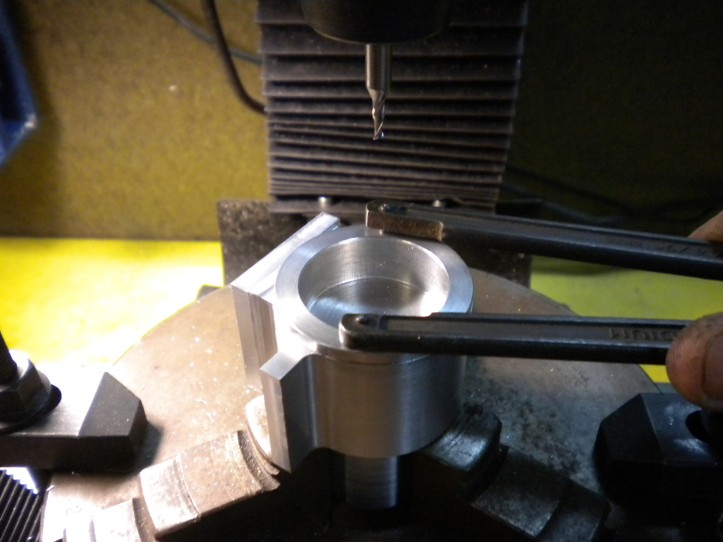

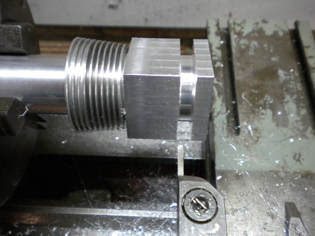

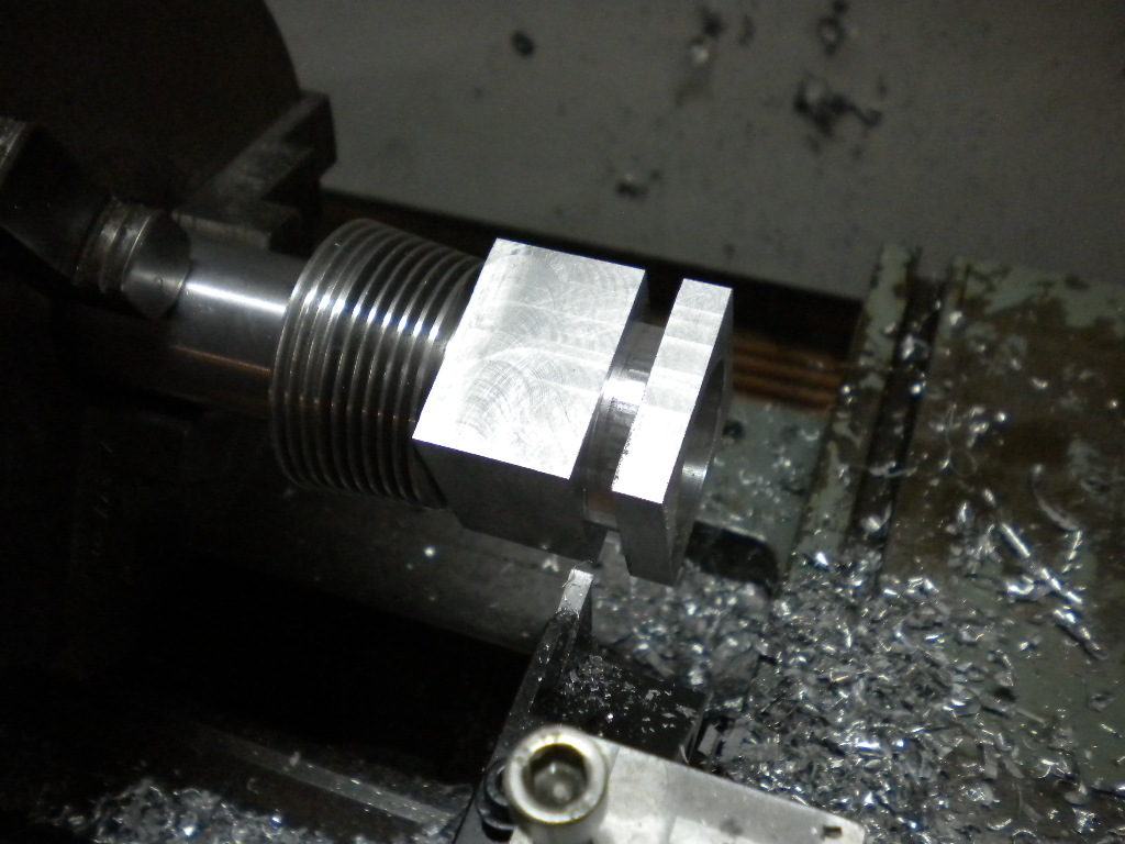

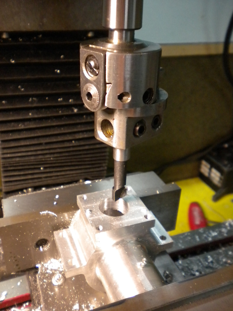

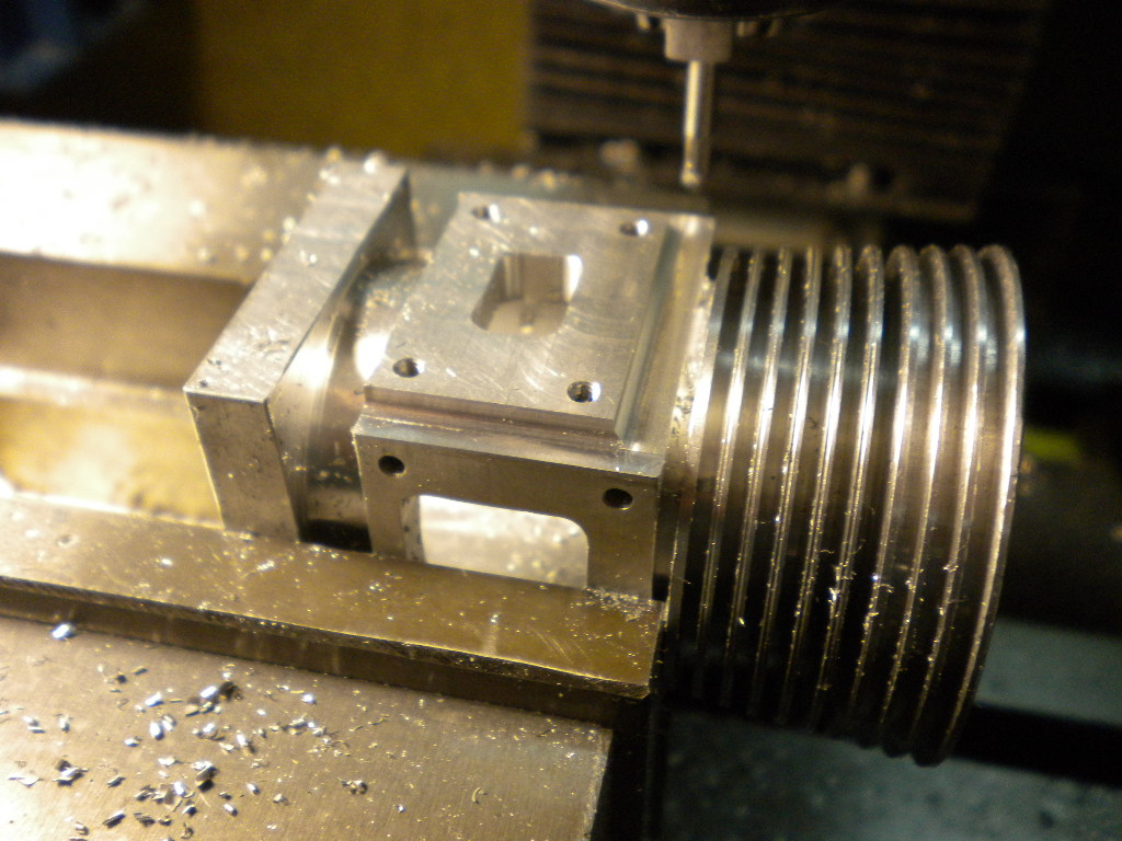

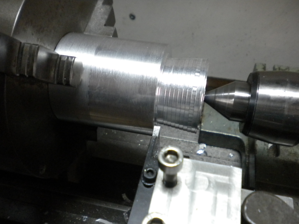

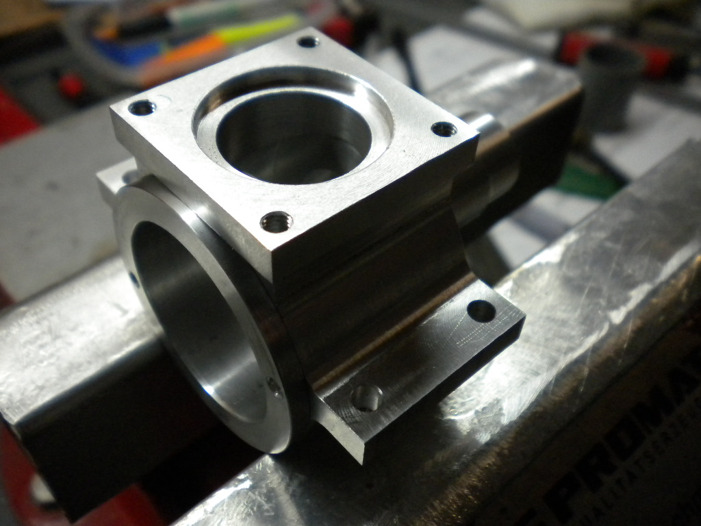

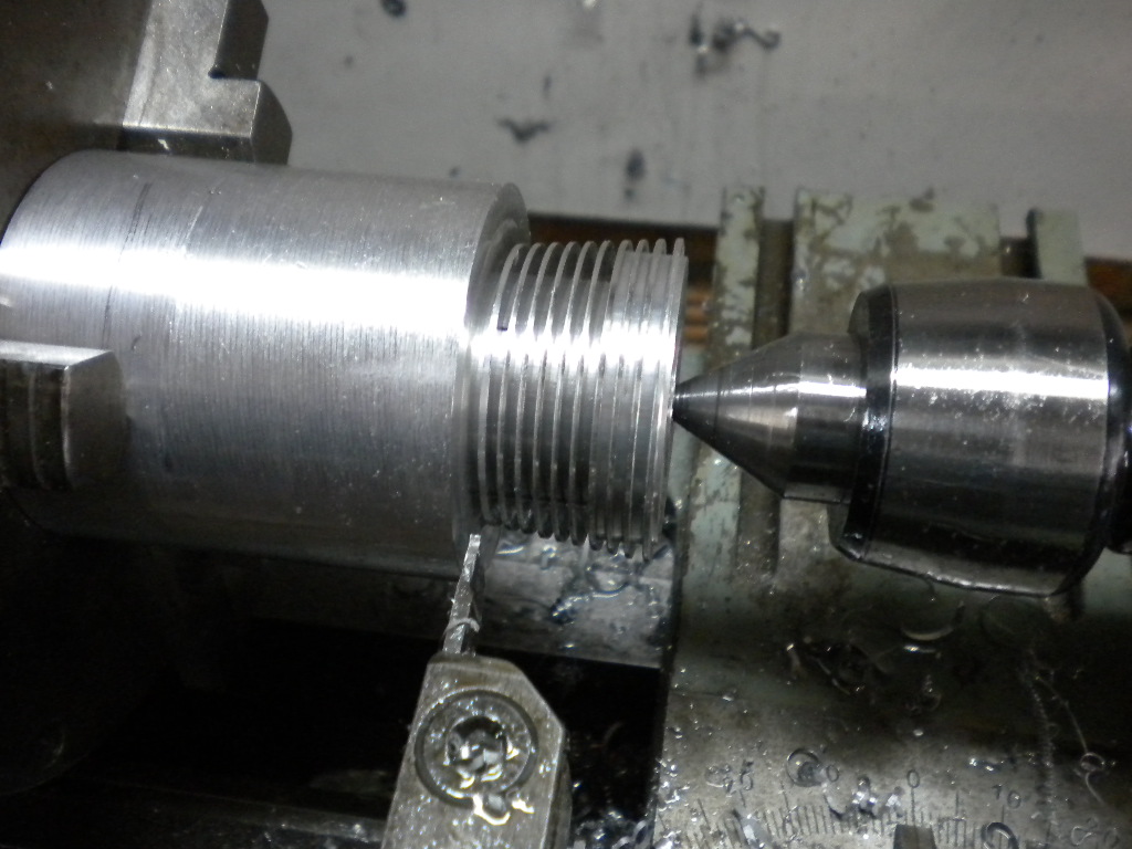

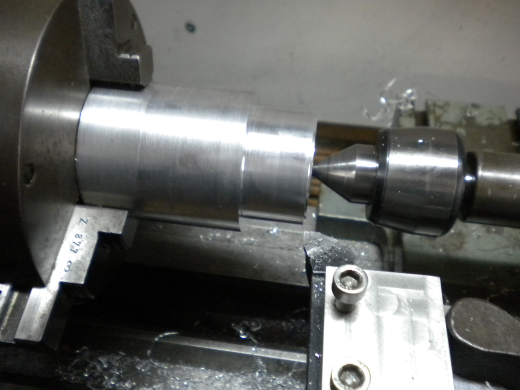

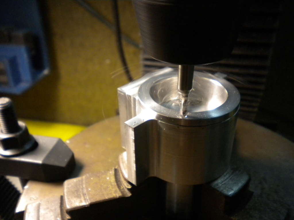

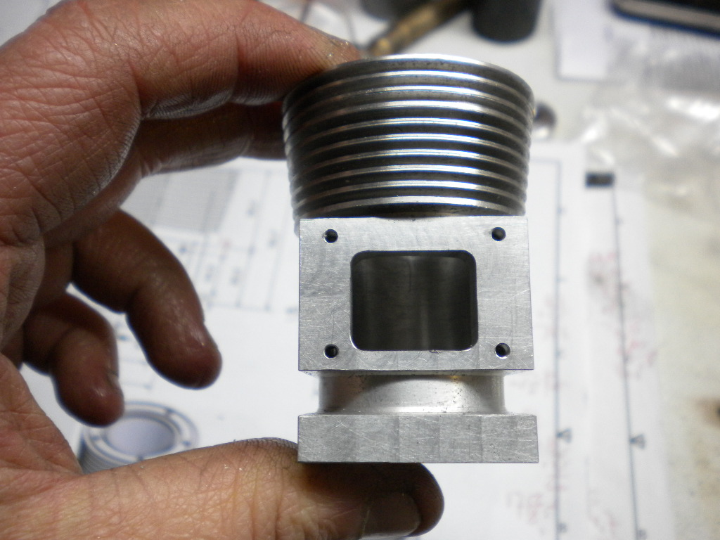

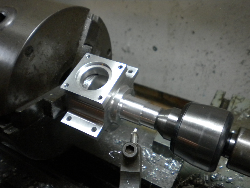

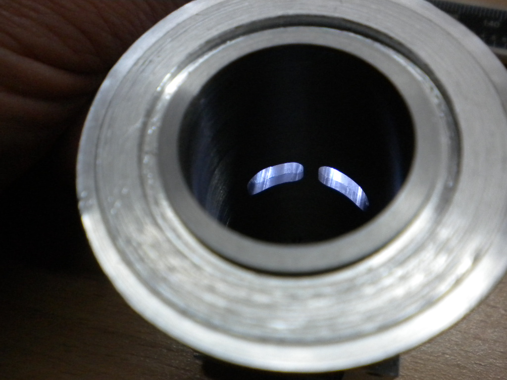

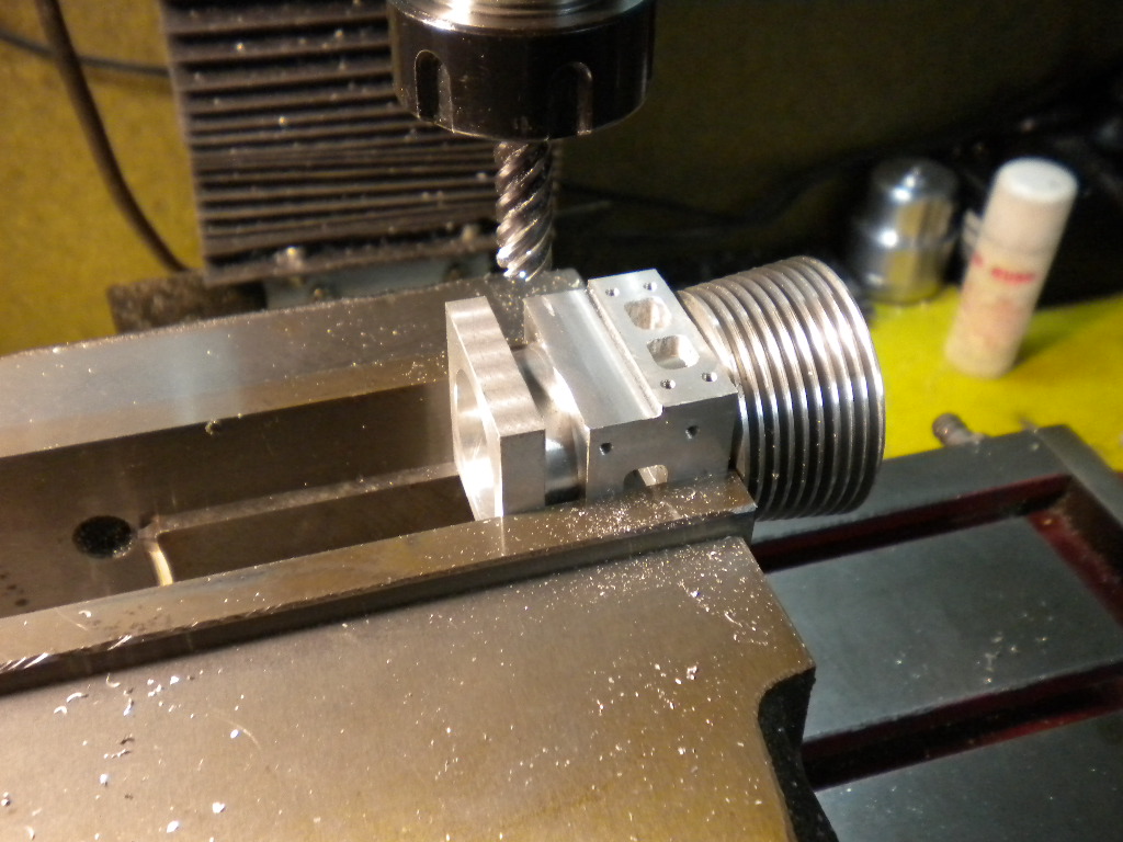

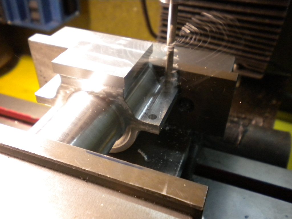

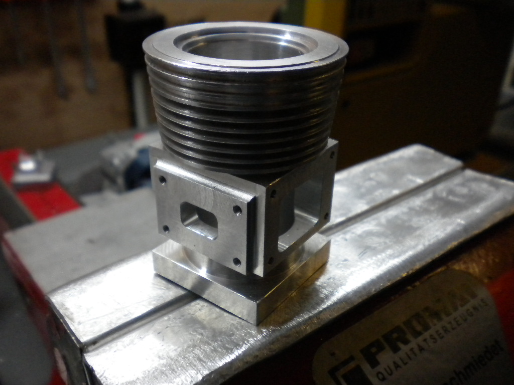

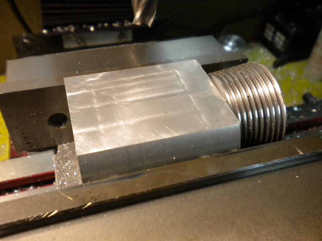

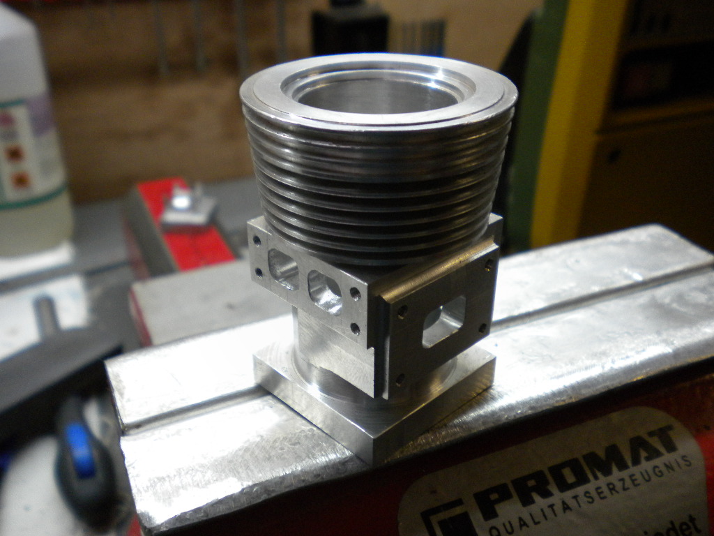

I have started on the cylinder

Old 05-21-2013 | 09:25 AM
  #41
Joined: May 2002
Posts: 6,852
Great pictures and nice work. What material will you be using for the liner and will the piston be ringed or ABC type.
Old 05-25-2013 | 02:13 AM
  #42
Joined: Feb 2011
Posts: 75
From: hulshout, BELGIUM

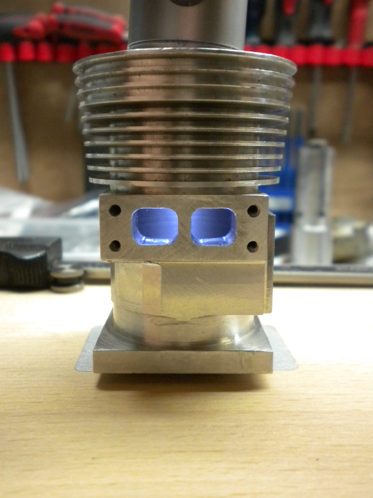

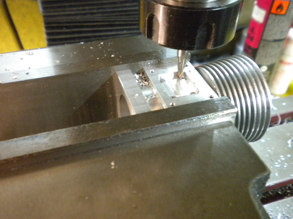

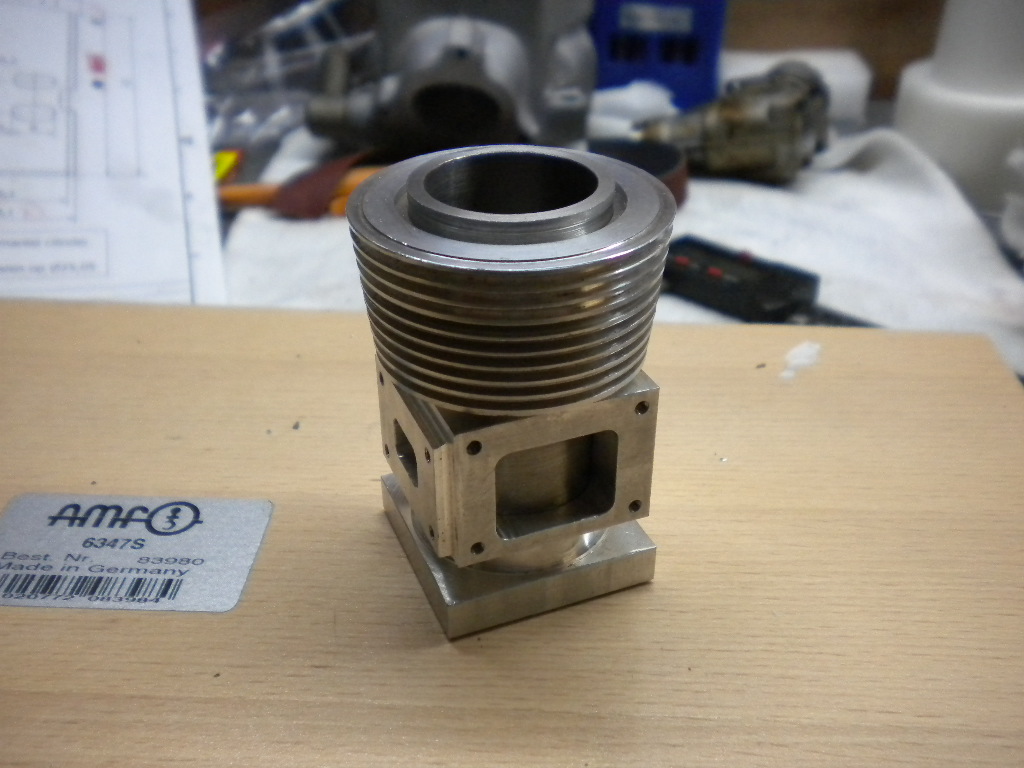

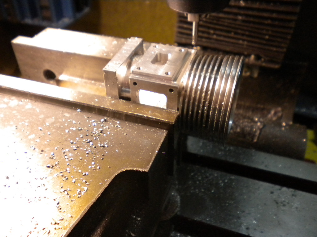

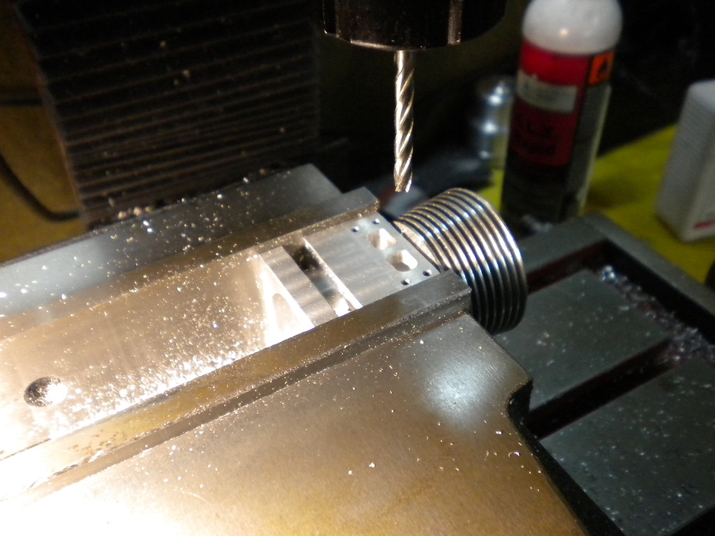

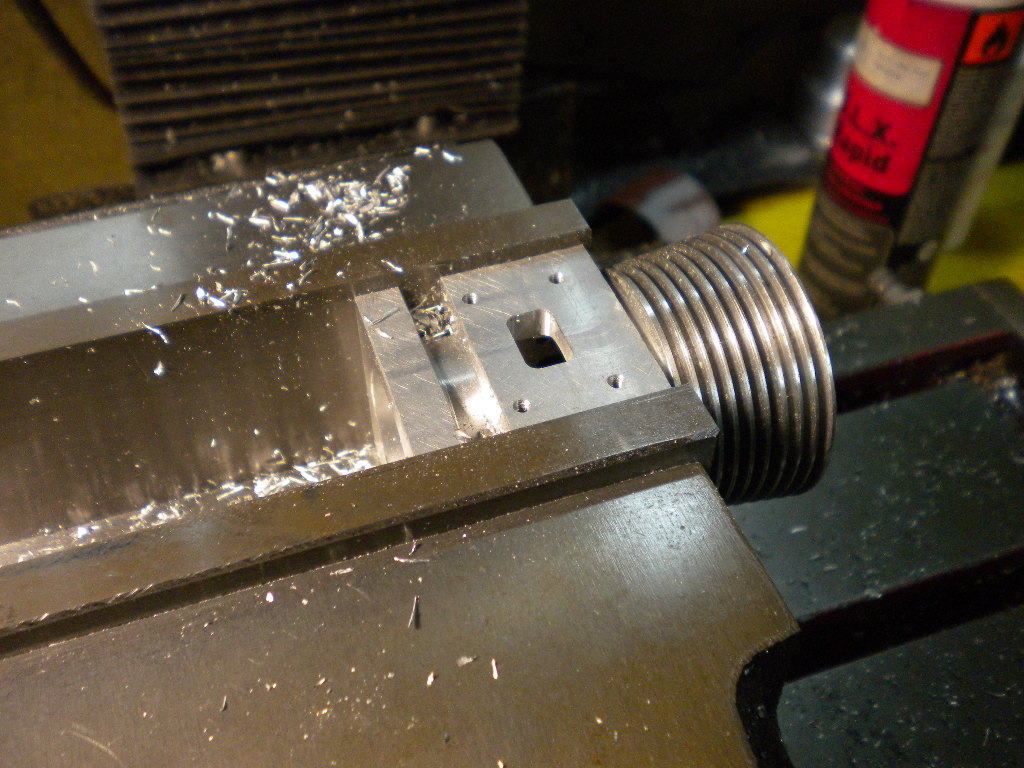

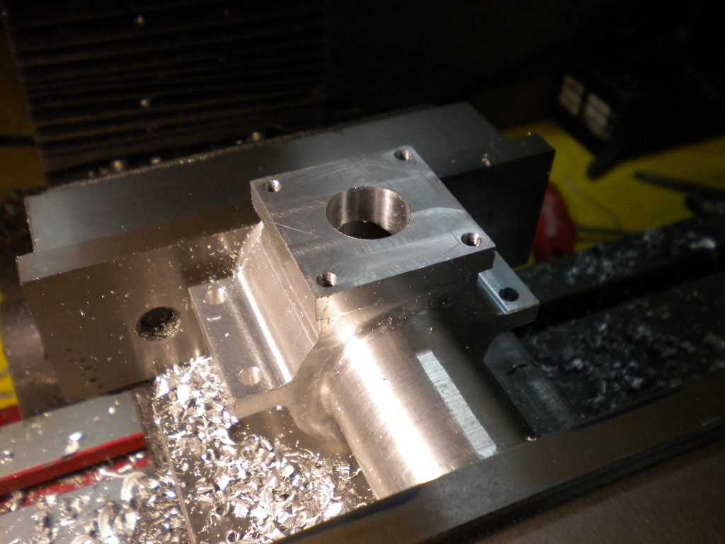

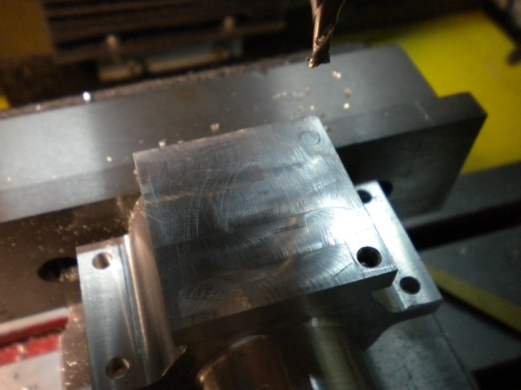

The cylinder is of Ck 45 steel , piston aluminum 7075 and the pistonrings cast iron GG25
Some pictures of the work on the cylinder
Looking very nice, but I have a question. What is the coefficient of thermal expansion between the ck-45 and 7075 Aluminum ?
Old 05-25-2013 | 07:05 AM
  #45
Joined: Feb 2011
Posts: 75
ORIGINAL: Cyberwolf
The coeffficient of thermal expansion for steel is 12 and for aluminium is 23
But I do not calculate that , I use a clearance of 0.002" for one inch of piston diameter
Regards Jef

Hi Captinjohn , it is a piston ported engine (old school) the porttiming of the new engine is 130&deg; for the exhaust ( was 110&deg; ) , 113&deg; for the intake ( was 100&deg; ) , 100&deg; for the transfers ( was 90&deg; ) , the compression ratio is now 6,7/1 ( was only 5/1 ) , in the future there will be certainly pictures of the rod construction ,right now I can not post any picture , internal server error .You could always go and see at another construction report from me on a Dutch forum , there are pictures between of the rod constructionhttp://www.modelbouwforum.nl/forums/bouwverslagen-vliegen/175091-bouwverslag-2cc-dieselmotor.html
Regards Jef

Hi Captinjohn , it is a piston ported engine (old school) the porttiming of the new engine is 130° for the exhaust ( was 110° ) , 113° for the intake ( was 100° ) , 100° for the transfers ( was 90° ) , the compression ratio is now 6,7/1 ( was only 5/1 ) , in the future there will be certainly pictures of the rod construction , right now I can not post any picture , internal server error . You could always go and see at another construction report from me on a Dutch forum , there are pictures between of the rod construction http://www.modelbouwforum.nl/forums/...eselmotor.html
Regards Jef

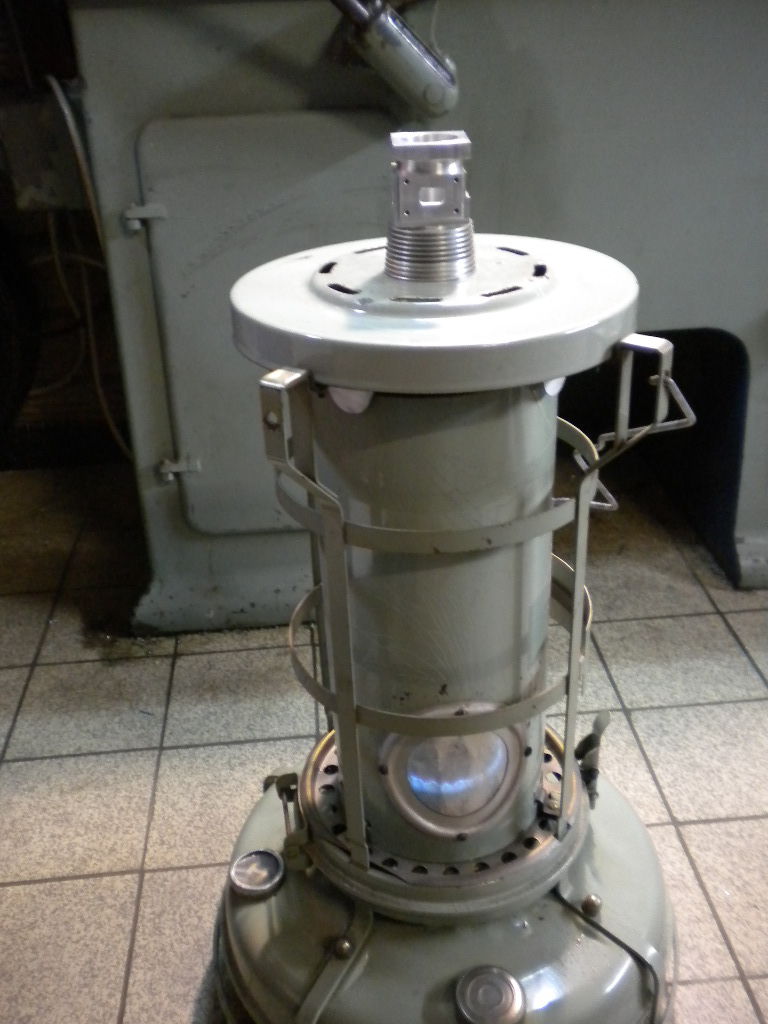

The cylinder liner is ready and packed to put in the deep-freezer ,the cylinder is warming up on my "Aladin" , once assembled and cooled the liner gets stuck in the cylinder .
Then top and bottom of the cylinder and liner turned to the right size. Now milling the ports trough the liner , the exhaust is ready.
I have bought the piston rings instead of to make them myself because I have absolutely no experience here.
Regards andto be continued , Jef
