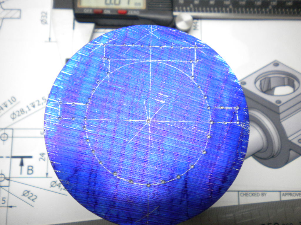

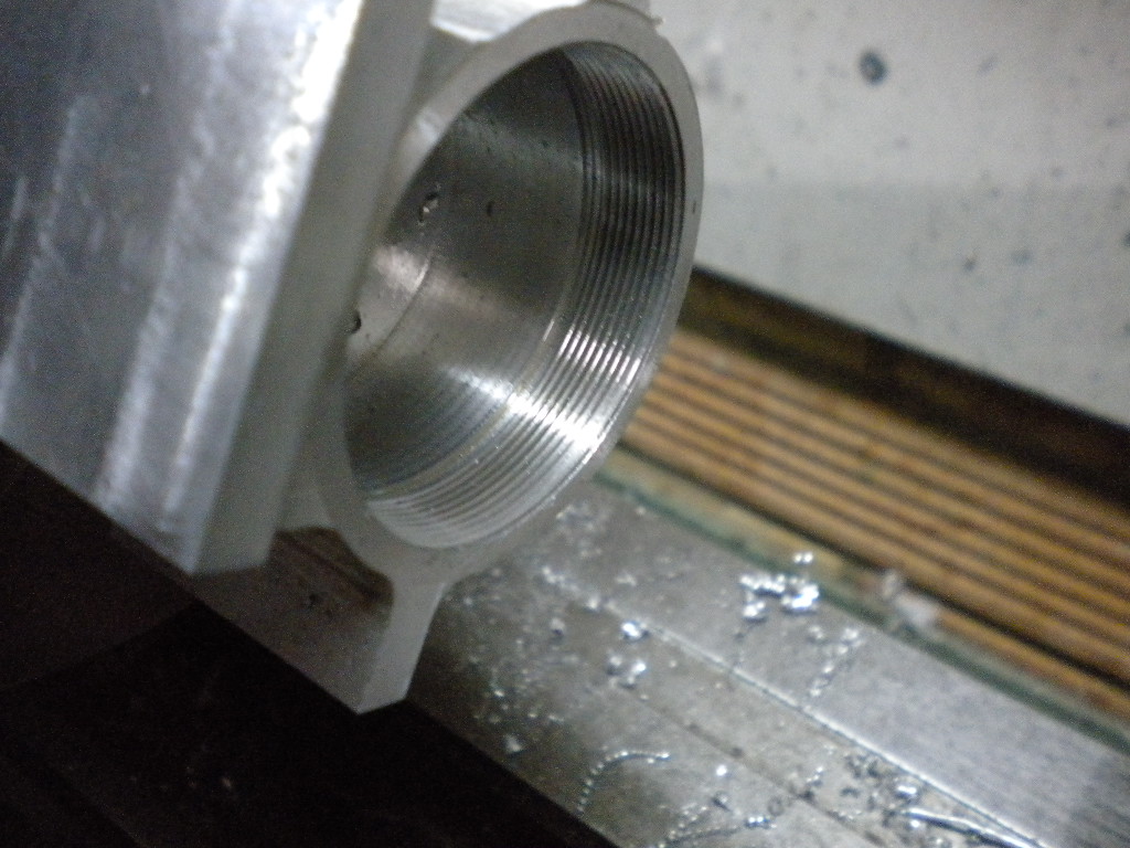

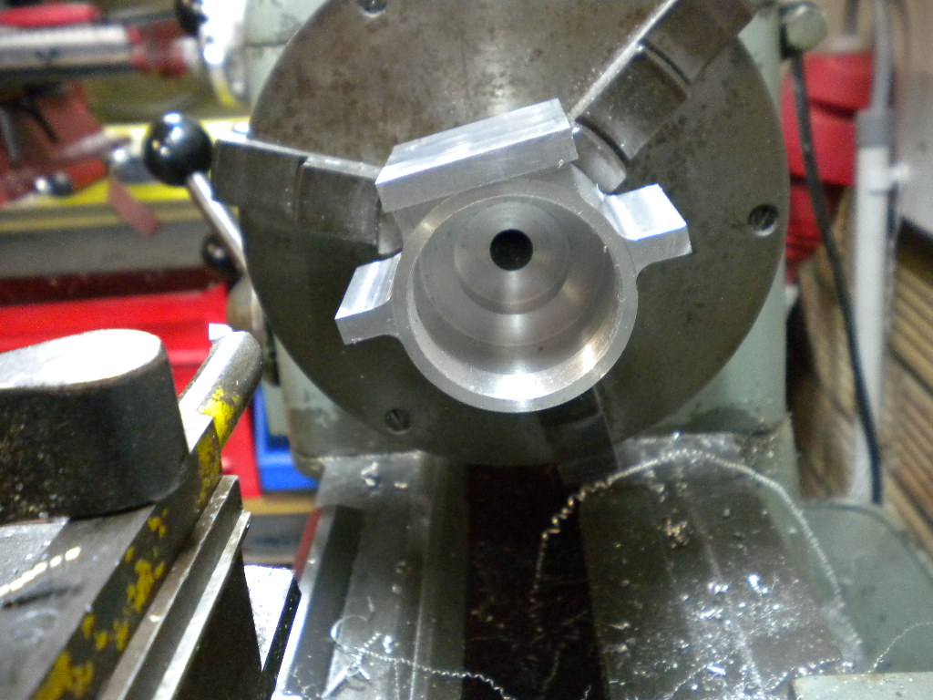

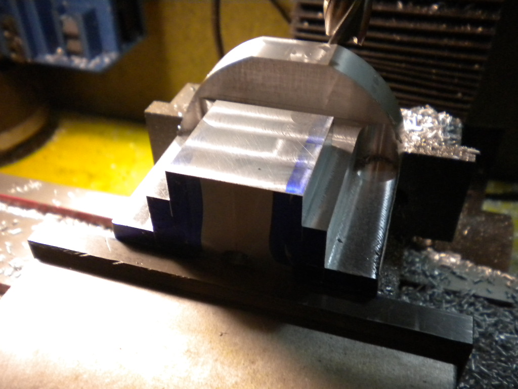

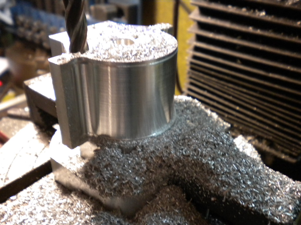

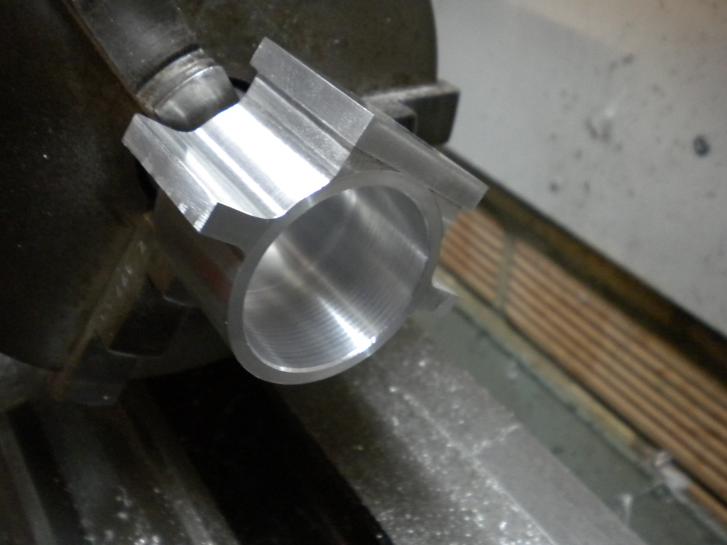

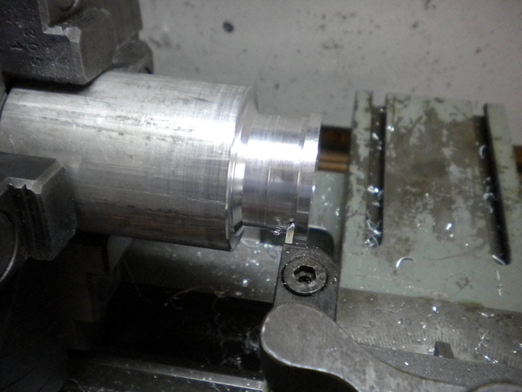

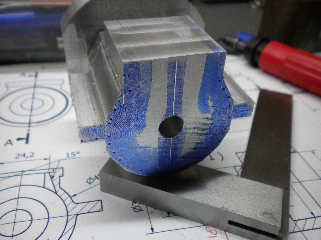

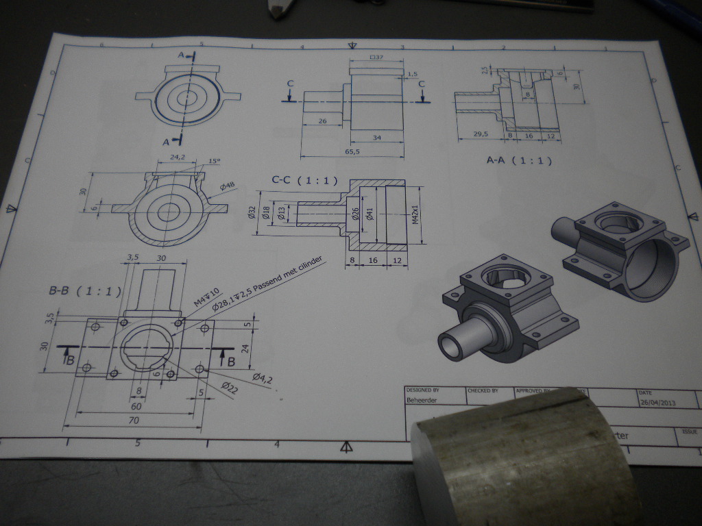

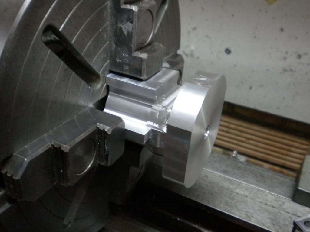

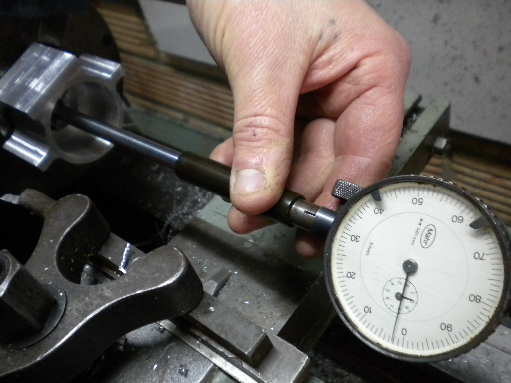

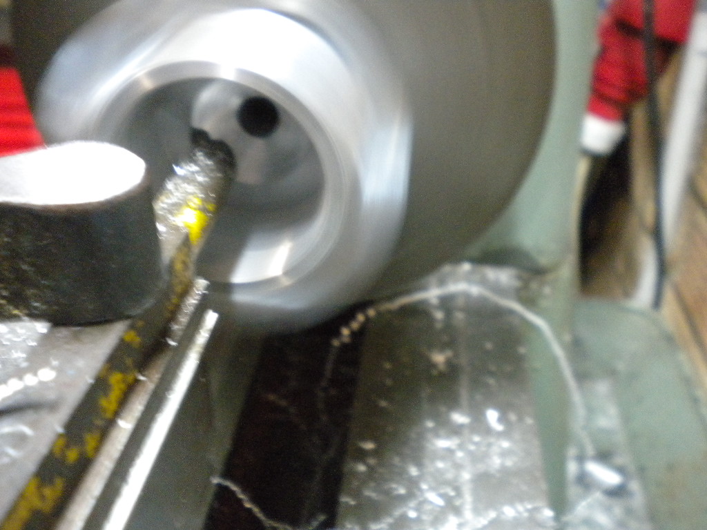

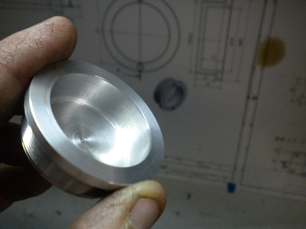

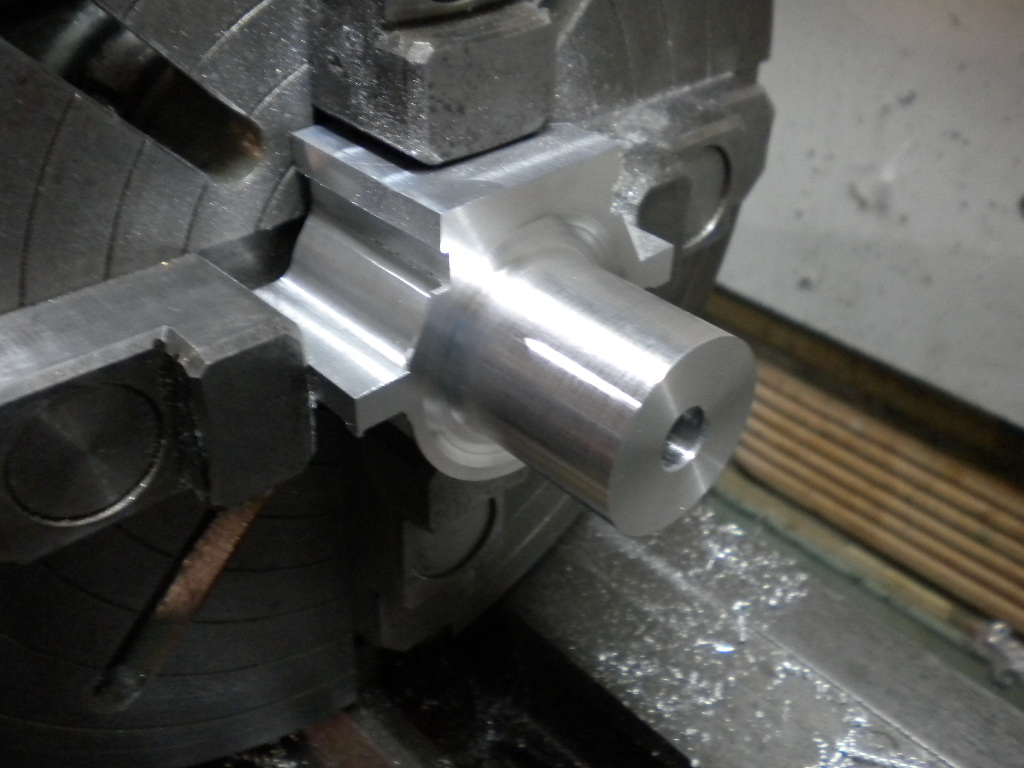

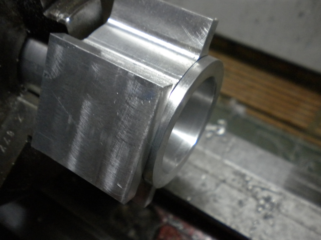

Hi , After my first successful engine built , the Owen Mate 2 cc diesel , I will now want to build a petrol engine based on the Alko Super 14 of 1943, I do have some modifications done, I will report regularly on the progress .<a href="http://www.mijnalbum.be/GroteFoto-KW7V7SUB.jpg">
</a><span style="color: rgb(0, 0, 0);">To be continued</span>, regards Jef
