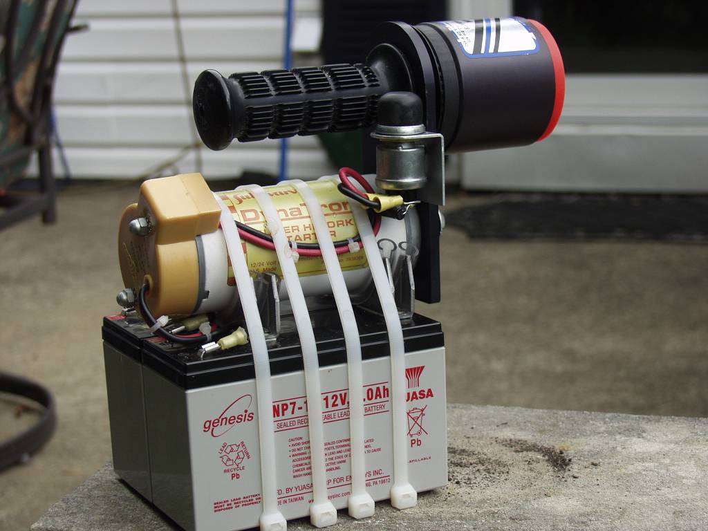

I use two of those batteries hooked in series on my starter

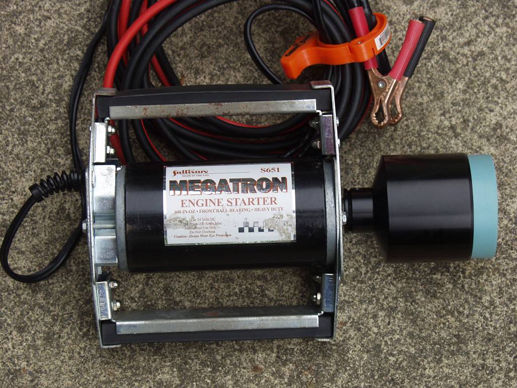

I have another starter and I just use the battery in my truck with jumper cables.

The megatron is more that enough the other big starter looks like your trying to start a 150cc motor.

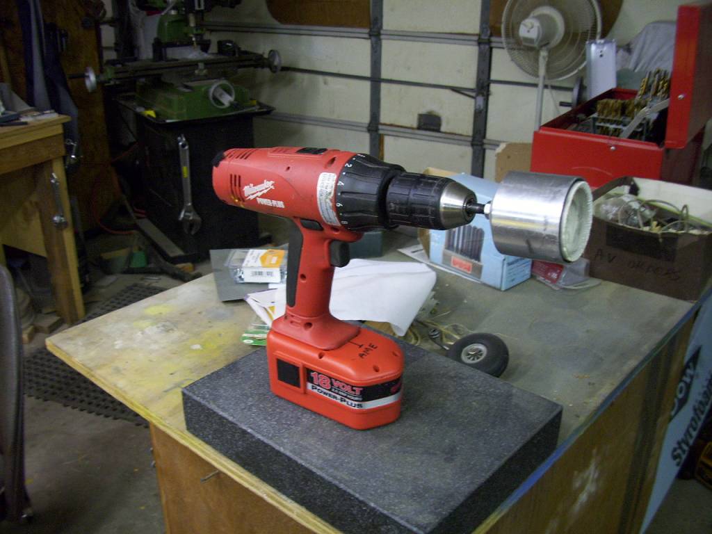

I use the sullivan dynatron up to 40cc on a garden tractor battery. For up to my G-62's, I use my millwakee 18v battery drill with adapter.

I have tried drills but they don't seem to turn fast enough. The Milwaukee works for you?

Yep, on the high speed setting.

Rex, I tried drills too and was generally disappointed.

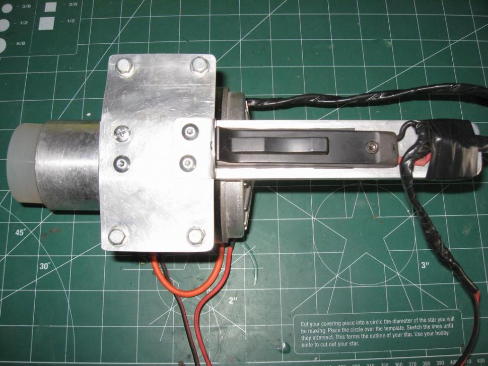

Here is one I made out of a 24 volt electric scooter motor. I use it on two 3 cell Lipoly packs for a total of 22.2 volts. It's a torque monster. Really needs a second hand hold. Works great though. I had a little gear reduced starter running on the same 22 volts, but this guy is WAY stronger.

Just in case anyone is interested, here is a new motor like I used in my starter for 30 bucks. Add a handle, a switch, and a cone and you have one stout starter for a whole lot less than they want for the high end Sullivan products.

That one would be a perfect direct drive rpm on 24 volts

Yeah, mine works great. A couple of common 3 cell Lipoly batts do the trick.

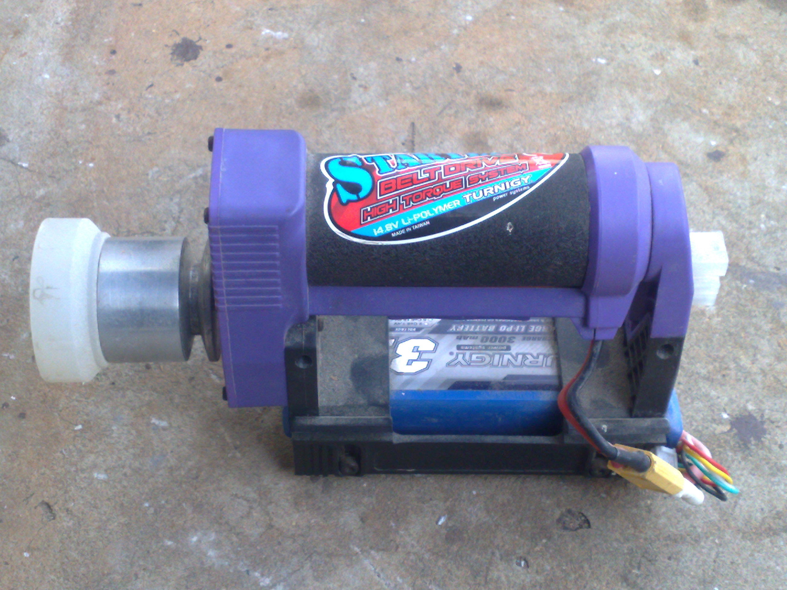

This is all I use to start my DLE30's heaps of power and self contained. From HK
