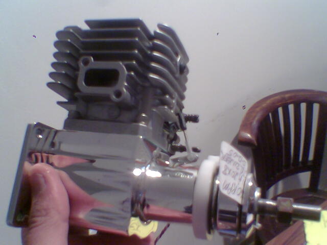

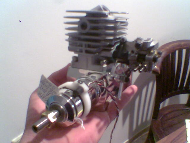

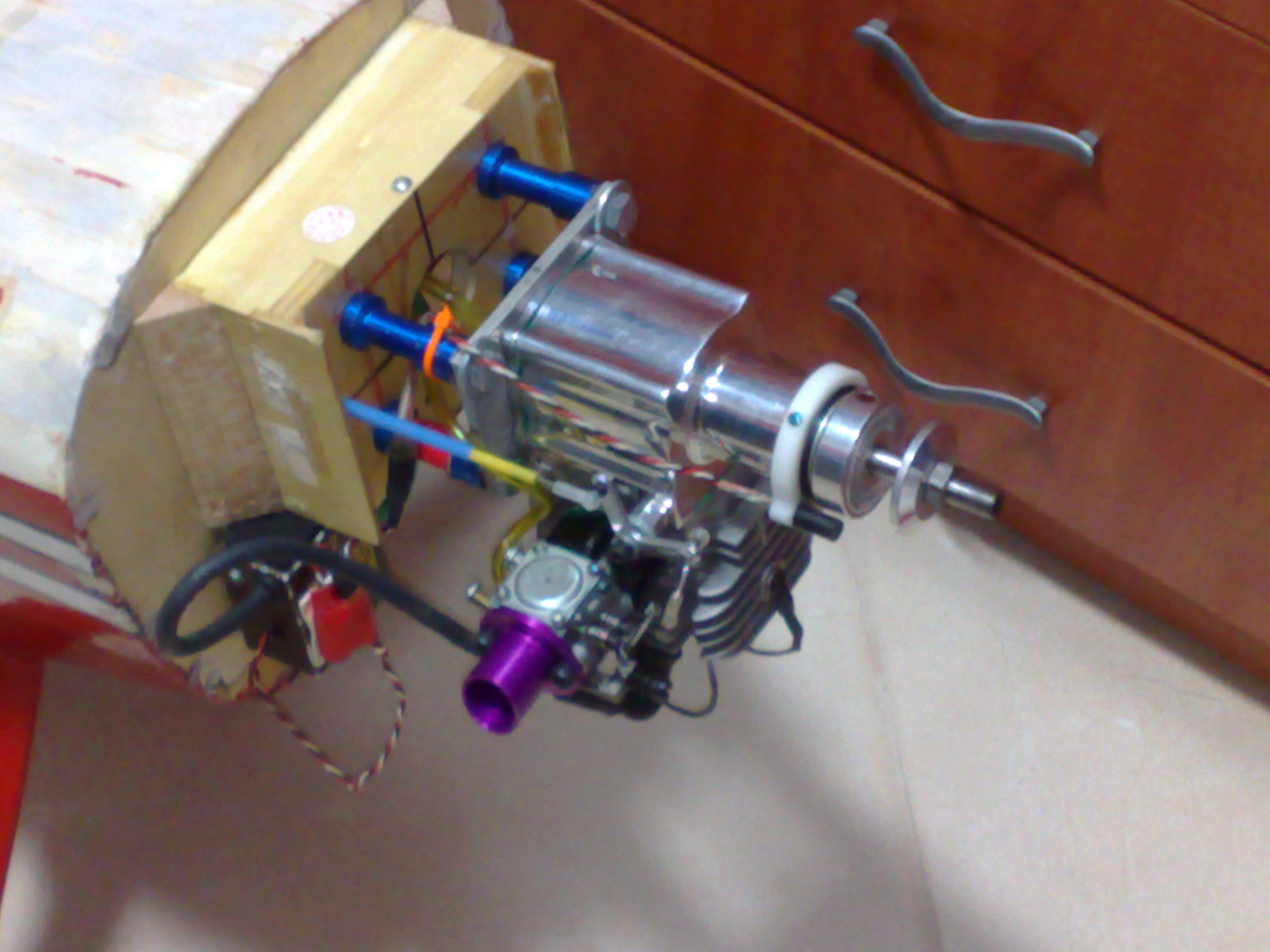

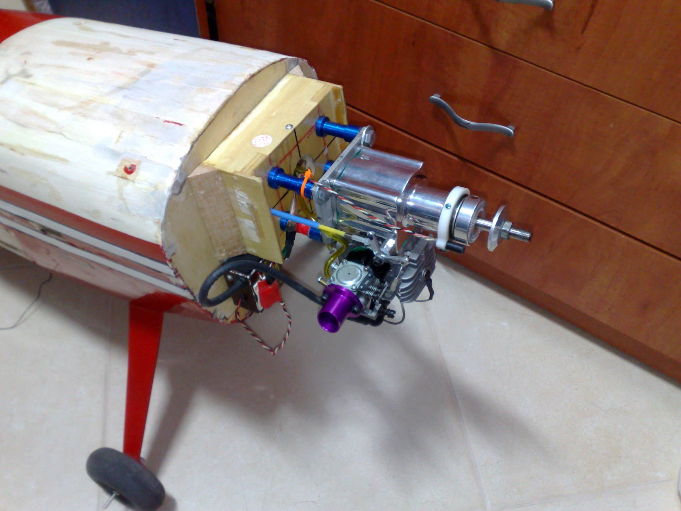

found the pics!!
this is the B2.4 with mechanical advanced IGI !!
today i have a CH ignition on it , without the mechanial unit.

Thanks for the images Gadi. I see that the original button head screw is still installed next to the sensor and that another screw has been added to the timing ring. Is there only one additional screw? According to designer, that button head screw retains the sensor in place. Anything else won’t. On mine, I can’t budge that sensor with the socket head screw I have in there now that does not make contact with the ring. Dan.

the screw have 2 applications
1 to hold the ring in place after you adjust the TDC
2 to hold the sensor in place as it can move FW/BRW over the magnet
3 the ring is held by an C clip ring as well - look at the photo you will see it
the screw isnt 90 dgree to the shaft, it is in an angle so it put pressure on the sensor housing as well
