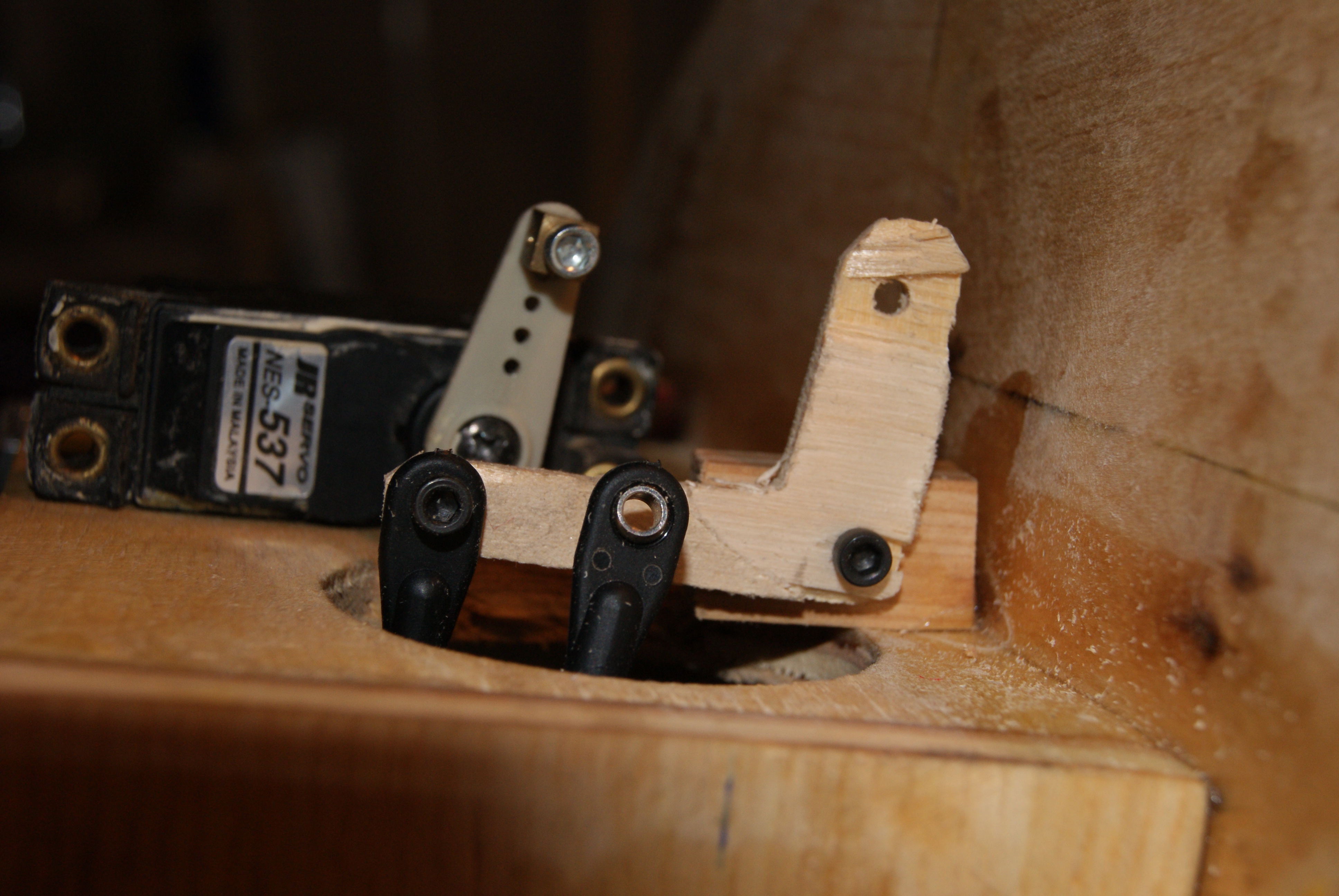

I bought one of these new from an aftermarket supplier. It's going on a 1/3 Waco YMF currently being built. This is my first big gas engine beyond a G-62, and I know next to nothing about it. The rear mounted carb was kinda unhandy when coming up with an engine mounting scheme. Others convinced me the long standoffs I had were a gamble. So I made a wood box for a mount. Now the carb is inside the box. I made a throttle servo linkage, but ignored the choke up to now. I just reviewed the instructions for electronic module and saw it has an automatic choke. Another mounting headache to run a servo to choke arm. Is this choke good and needed? If so, I would welcome any installation info, ideas, or photos if anyone has one of these engines mounted on / in a box.

Post a pic of your set up. Yes chokes are necessary on the first start up.

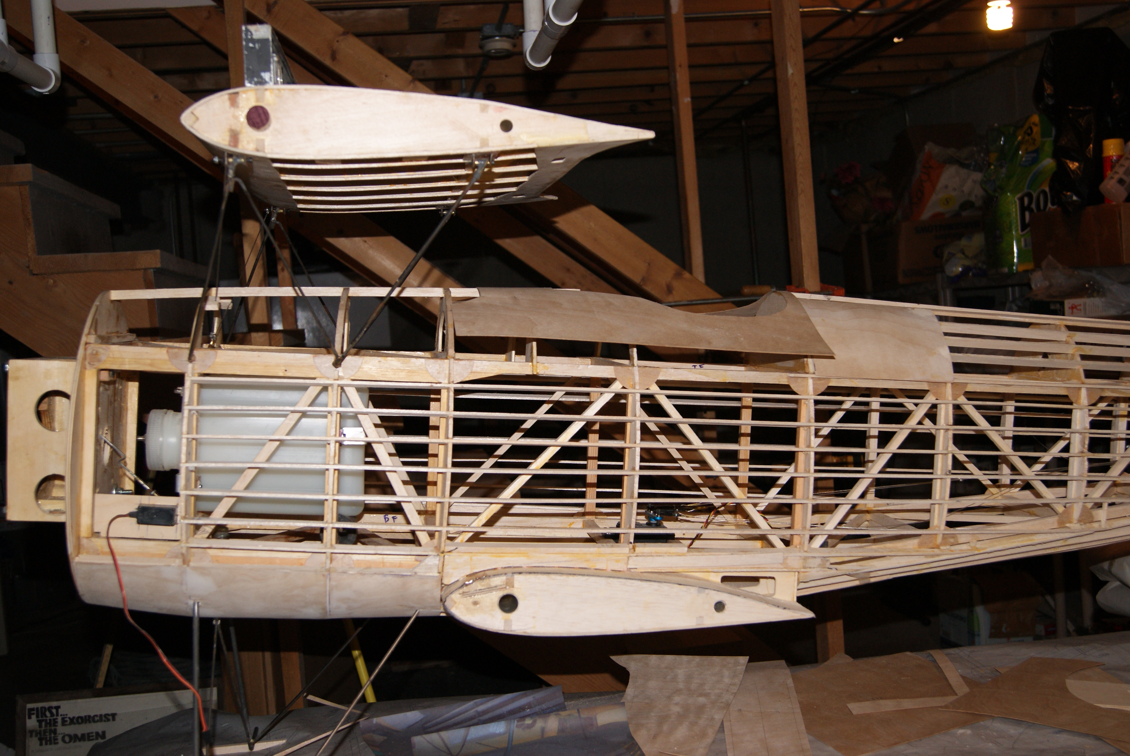

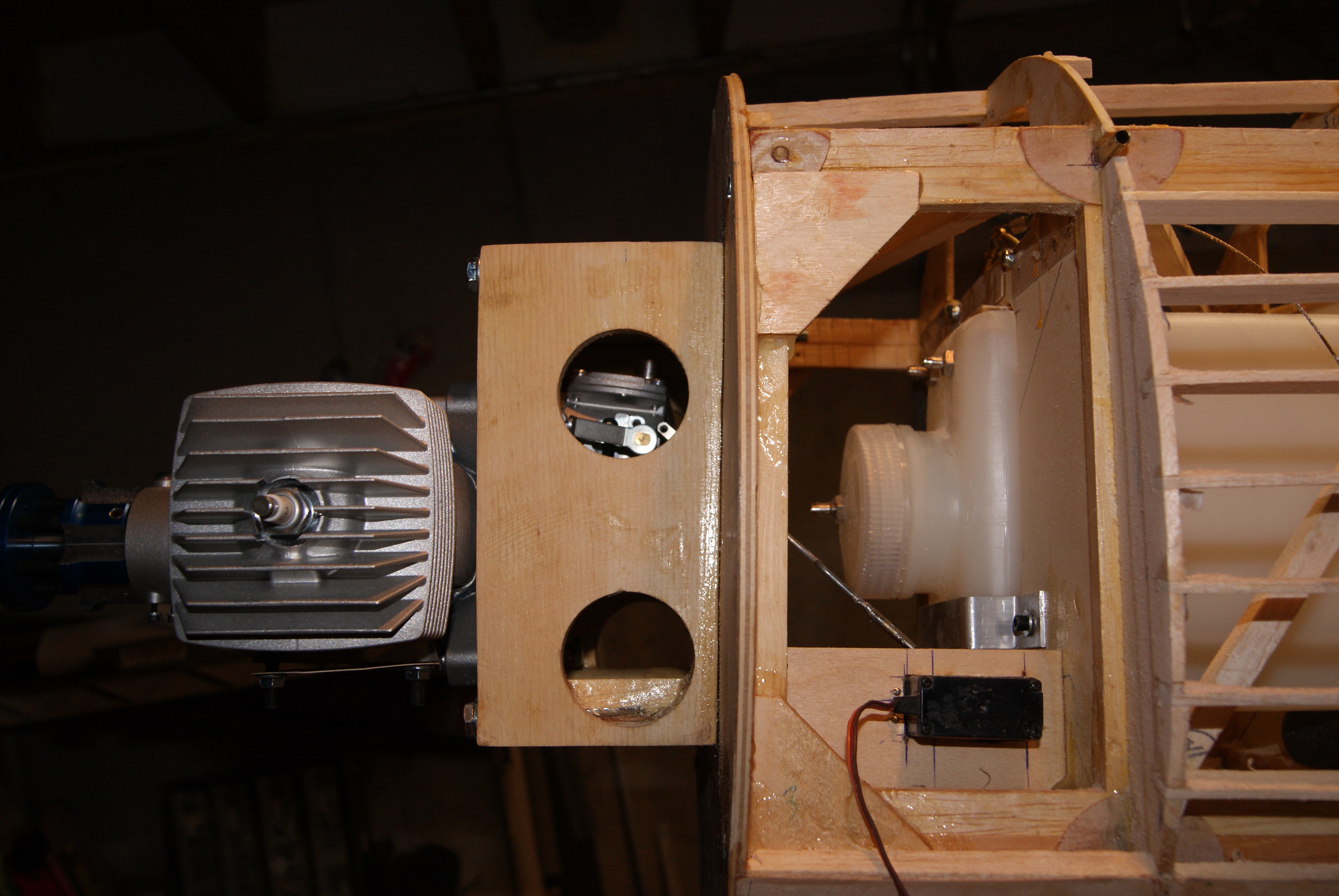

Here are a few photos. Hard to see but in the left view through the engine box hole, the choke lever is horizontal, throttle linkage is disconnected from pushrod. If the choke is needed I'll find a way to hook choke lever to another pushrod-servo. Big plane and no space!!

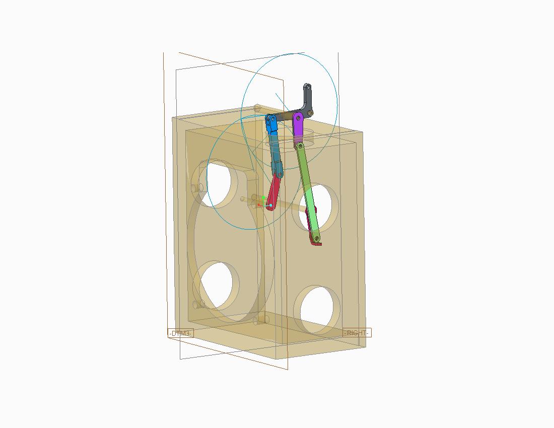

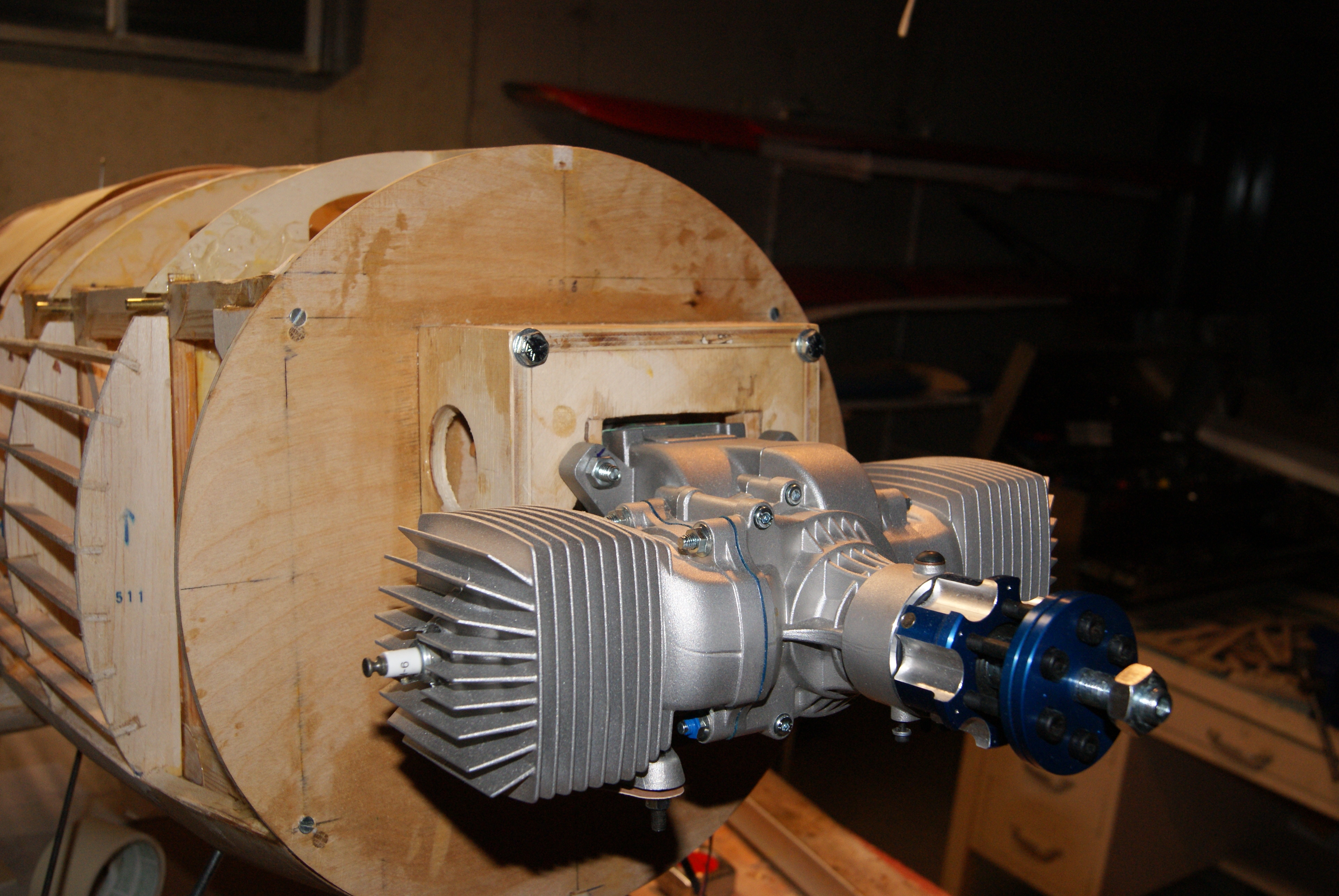

Looks like the replies so far indicate most don't use the feature. I could find a way to run a rod out. In the meantime I was not happy with throttle linkage so I did some doodling to move the servo. It was buried behind the firewall. Also made provision for choke servo if I go that way.First photo throttle linkage before change. Second photo mechanism for both throttle and choke. Drag link and bellcrank for throttle. Link from arm to servo for choke. Third photo mocked up.No I won't use a wood bellcrank. And I do like the servos hidden inside fuse, but the linkage to make it work is not too great and it's not easy to get at.
