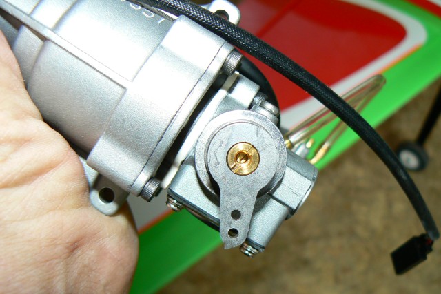

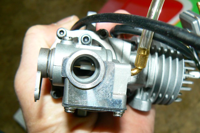

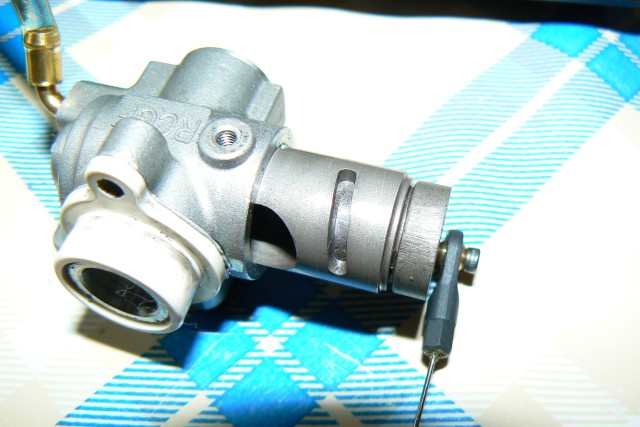

Elements of the carburetor.

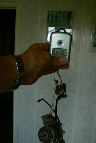

My engine had a weight

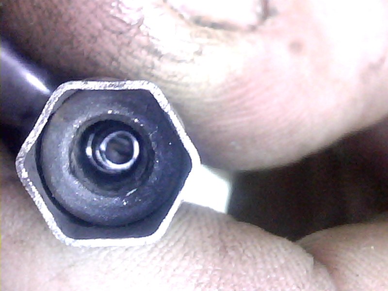

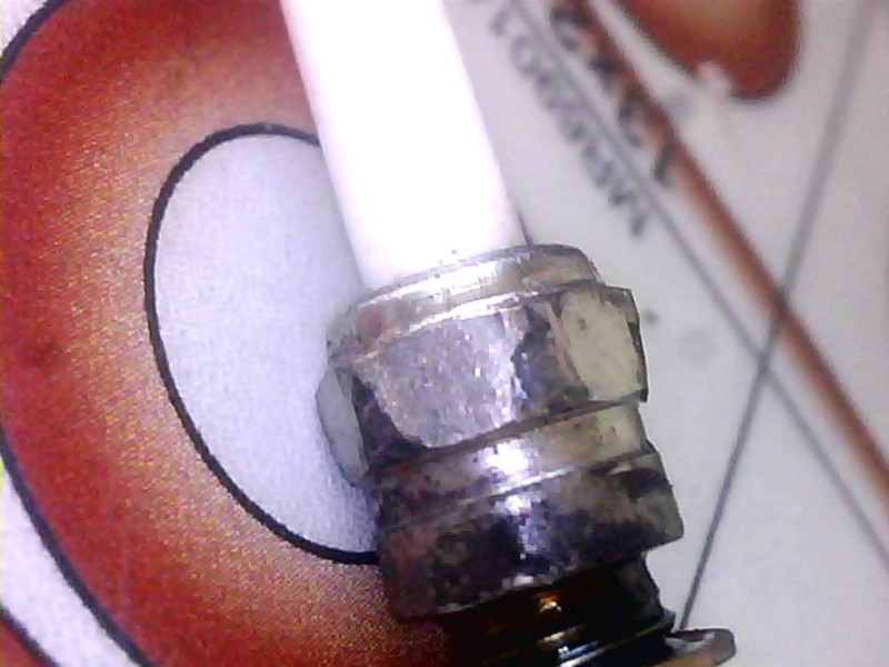

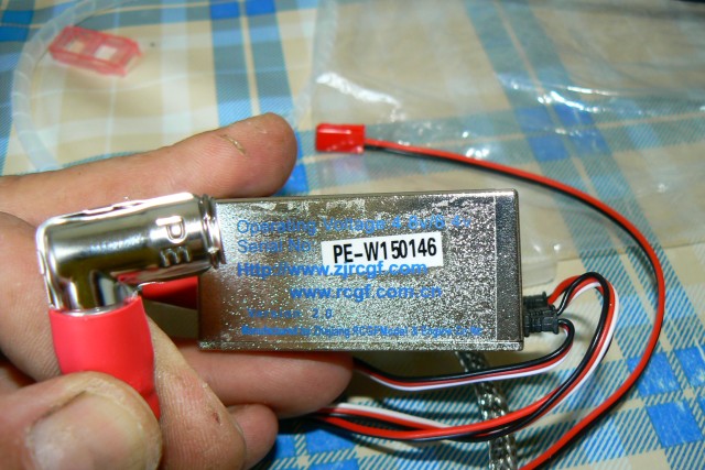

When there was the option of buying this engine I liked the spark plug cap.
I respect this manufacturer for the correct solution.

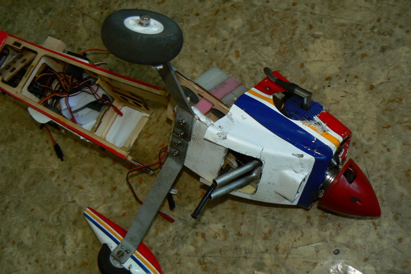

I had a crash in the Evo-10 because of their silly attitude to the reliability of the product -
I am grateful RCGF they took care of the safe operation of the engine.
Many times well done !!!!

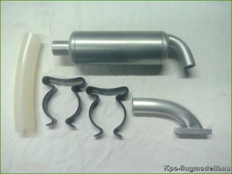

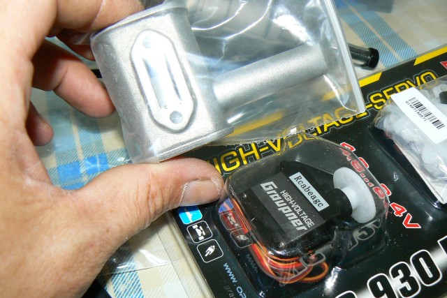

The muffler is very light.
But on sale, there are special silencer (Its price is unduly inflated.).
http://www.kpo-flugmodellbau.net/

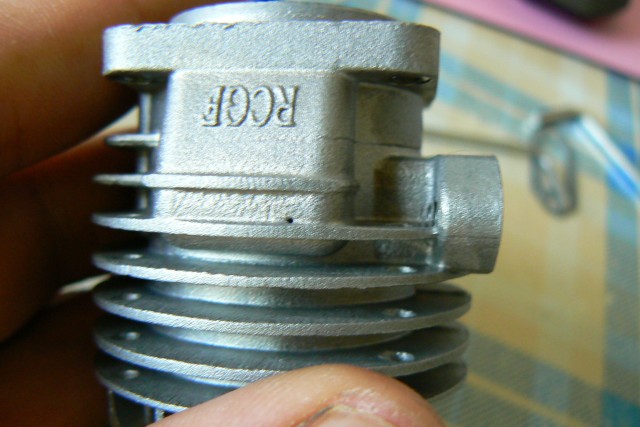

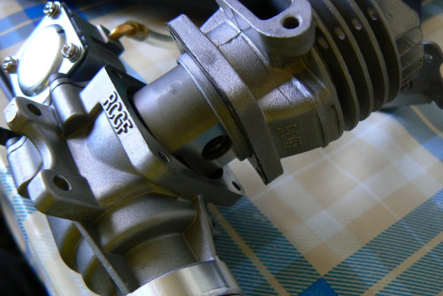

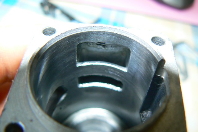

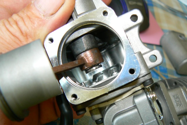

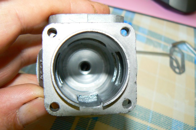

Some photos it looks like the engine inside (I will not comment).........

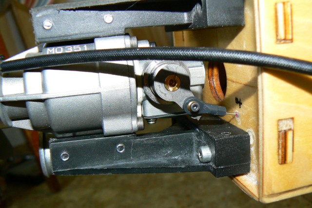

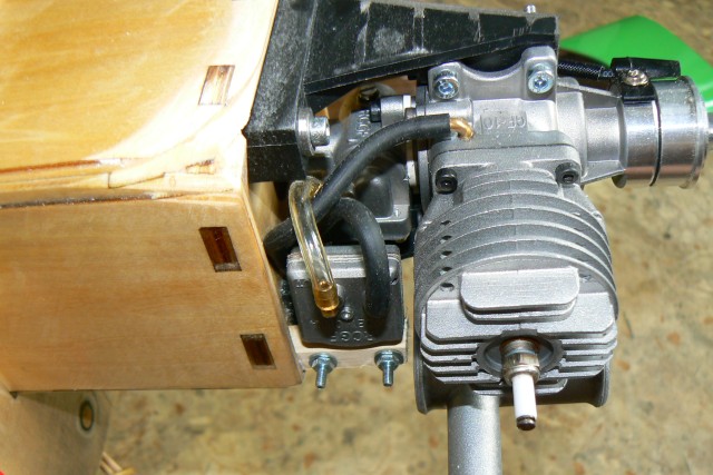

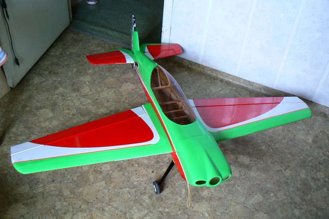

For the engine has prepared this model.

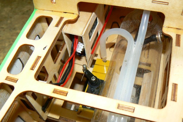

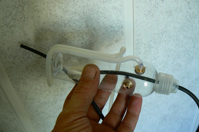

Did the fuel tank

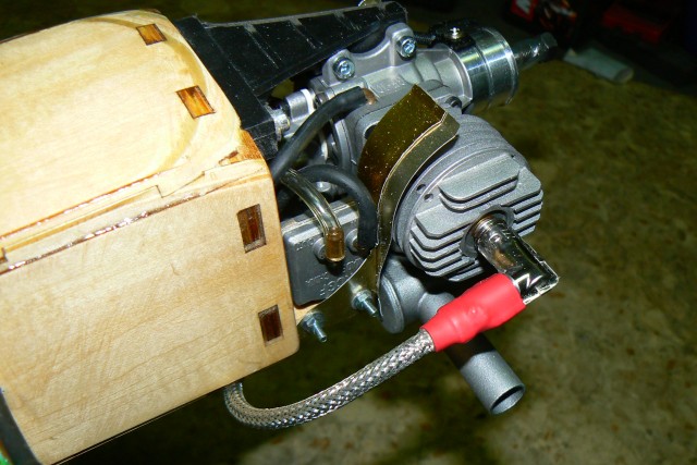

And so established -
I was afraid that the fuel pump will heat up.
Did the heat deflector.
And the first launch of the engine.

During operation detected flaw.
When setting the carburetor aluminum damper clench in the groove fixation.
The reason - the need to chamfer.
Because when you adjust the needle, hitting transmitted and screw fixing groove smashes.
