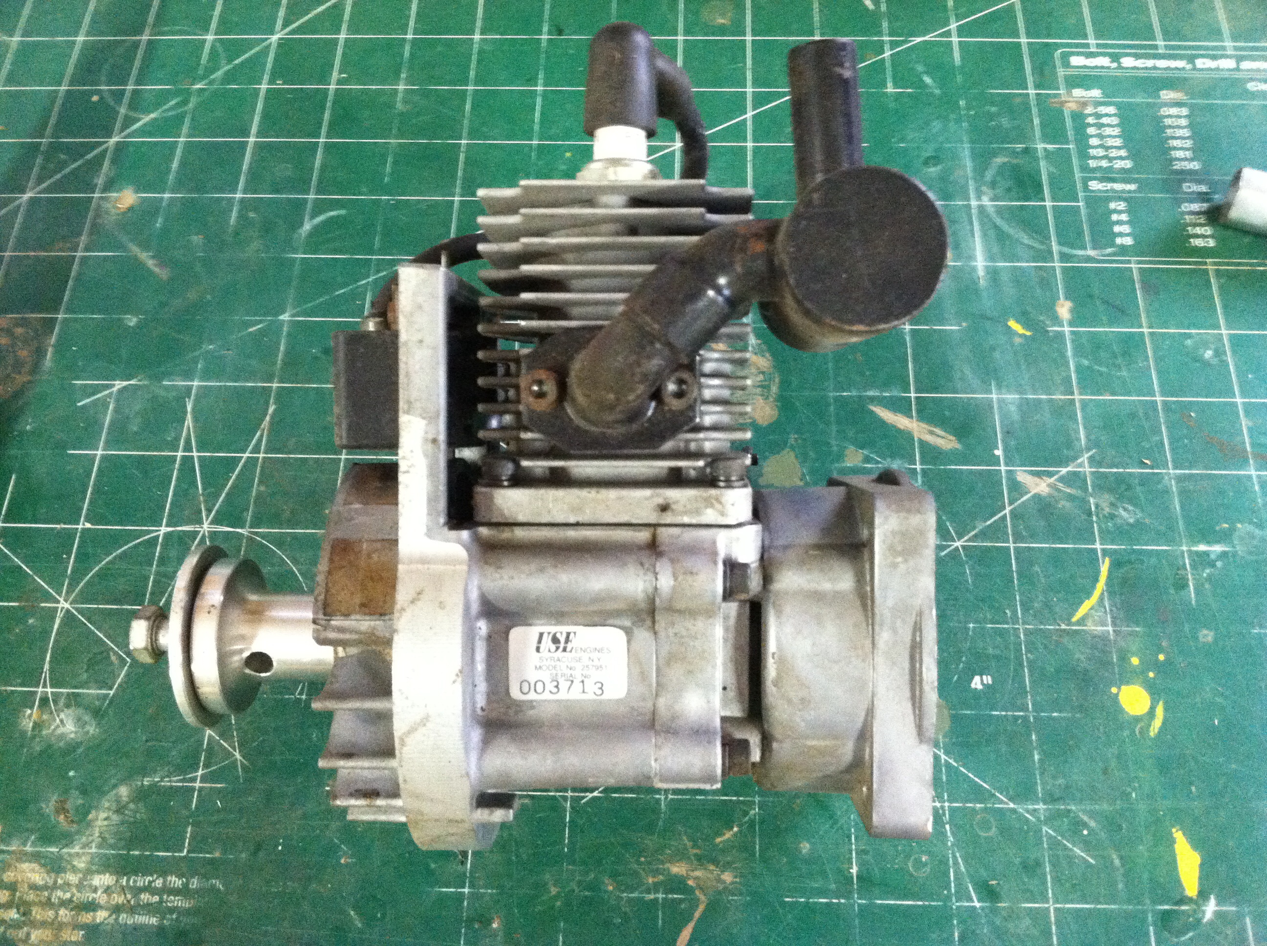

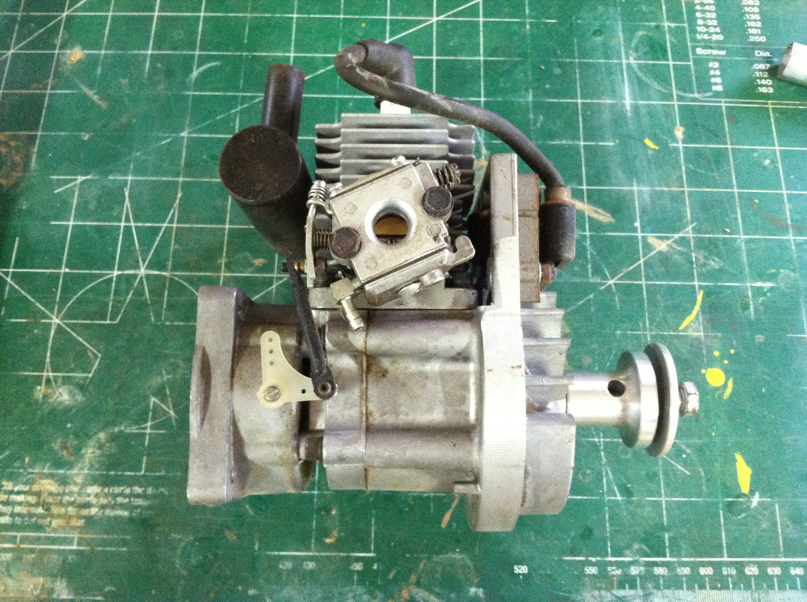

Can someone help identify these 2 engines? the last pic is a Quadra35 or 40 Quadra. Has a 18x8 prop on it. Serial # is 40402.
the other 2 pics are a us engine but don't know what size, serial # 003713. Looks to be about the same size as the Quadra.

Picture 3 of 4 is a Quadra or a US Engines 35cc or 41cc engine as both had rear exhausts.
Pictures 1 of 4 and 2 of 4 are a US Engines 25cc as they had a side exhaust.

Ok thanks. I know that it is a Quadra as it has a sticker on the side of the case, is There anyway to tell if is a 35 or 40? I wasn't aware that US Engines made a 25cc. Only heard of the 35 and 41.

The US 25cc was not the greatest performer so don't expect a lot from it.
