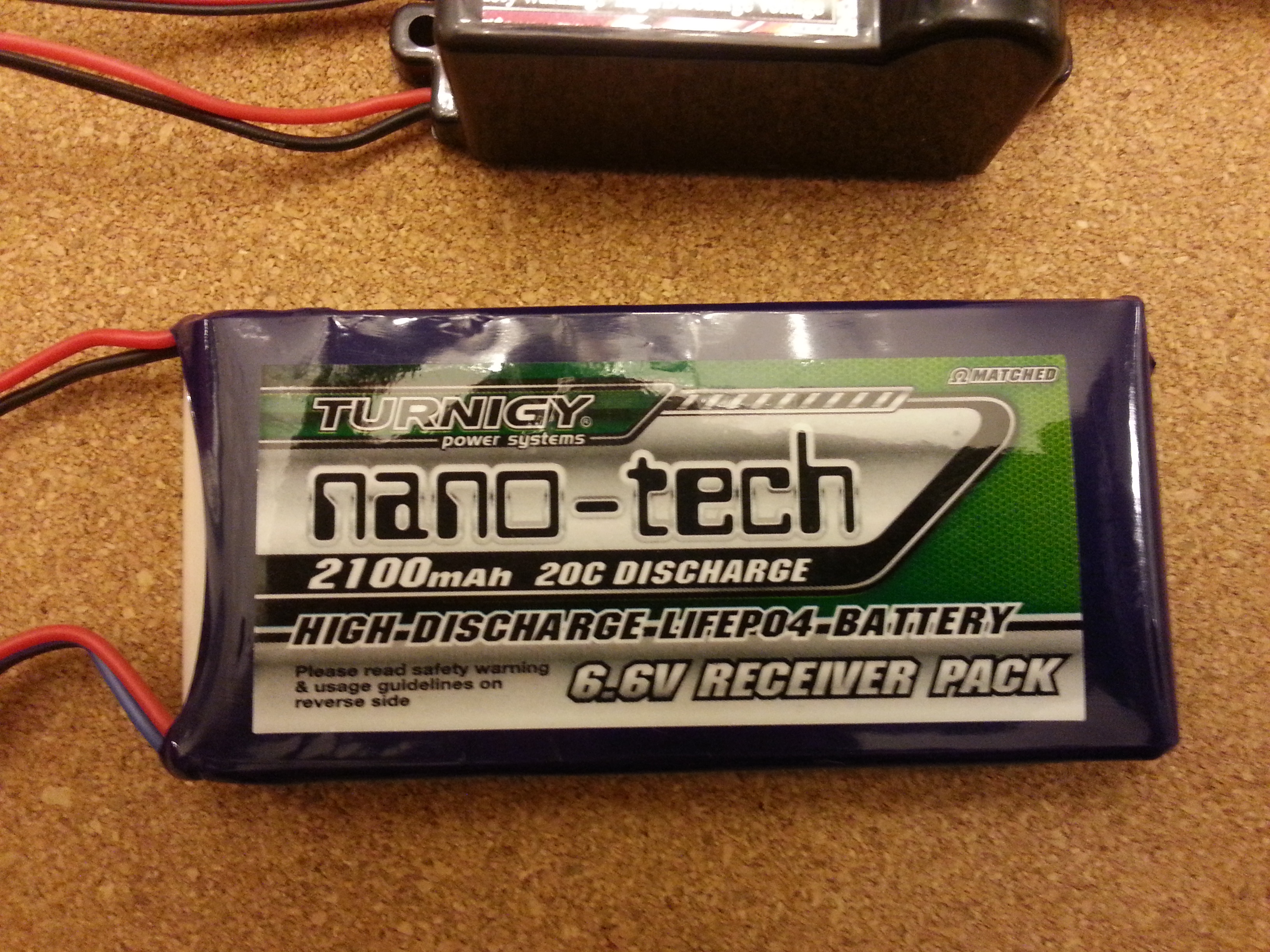

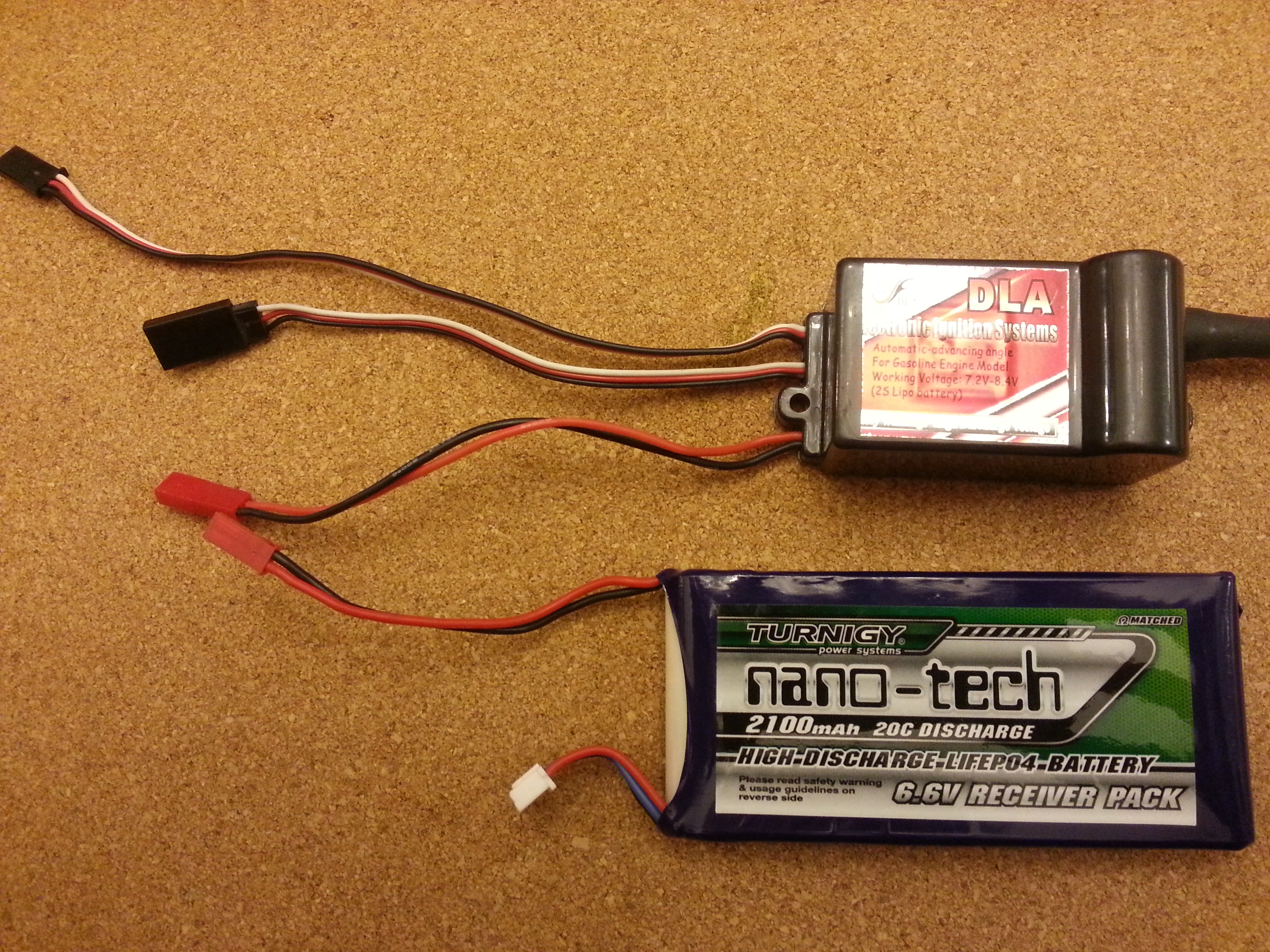

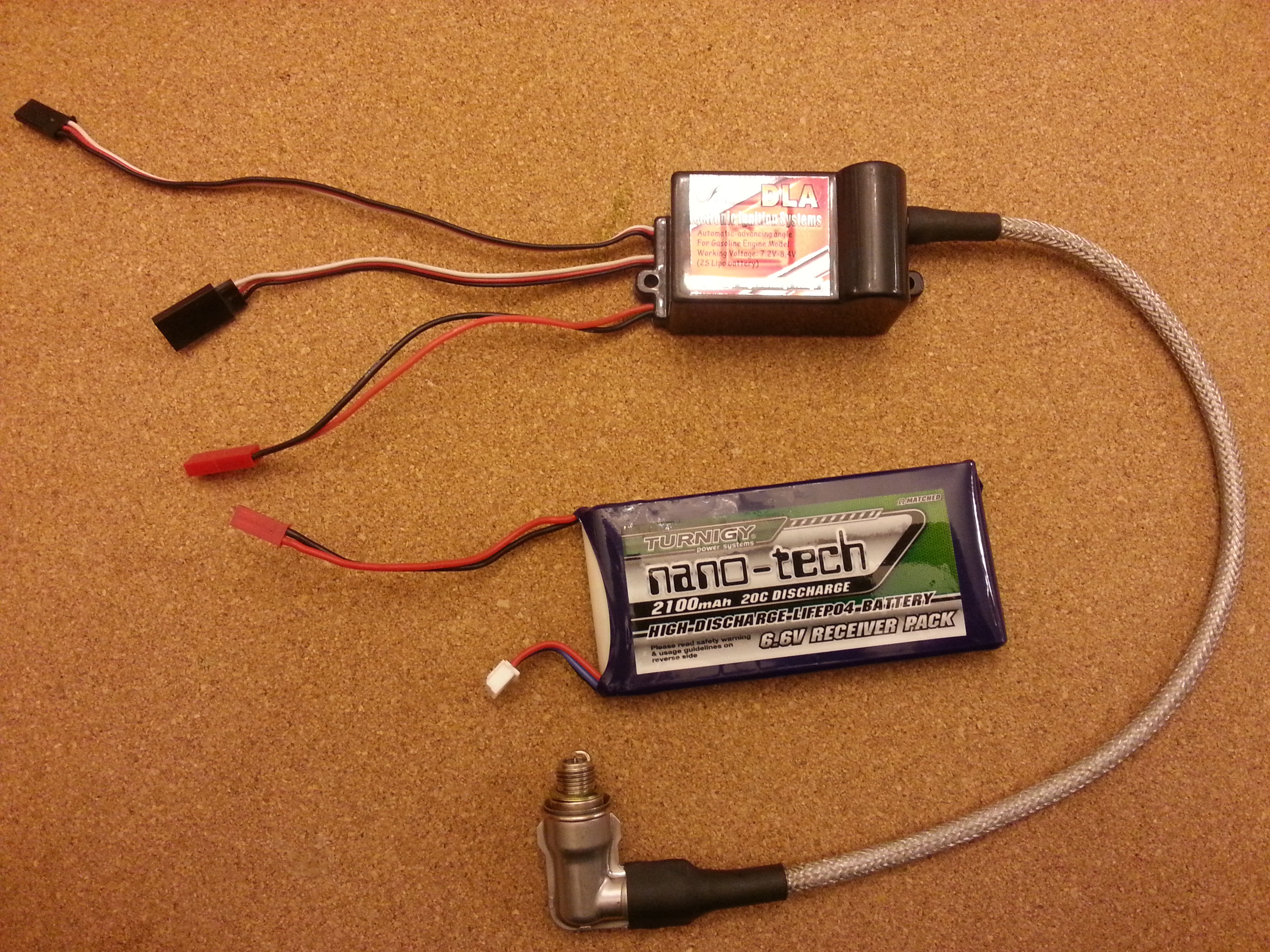

I have this DLA ignition and LiFe 2S 6.6V.
Can please tell me how to connect these wires ?
I connected top wire(futaba male) to the haul sensor.
Then connected red plug to the battery.
I didn't connect the middle one.
Then, I turned the craftshaft and I don't see any spark at the spark plug.
Can please any one help ?
Jake

Access the sensor leads from the ignition and with ignition on, short the white wire to the black wire momentarily. Should get a spark. If not generally the ignition unit is defective, assuming good battery supply. If you get a spark, hall sensor is defective, or sensor to magnet gap is too great. Good luck, red
Old 01-26-2014 | 04:55 AM
Banned
Joined: Jun 2010
Posts: 160
From: https://t.me/pump_upp
if i read it correctly it will not work with 6.6v.
try lipo 7.4 it will make it work
ilan
Old 01-26-2014 | 08:10 AM
BarracudaHockey's Avatar
My Feedback: (11)
Joined: Jul 2003
Posts: 28,284
Received 444 Likes on 363 Posts
From: Jacksonville, FL
Some ignitions require a minimum RPM to spark. A good healthy flip is required versus just passing the sensor over the magnet
