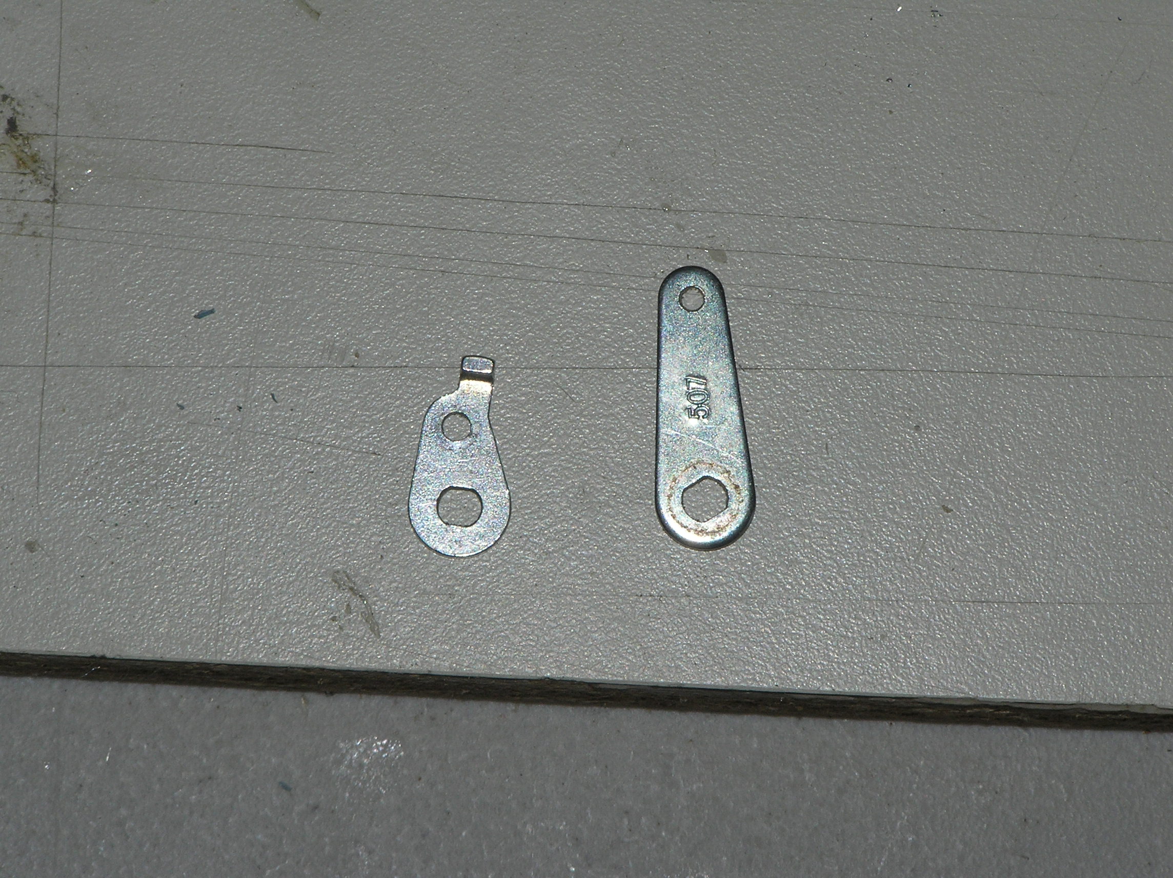

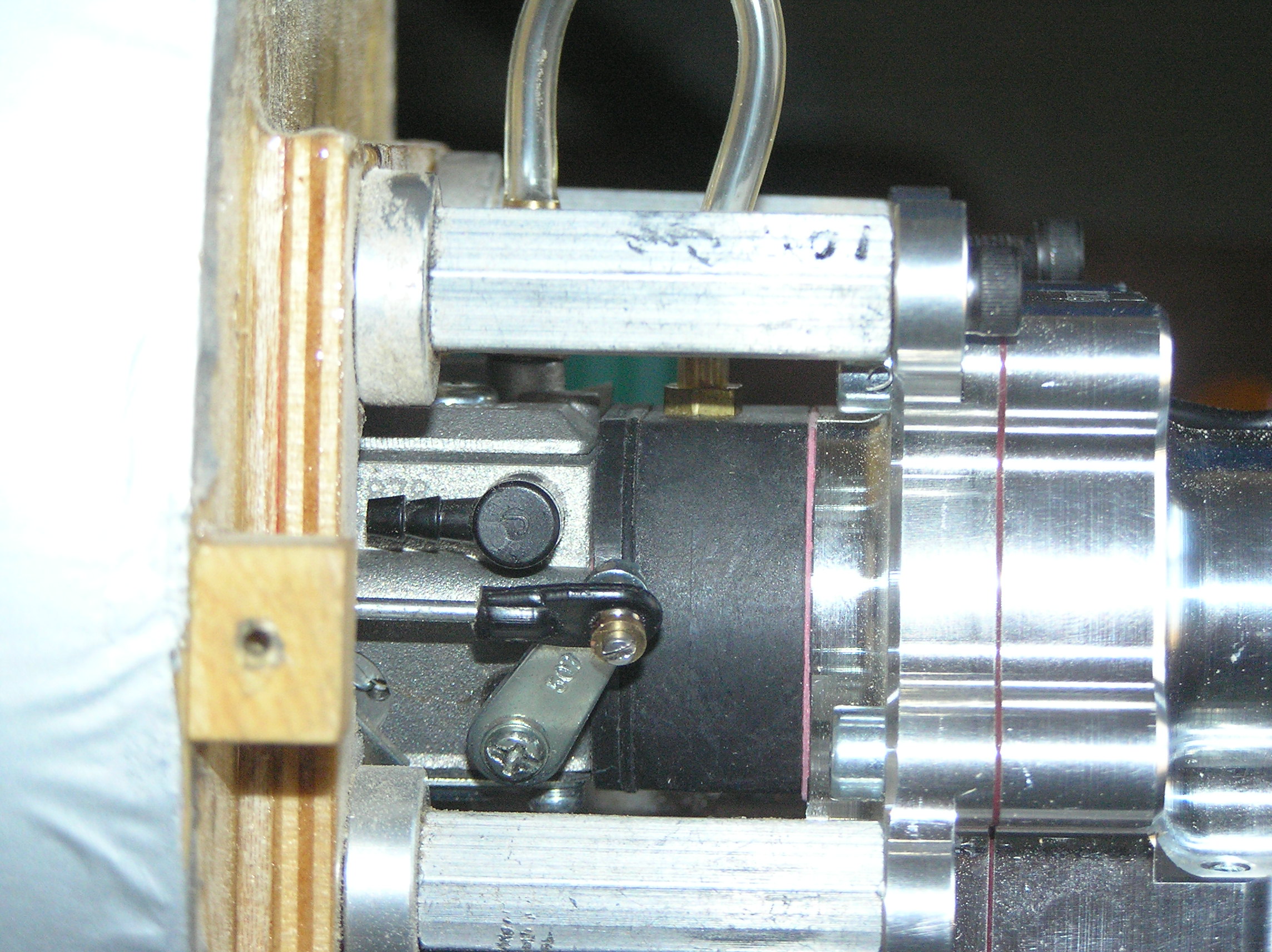

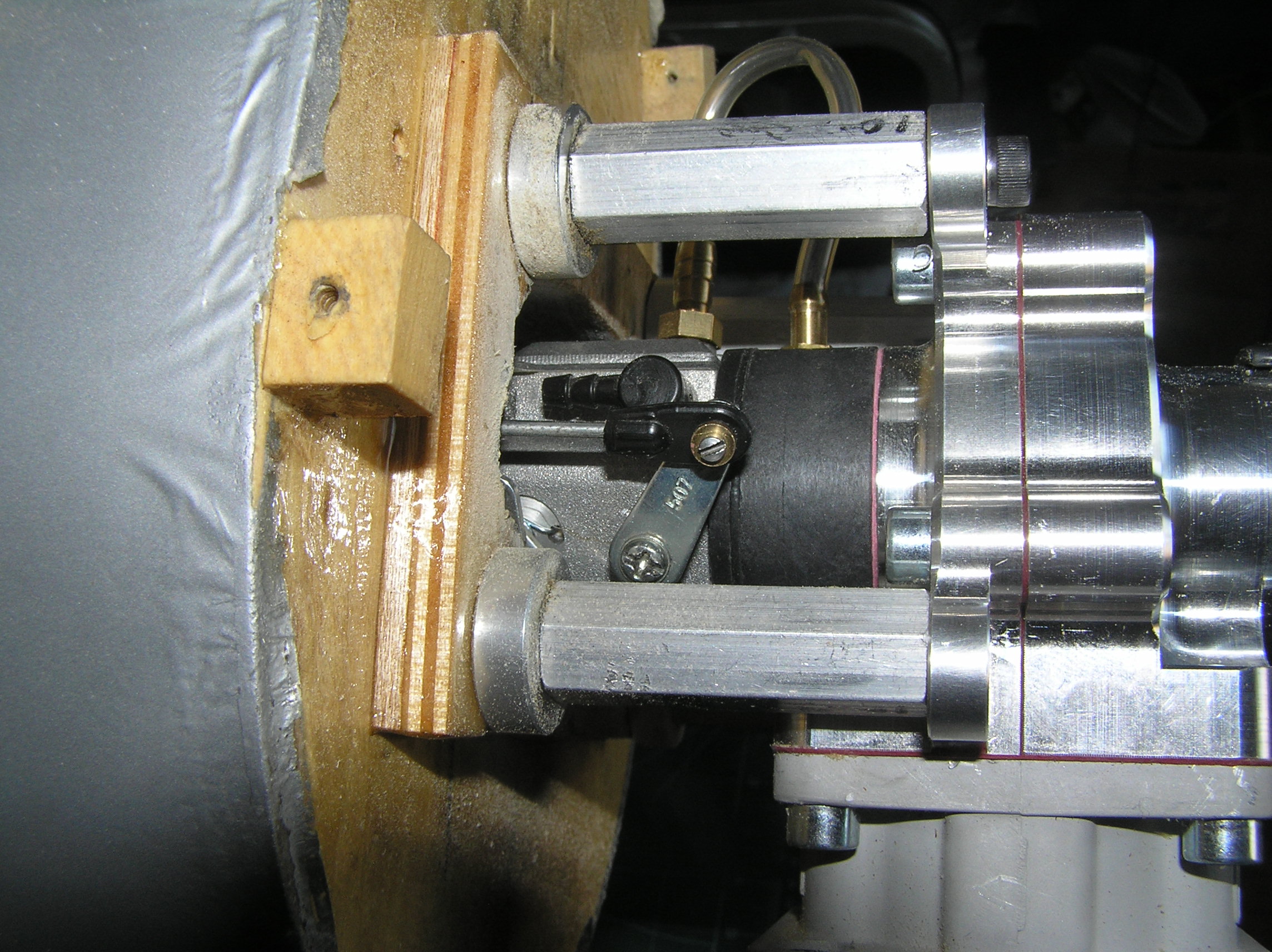

Default Throttle arm
I am sad to report due to the firewall being in the way, the choke will not be used BUT by using a cut down ball-link, and a new arm, I got the throttle to work smoothly. The spring was removed and a 2.-56 threaded rod was used for the throttle. The first two pics show the problem with the supplied (short) arm, then notice in pic 3 the center hole on the larger arm. This permitted the arm to be more forward resulting in a straight push/pull with almost no vertical change. Last two pics are the final placement of the arm on the carb. Notice where the choke arm is now located - inside the fuselage and firewall.
That choke requires a 90 degree push to close the choke - and that push must come directly from above or below - ugh - maybe a 90 degree bellcrank resulting a push/pull to a up/down movement?
Anyway here are some pics....

Tailskid, it sounds like you removed the spring that opens the choke and also removed the mechanism that forces the throttle in to a fixed position when the choke is engaged. You can use another servo to open and close the choke or setup some kind of manual operation. Without the dedent in the choke shaft a manual operation will have to include some kind of friction device to hold the choke in position. Is that what you are going to do? Dan.

I haven't removed the spring from the choke - yet - but the choke arm is inside the fuse and next to the firewall....darn, we just might have to go without a choke on this one

Looks like the arm could be replaced to make it a little longer. I have started putting servos on my chokes, and love it. Having all of the control on the TX is very nice. Otherwise, I really like using a Golden rod cable for the linkage. I run them back to a hatch on the sides of my planes, sort of a control panel, with all of the other switches and such in there.
On my last install, a DLE 55 on a GP Ultimate bipe. I removed the detent ball so the choke would swing freely, and I put a servo on it. Works great.
