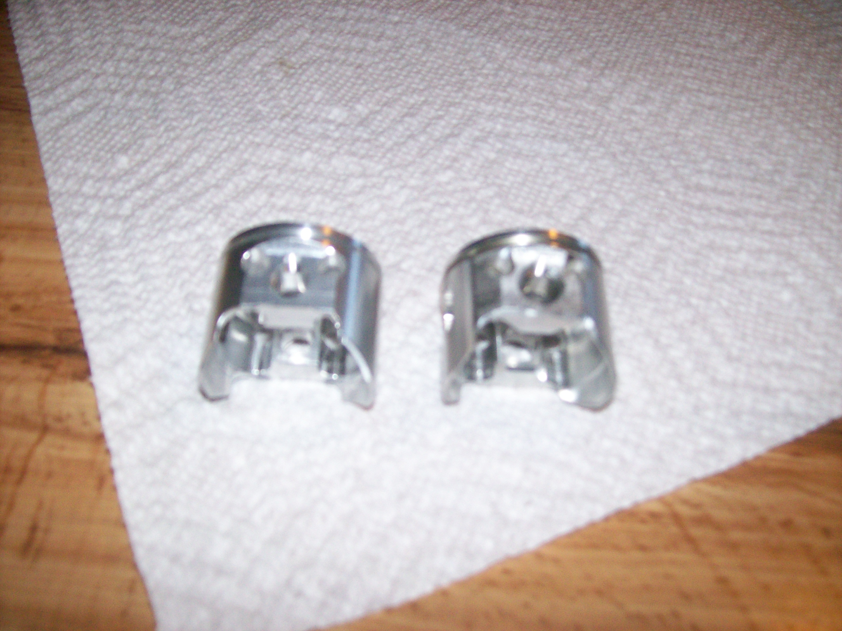

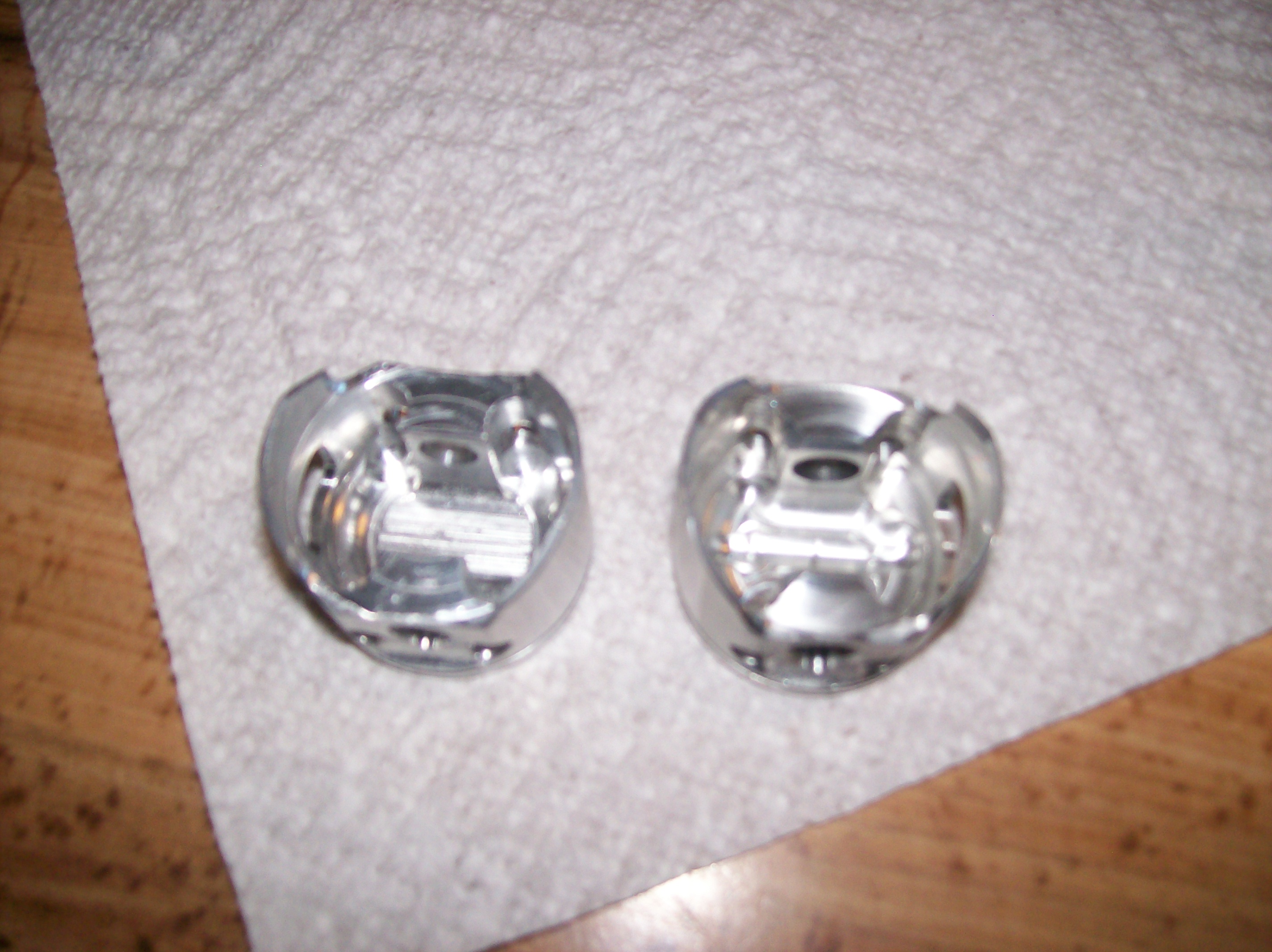

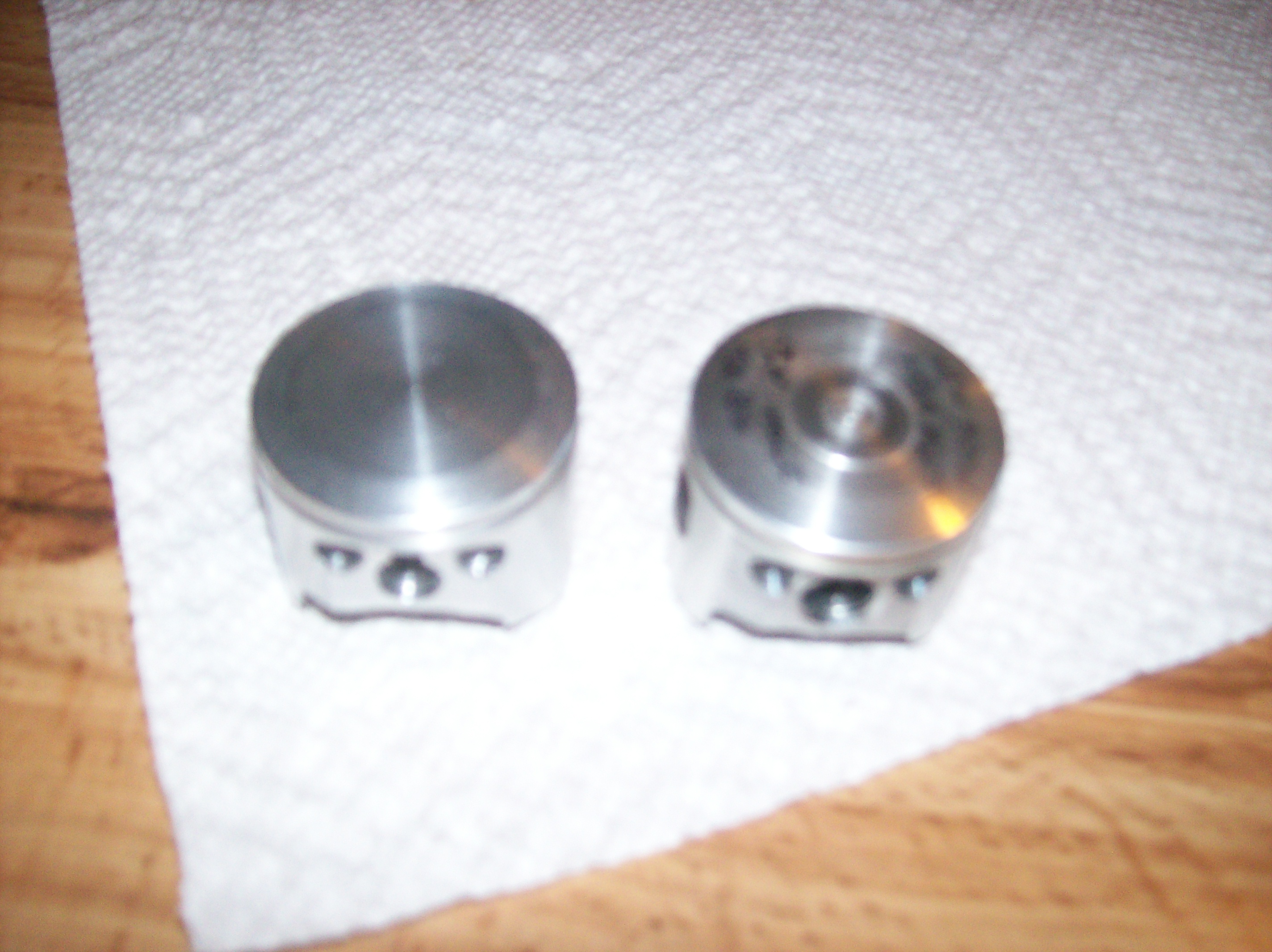

I hope I did these right, Anyway here is the next 22 Mintor piston I made, I need to make at least one more 22. I hope the shots are somewhat clearer than the others I didAs soon as I get the lock pins it will be ready to ship. The material should be here tomorrow for the 33's but I am going fishing so I won't get started until Thursday unless I decide to go back *LOL*

What rings will you be fitting to the new pistons and are the weights of the stock pistons and the ones you machine the same ?

I never weighed them, I did think about it, but really who cares as long as it works.
As far as rings, your guess is as good as mine, for my own engine's if push come to shove I will make my own, if Frank doesn't make them.
Lucky for me I don't own one of these fine BA and so far I have not had an issue getting rings from Frank in the past.

I went out and weighed my piston against the new Mintor piston this morning, they were the same weight gram for gram. I knew they would have to be close and even if they were off slightly,it wouldn't be enough to harm the balance any.

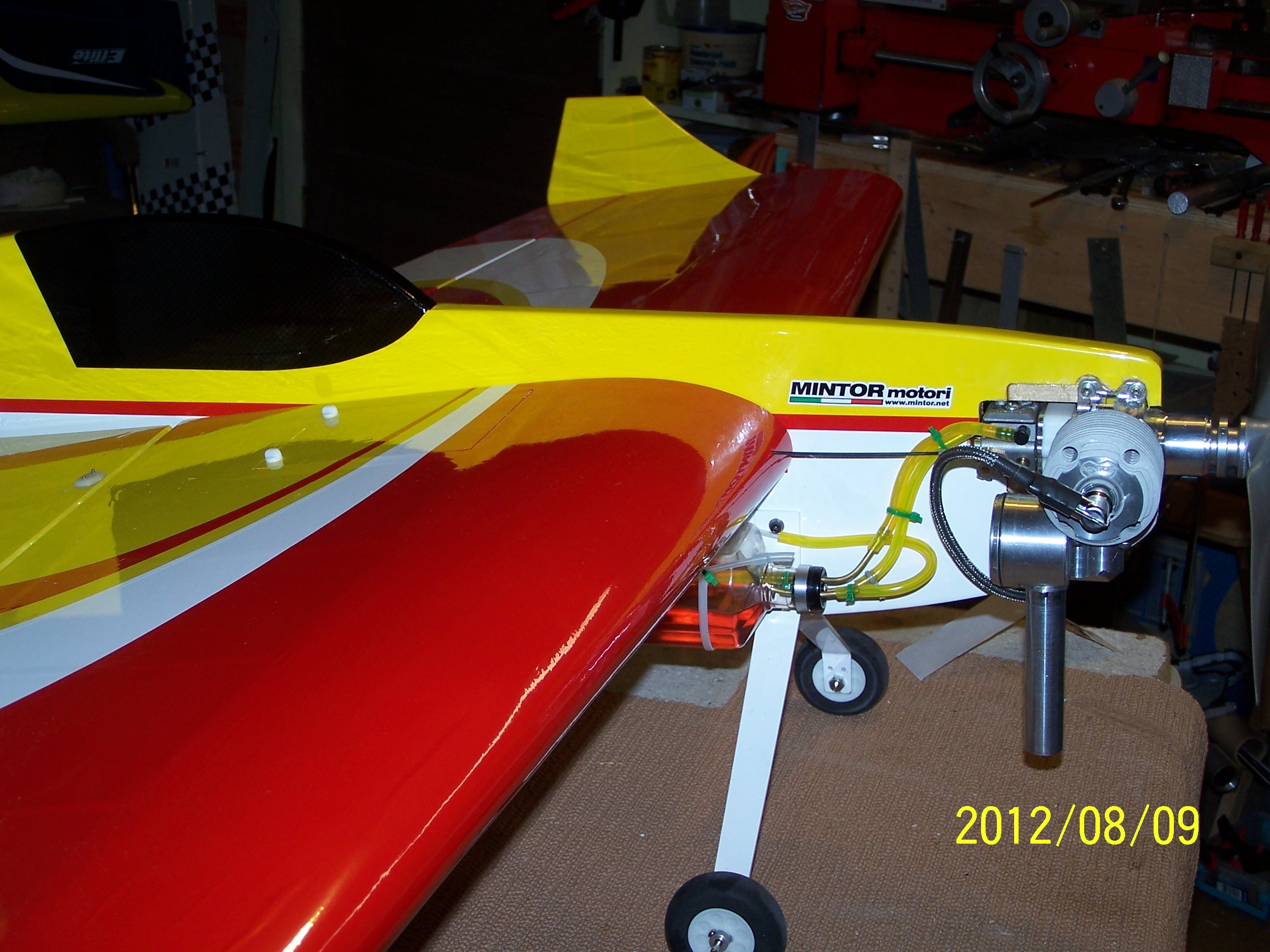

The Mintor 22cc engine I have works good on the Pro 260. Maybe too much power as high speeds will take it out of site fast.
