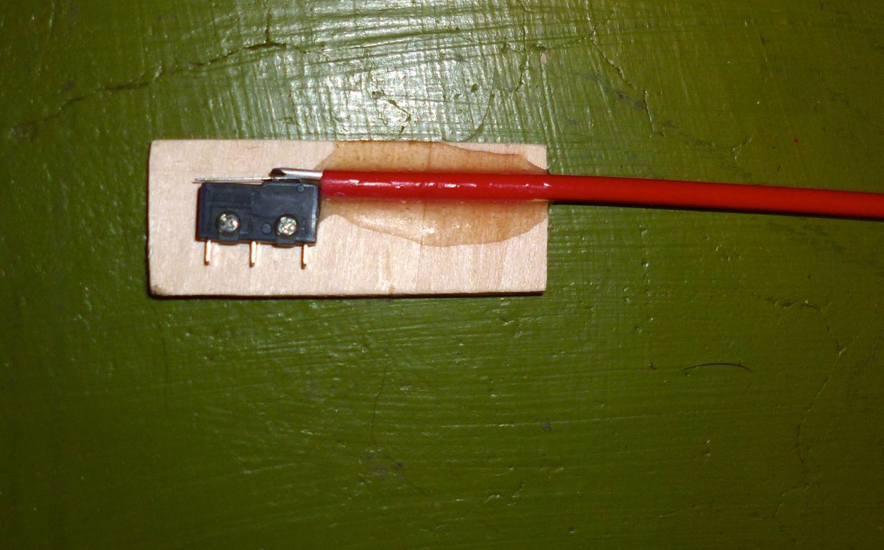

Here is what I used on my last build using a microswitch activated by a non-conductive flex rod from a small servo. Total isolation of the electronics which is nice. Radio Shack has the micro switches or you could order them from any electronics supplier. Keeps all the noise from your ignition system from coupling into the receiver circuitry.
Name:	Ignition Cut Off Switch.jpg
