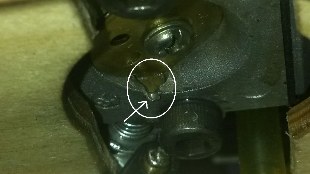

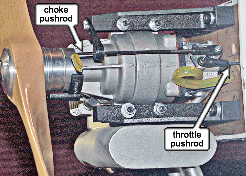

also please advise on my choke situation... look at pic, you see the groove there? its been grinding a groove
when I am not using choke because probably vibrating... now I have to have cowling off and push up from bottom
to get the golden plate up and over the groove to fully close air flow...
it was very difficult for me to mount a horn to choke it being a rear mounted and not side mount carb... the horn
also jumps off then I have to take my cowling off etc to put it back on...
do you have some pics or ideas as to how you mounted and get to choke yours? should that groove be there?
thanks

I don't know what would be causing that grove. Is the screw tight on the choke plate? when you open the choke can you move the choke plate If you can then your screw is loose I would take the screw out making sure the plate stays the same and use lock tight on the screw, As far as my choke I have A servo mounted and I use A ball and socket on the choke arm I use it to choke the engine to start and kill the engine if something goes wrong. I use channel 5 on my radio and adjust the end point to set the throw I will try and get A picture of my set up In fact let me take A picture of the one I am working on now Its A dle 30 but should get the idea its a rear carb

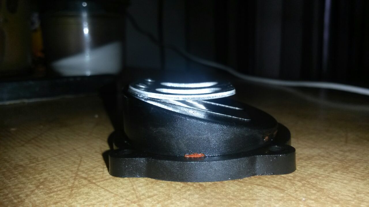

sounds like you have an air leak. Check the carb gasket and the heat dam gasket any tear in those places will cause the carb not to draw fuel. A good way to check is to close the choke and rock the prop back and forth on the compression side and see if it draws fuel from the tank if it does stop rocking the prop and see what the fuel in the line is doing is it staying there or is it going back to the tank I just went thru this this weekend turned out to be the carb base gasket had a small tear around the mounting hole and make sure that your little holes in the gasket line up with the hole in the heat dame and the carb that is your pulse port which creates vacuum to operate the the carb fuel pump look at the diagram I sent IT does not show the heat dam Its the plastic piece the carb bolts to should have A gasket under it and one for the carb Michael
Joined: Dec 2008
Posts: 780
From: Bremen, Germany
i've sealed now everything with gasket glue, I even took off the backplate and cleaned the reed valves... sealed the back plate up again, got a new gasket for the carb where its mounted on the engine... if after this it doesn't pump fuel its helping me start a fire on friday night!
Joined: Dec 2008
Posts: 780
no they aint, is that a problem? they are angled ... but I saw the problem now! it was so clear... after I fitted the carb with a new gasket and tightened it, I saw the carb was skew on the backplate... the one bolt I could turn it so tight it pulled it away from engine so not flush anymore as I could see also light pass through... I added some gasket glue to it, seems there's no light I can see pass through... else I would need to purchase a new backplate...
that would cause an air leak. is the gasket glue you are using fuel proof if not you might need a new back plate. and you don't need to screw the carb bolt down to tight just snug remember its plastic you are screwing into you can seal the back plate up with high temp (red) gasket sealer

the backplate has never been off, must have come like this with the engine... do you know where I can find spare parts for this engine online? I will phone the hobbyshop I got it from but I am not optimistic. I would like to get a new back plate in any case because the carburetor will never be flush now if I don't use gasket glue...
is it not fun it figure things out. This hobby makes a person think and in this day and age with all the computers and electronics we tend to forget the basics glad you got it running michael
