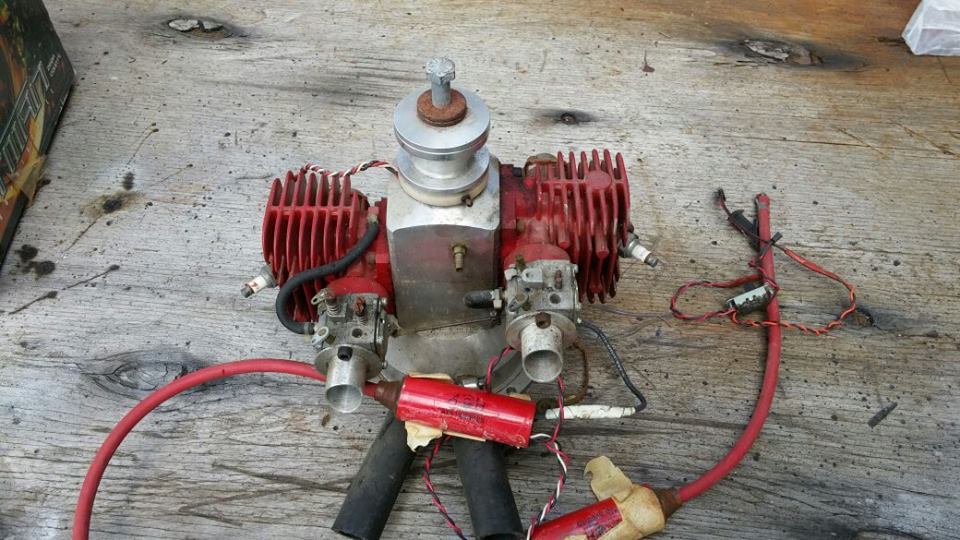

HELLO FRIENDS I HAVE THIS AIR HOBBIES twin engine, GIFT OF A FRIEND AND NOT HAVE MANY CC? SOMEONE HELP ME KNOW EXACTLY MOTOR IS. THX

In the cylinders have these R028131 150 a1

Looks like a 4.8 twin, (cylinders and pistons are 2.4 Sachs), but need to know the cylinder numbers to confirm.

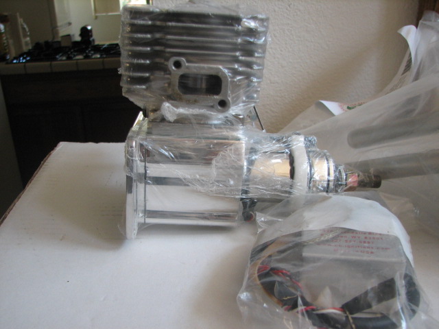

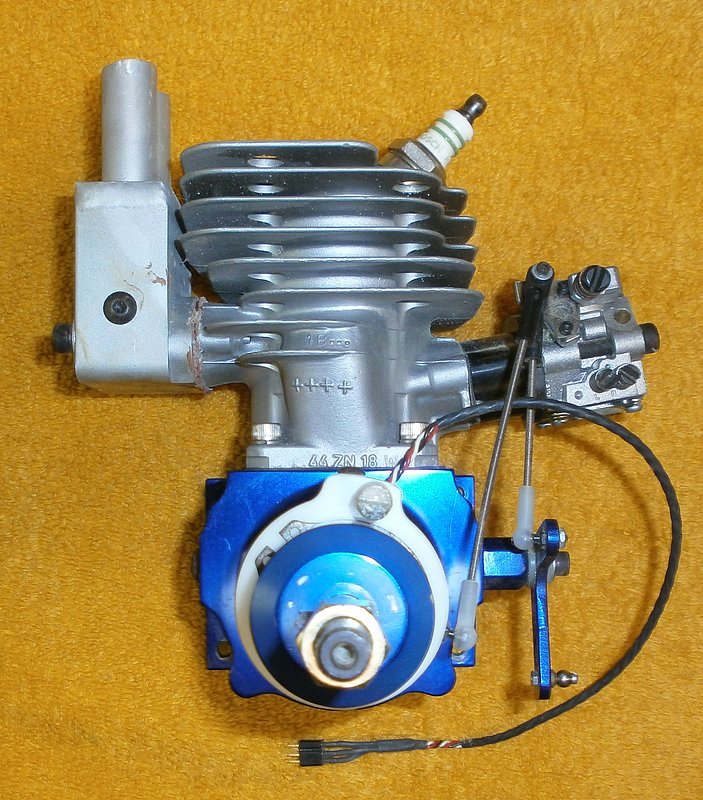

Usually on the base of the cylinder.
Here's an image of a 3.2. 44ZN 16 W 3 Mahle exhaust mounting holes are parallel
Check your muffler mount hole location
Image of a 2.4 cylinder
3.2 cylinder

Exhaust mounting holes are not parallel .It is the same engine as the post you sent me
will try to operate it.

I believe it to be a 4.8 80cc

80 cc then ok ya know how many hp is too no? . CK1...

I dont know what the actual HP is but I am sure that it will be a weak engine compared to any other of the same size.
Put a prop on it and bench test it. I wouls start with a 22x10 prop and work your way up from there if possible. I suspect you will need to put kits in those carbs and I would also replace the Ignition with an Rcexl or CH for reliability.

Already started the engine with a propeller 22x10 seems little power for a 80cc, but regulates and accelerates even I will keep trying with other helices and definitely will put cdi to see if it improves and is more reliable
