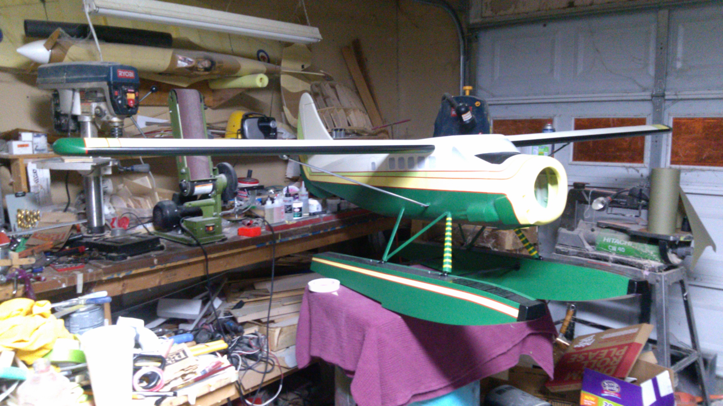

Bought a used, great compression BME 44. Can anyone tell me the preliminary needle settings. I can get it to pop but not run. Installed new ign., plug and carb looked clear and clean outside. I have started trying with 11/2 turns each screw. No luck! I'll pull off and open the carb last resort, just don't think thats the problem.

Success! Changed to a two blade prop and opened the throttle a little more and off she went. I shut her down and turned the screws in a little at a time and now it starts in a flip or two and idles well. Wow this engine is a beast. I've got it on my scratch built 8 ft. Otter. about 23 pounds filled and ready. I've got to find my hand tack it's on the bench somewhere and see the rpms at idle and full. I'll post them later.
