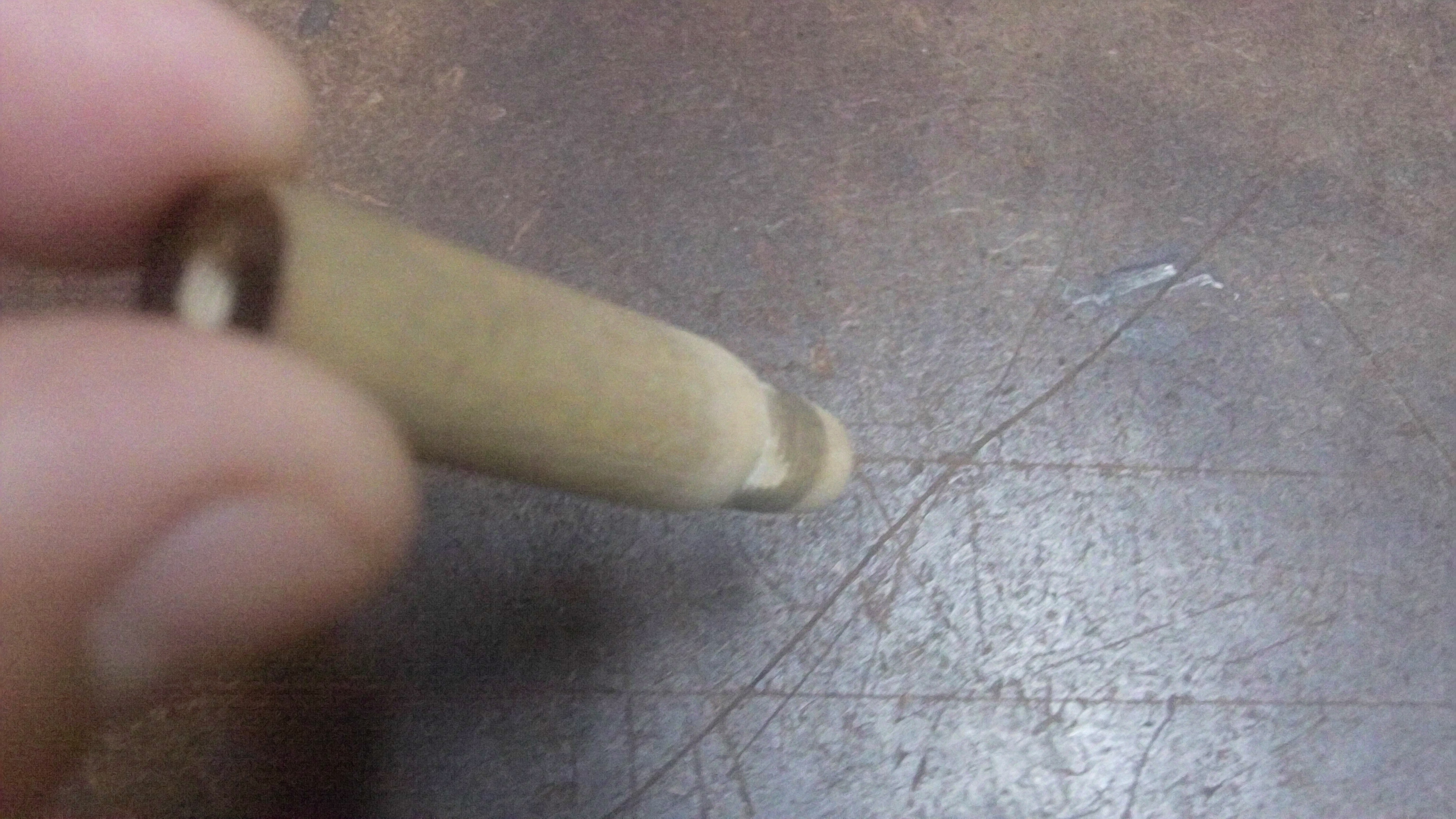

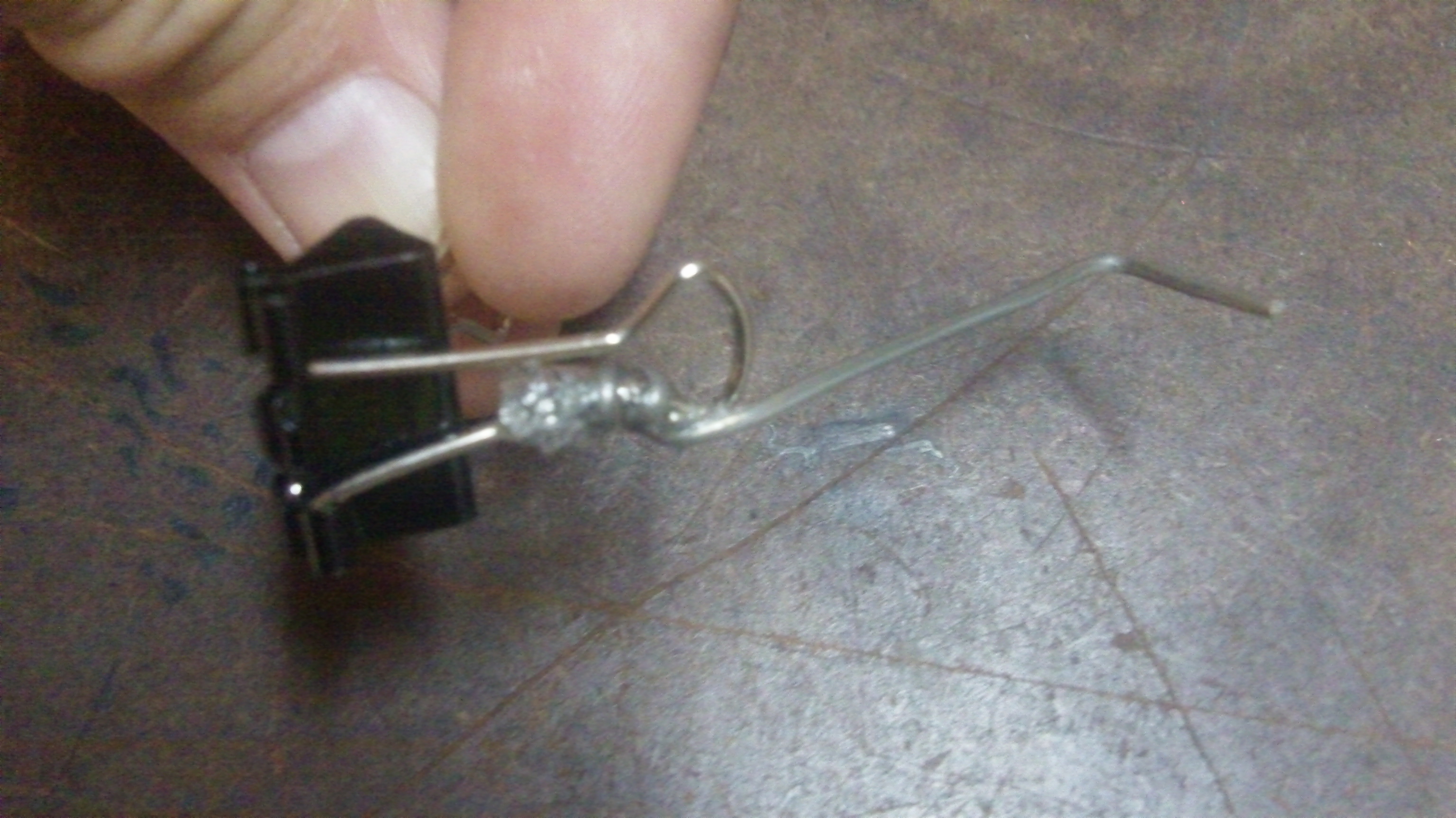

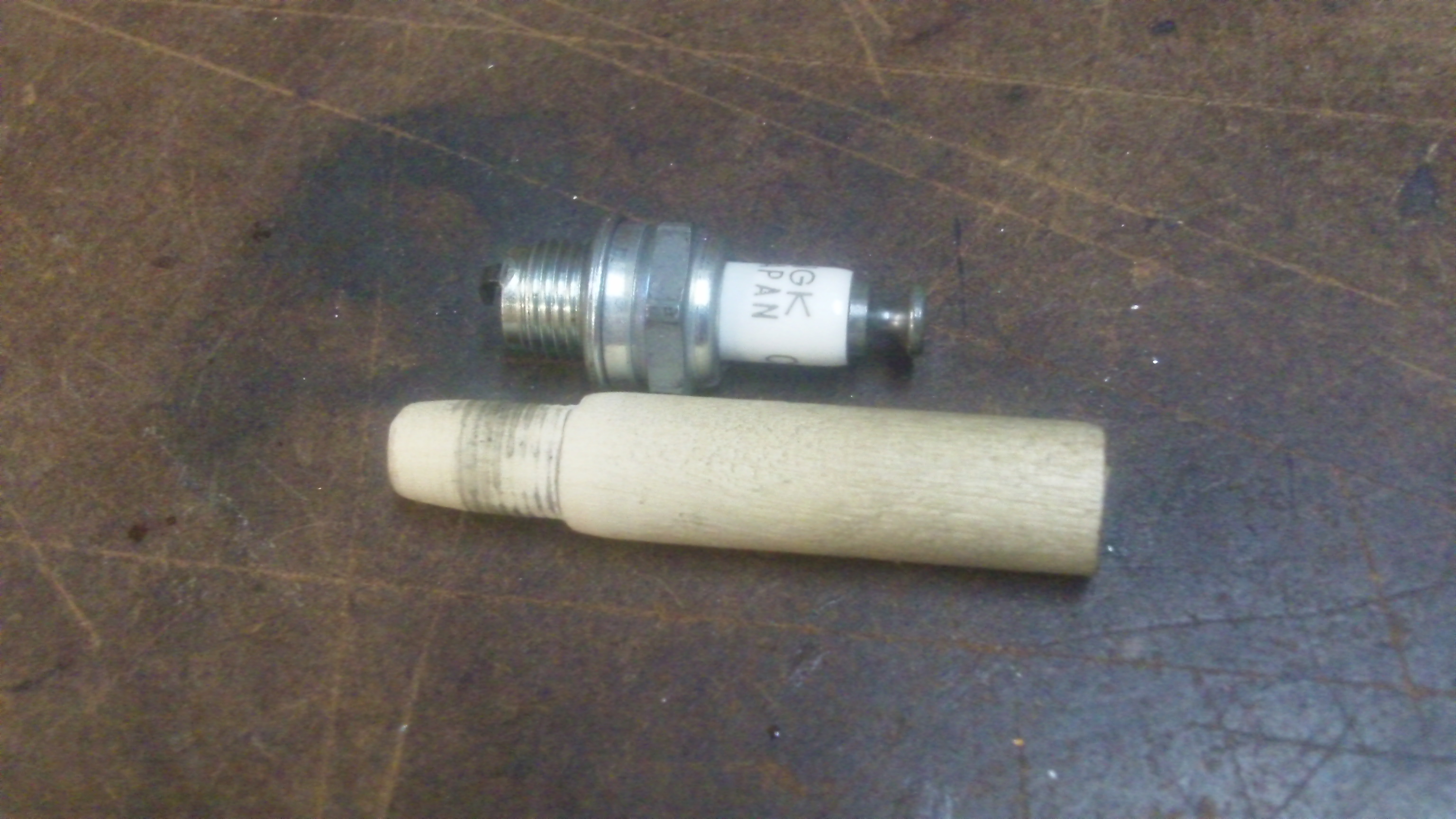

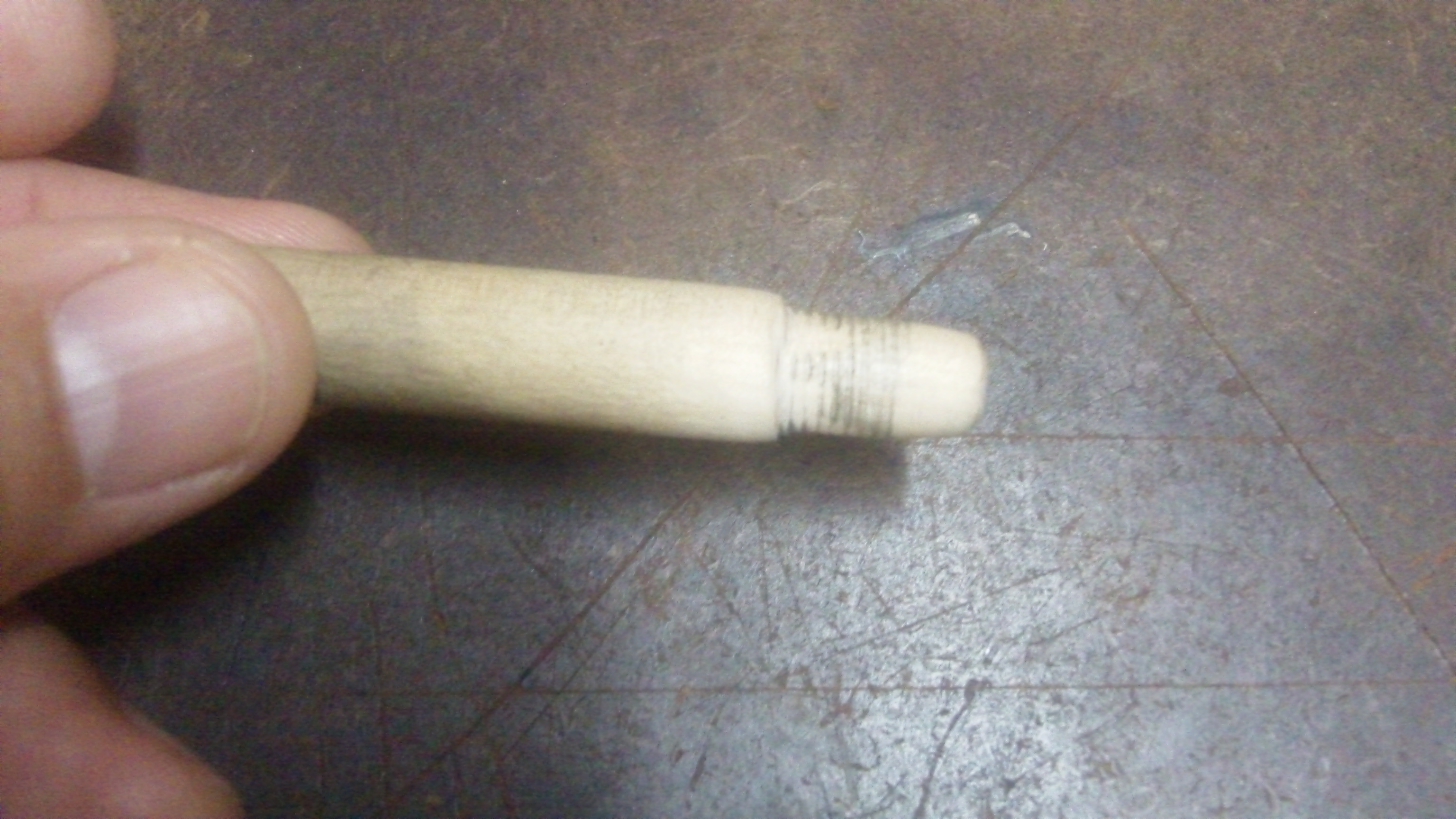

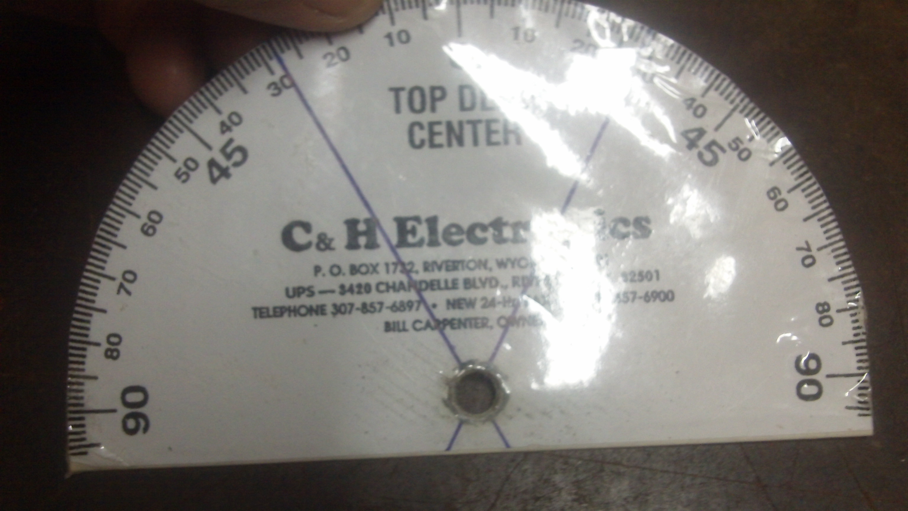

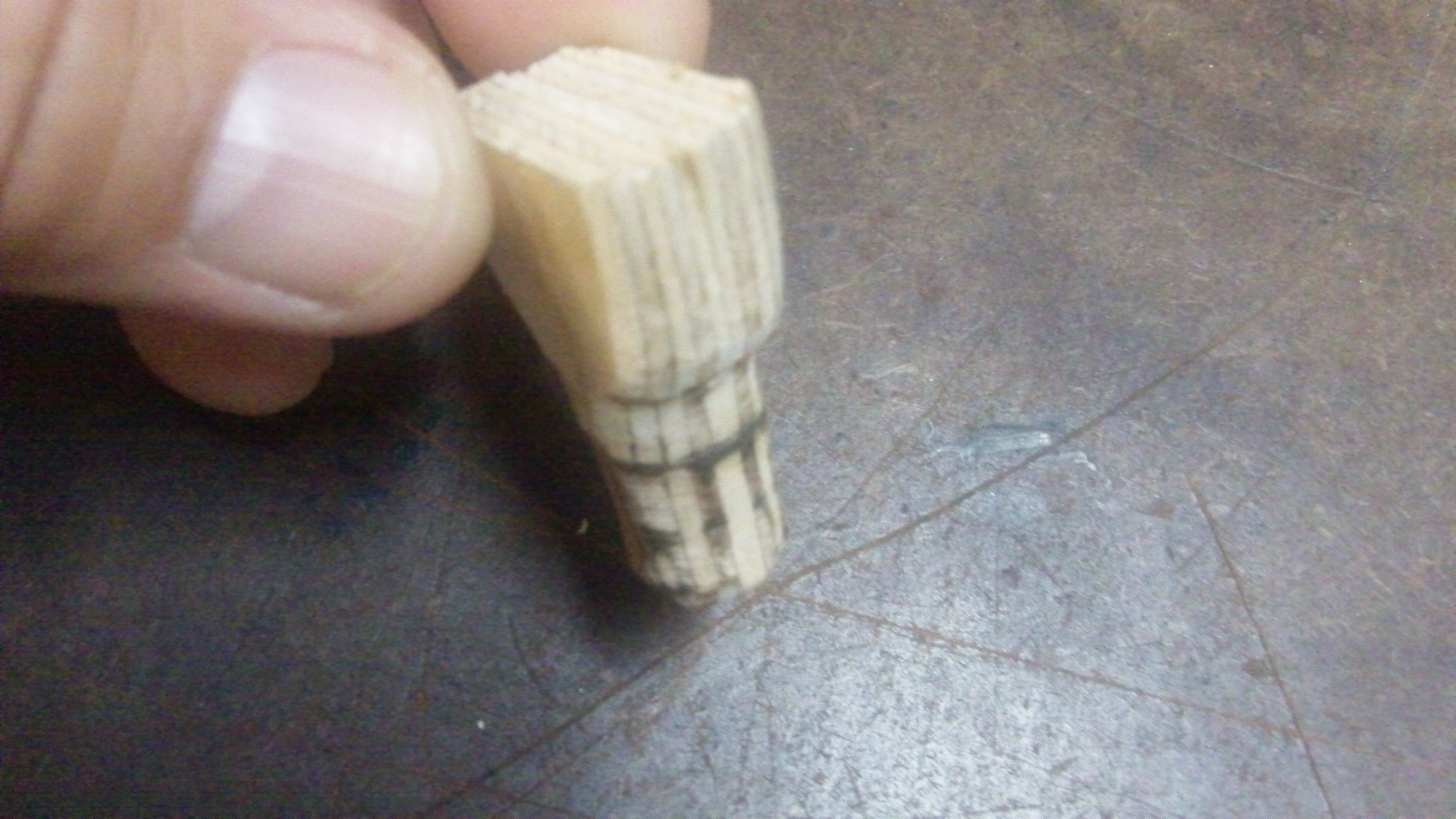

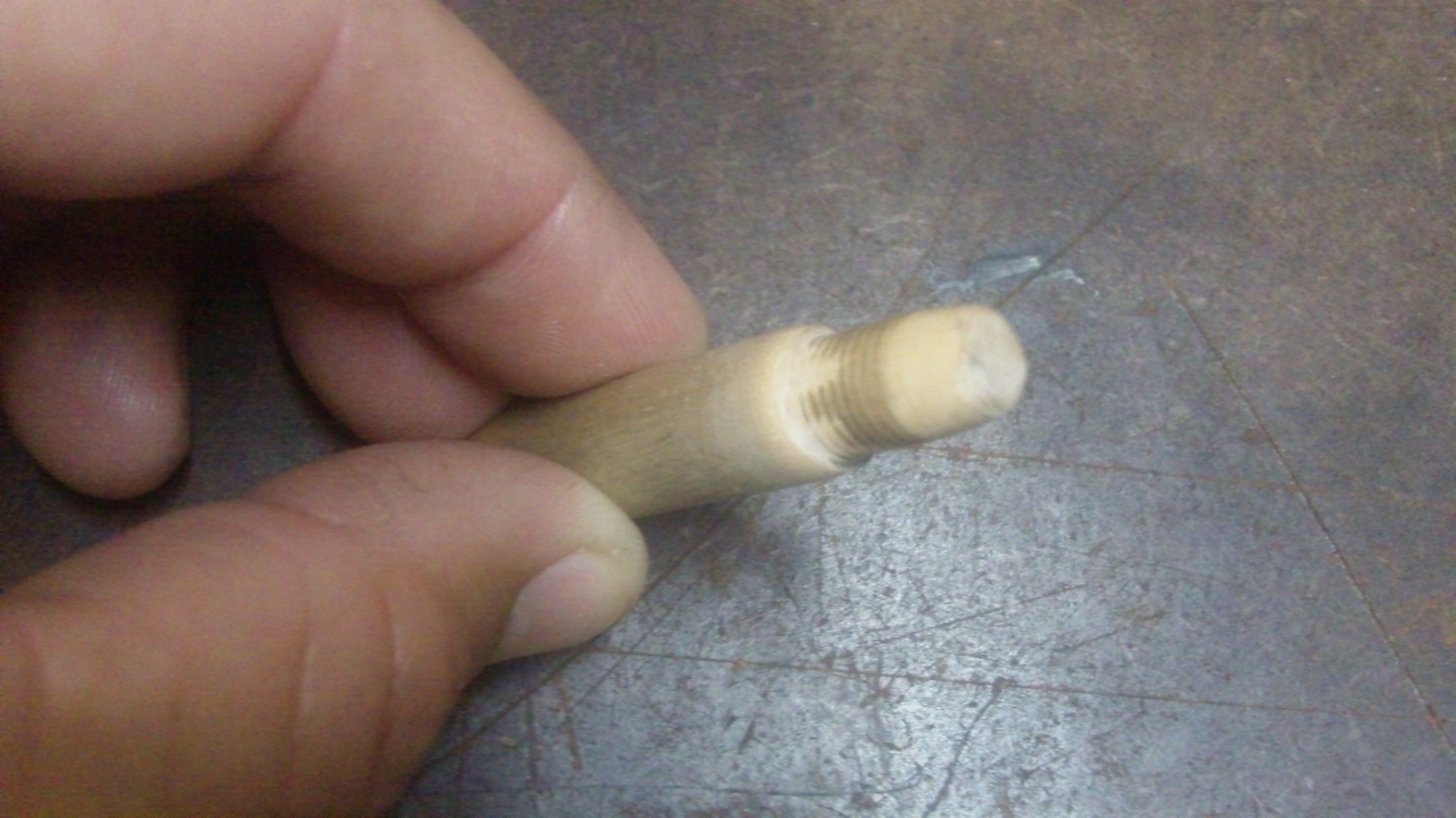

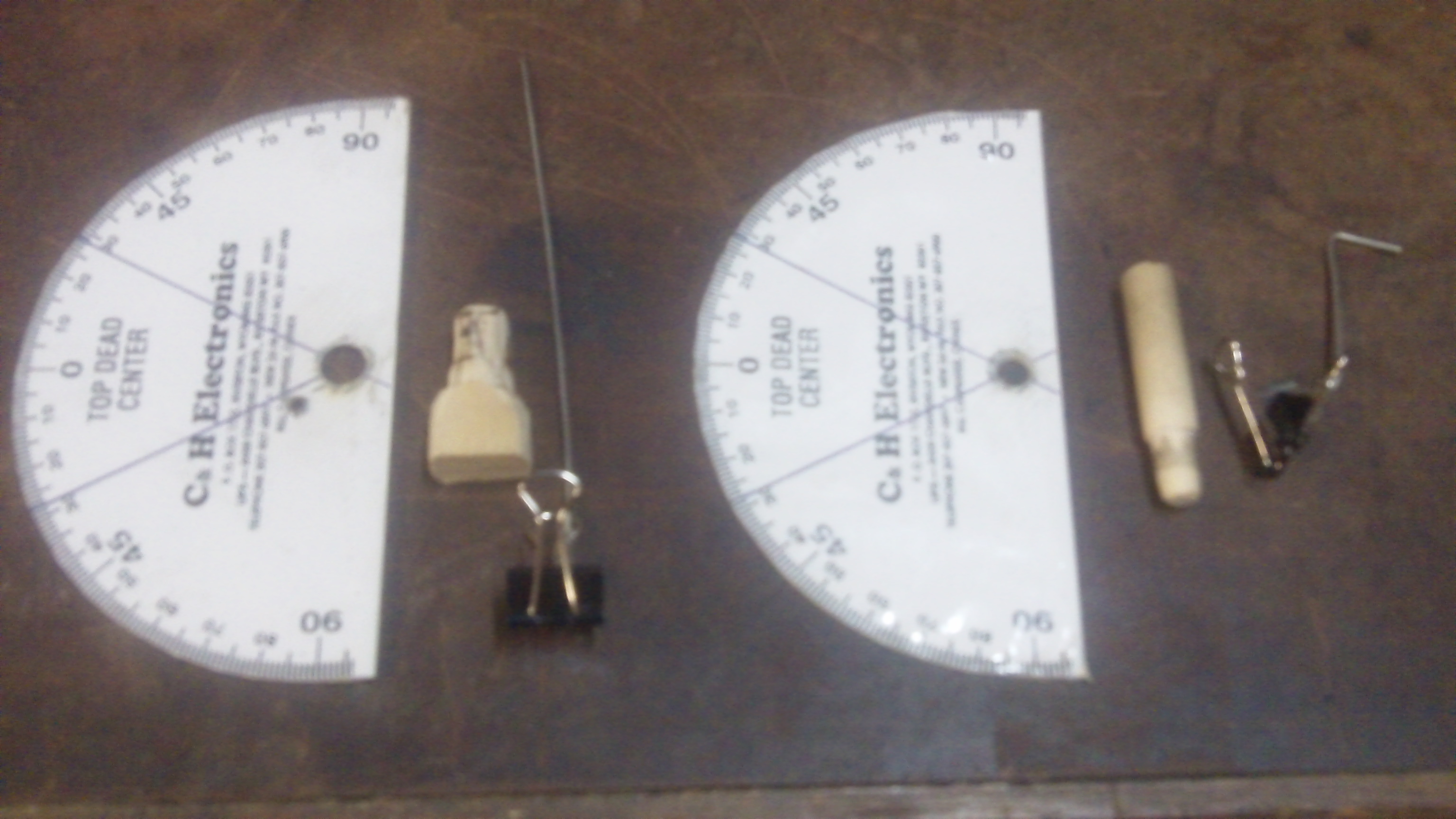

I did as you suggested, I inserted a marked dowel through the spark plug hole to ID TDC but found the piston stopper technique more accurate. This been the first time for me timing an engine I wanted to be as accurate as possible, I also confirmed that the piston stopper technique is accurate by checking that the piston was at TDC via the spark plug hole.
From now on this is how I'm going to time all my future gas engines.
How owe do you make a piston stopper? Length? Sorry my first gas engine and have no clue with timing(DLE35RA)

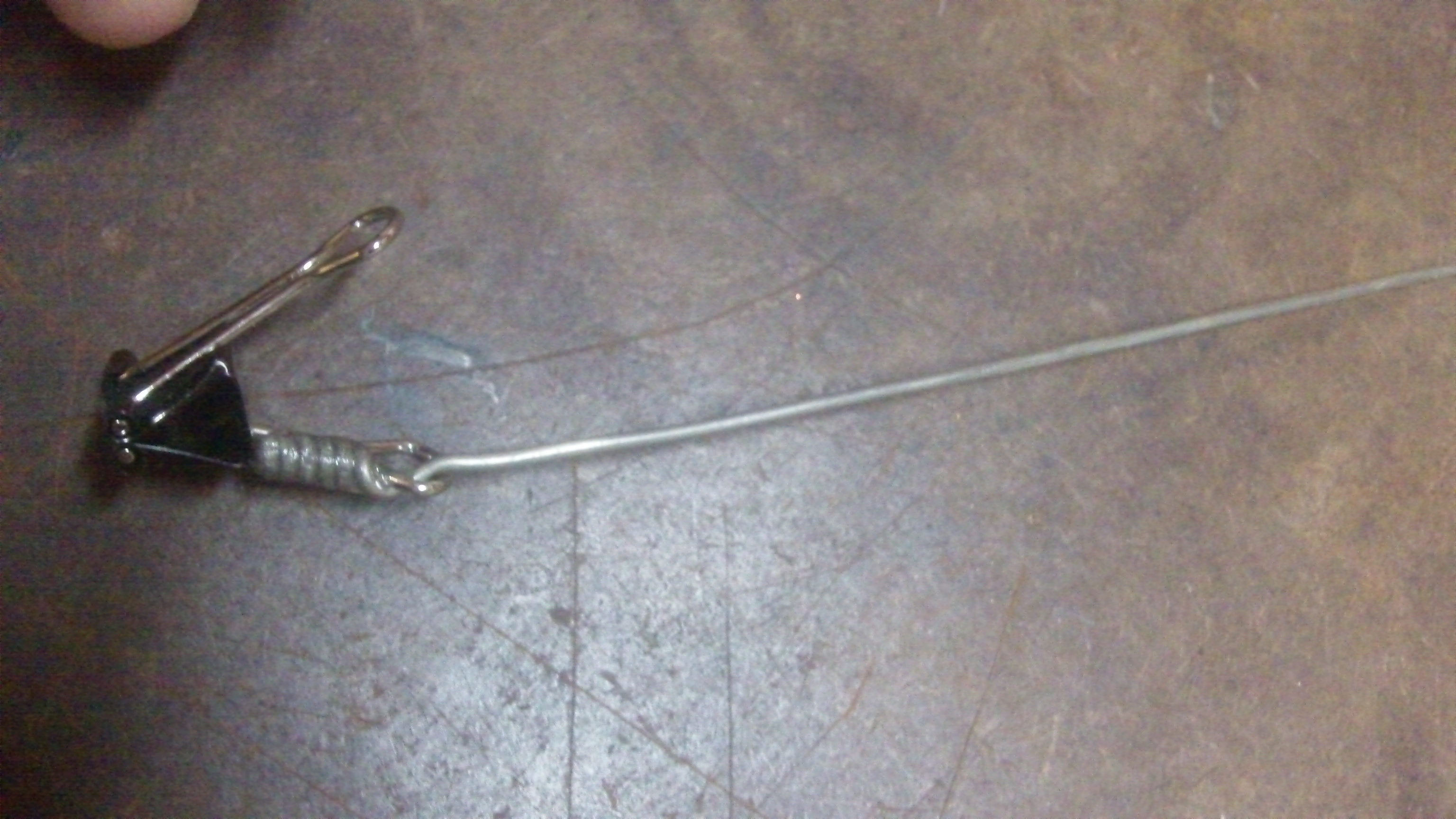

INDIOMIKE, (and everyone):
The "Positive Stop" method eliminates that "rock" at top dead center that you speak of in your post. That rock can be several degrees and if not accounted for can throw your timing setting off enough to make a difference.
The Positive Stop method splits that "rock" precisely in half and when you set up your degree wheel using that method, you can be assured that when the degree wheel indicates zero, you are truly at top dead center. Using other methods, you will more likely than not be off on your settings. This is not some obscure method invented for model engines by some amateur. It is a tried and true method used by engine builders of ALL types of engines, especially race engine builders, all over the world for precise checking and setting of valve timing events, ignition settings, etc., etc.
Further, while your method of just looking at the magnet/sensor positioning may work as a very general, "down and dirty" field check of the timing to see if the timing has slipped, it should never be used to initially set the timing. There are just too many variables with that method, such as magnet strength, magnet to sensor gap, sensor specific characteristics, magnet diameter, etc., etc. to just rely on a visual aspect of the sensor/magnet locational relation to set the timing. You need to know when the spark ACTUALLY occurs, and where TDC REALLY is to properly set the timing. It only takes a few minutes to do it correctly.
The difference between a great running engine that is a pleasure to use, and a "so so" engine or a "dog" is in the details.
AV8TOR

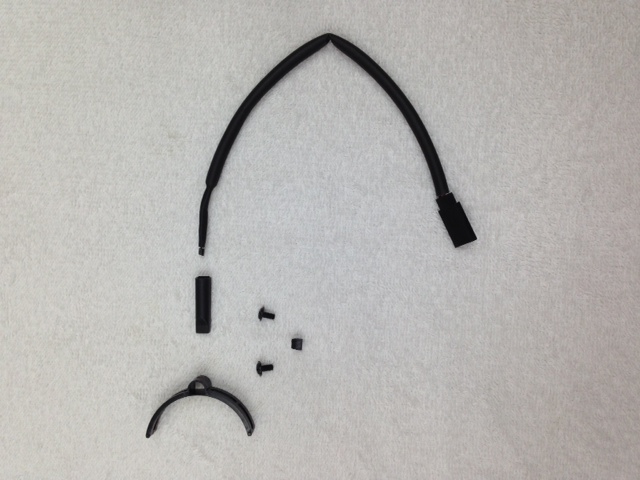

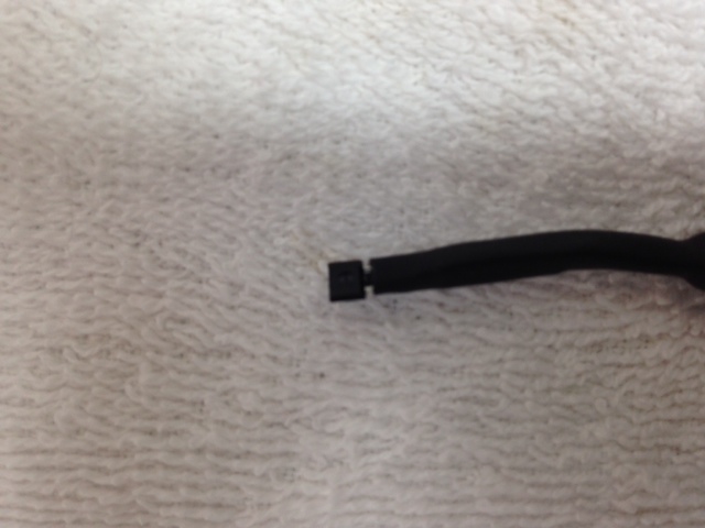

While I have used the sensor from RC Extreme Power, I have not used the one supplied by CH though I have several of the older CH ignitions. Both are excellent companies and likewise, both have participated in this thread.
I have attached photos of the RC Extreme Power sensor, also known as the RCxp sensor. This shows exactly how the sensor comes out of the package. The second photo shows just the small Hall sensor attached to the end of the cable. You will have to polarize and assemble the sensor into its holder then assemble that holder into the curved mounting bracket. The bracket exactly fits DLE and many other engines. I assembled the last one I did using rubberized and thin CA and the whole process from package to engine took less than 20 minutes with maybe another 20 minutes to drag out the necessary parts to time the engine. This is a remove the old sensor and install the new one sort of project. You will have to time the engine.

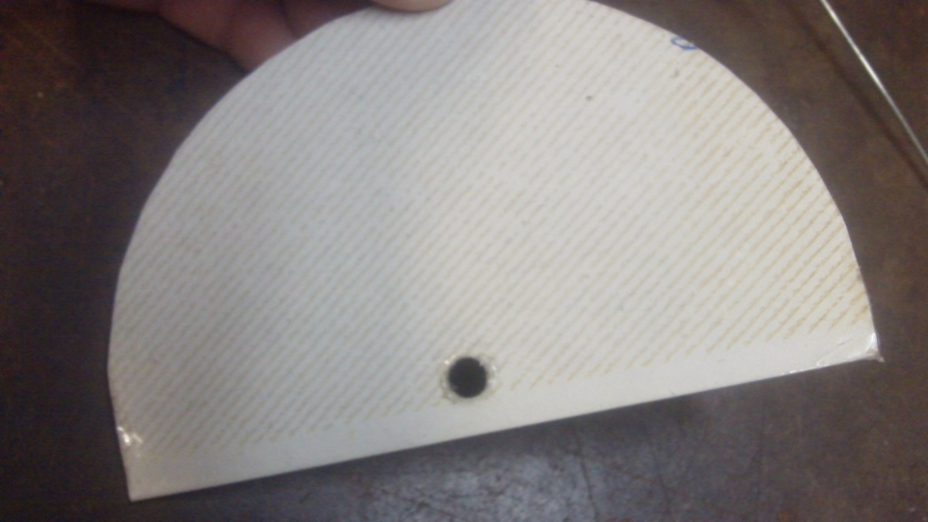

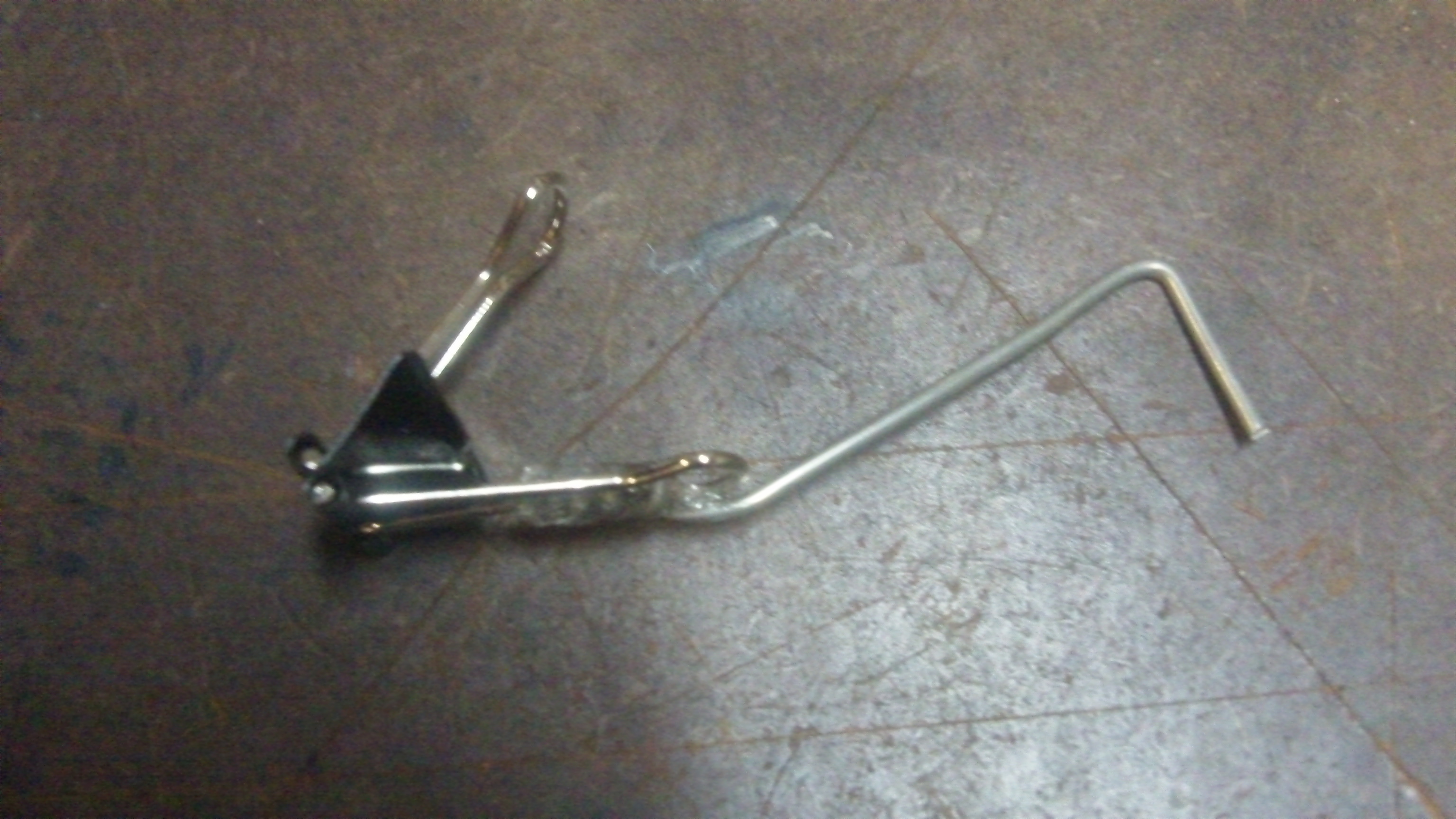

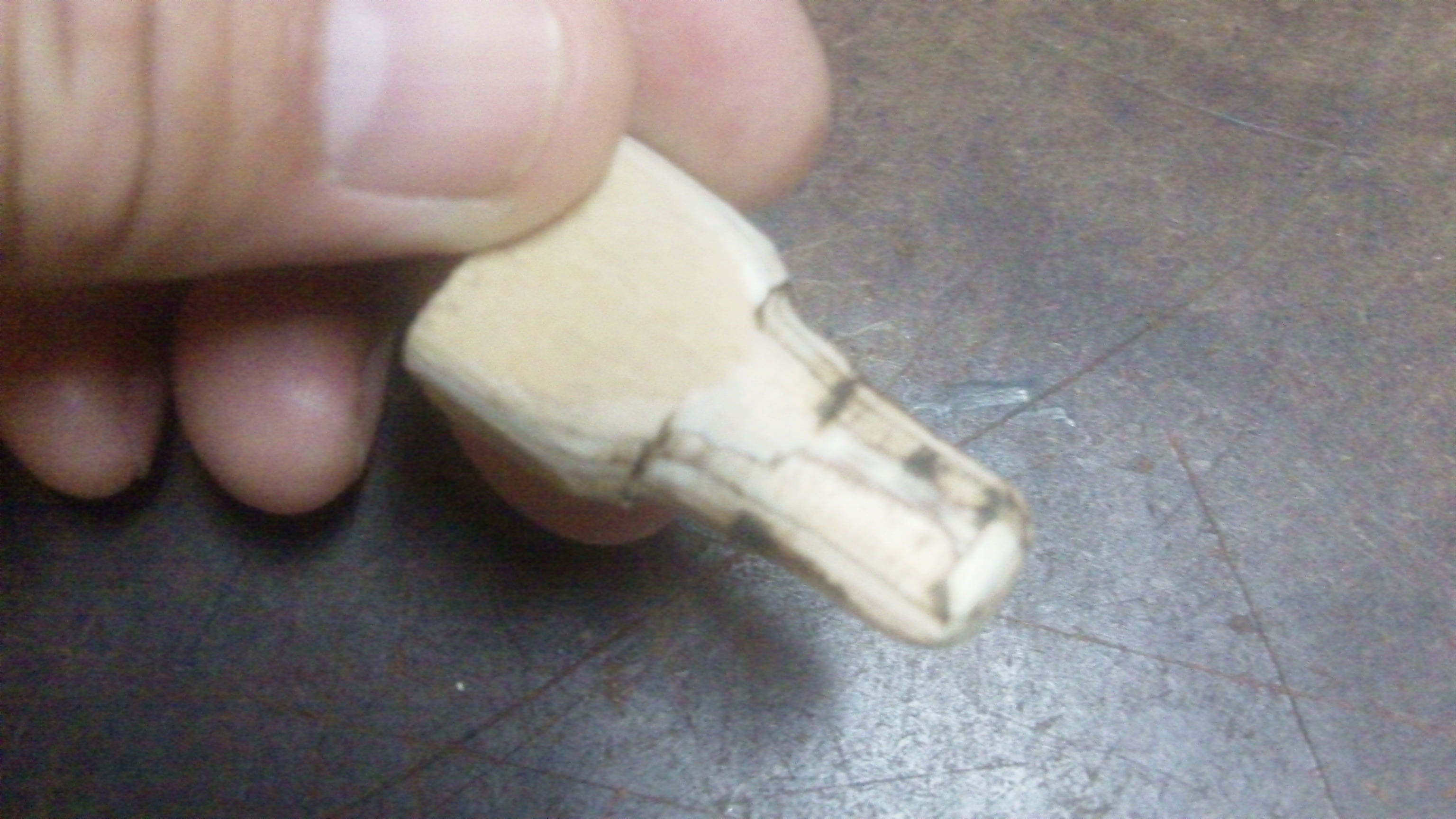

My Feedback: (7)
These are my timing tools, one set for the DLE 35 and one set for the BME 61 twin Cylinder.
The piston stopper has to be a little longer than the spark plug in order for it to touch the top if the piston when it is on its way to the top.
