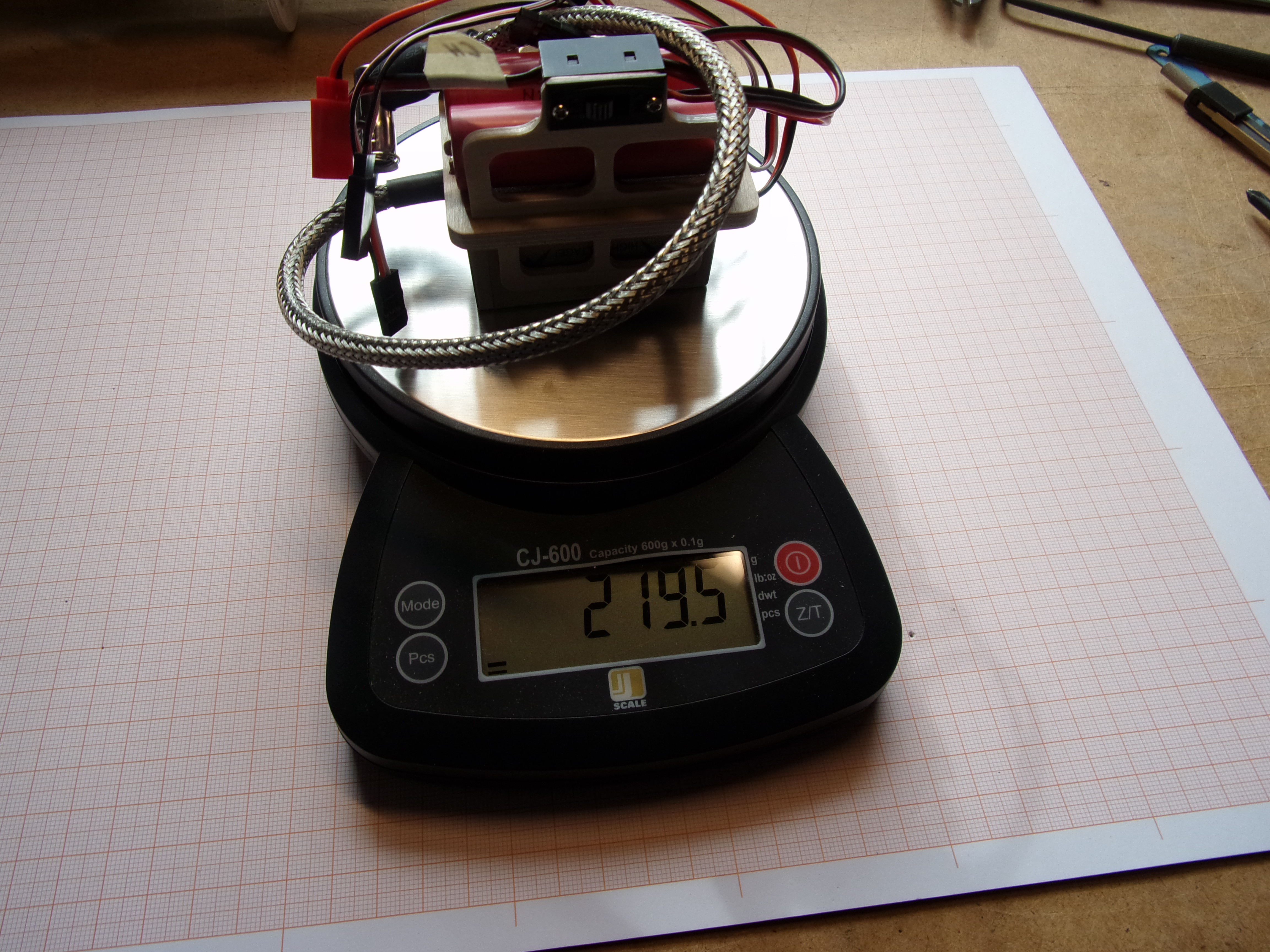

including the sensor wire, I can save around 225 grams of weight. Quite good!

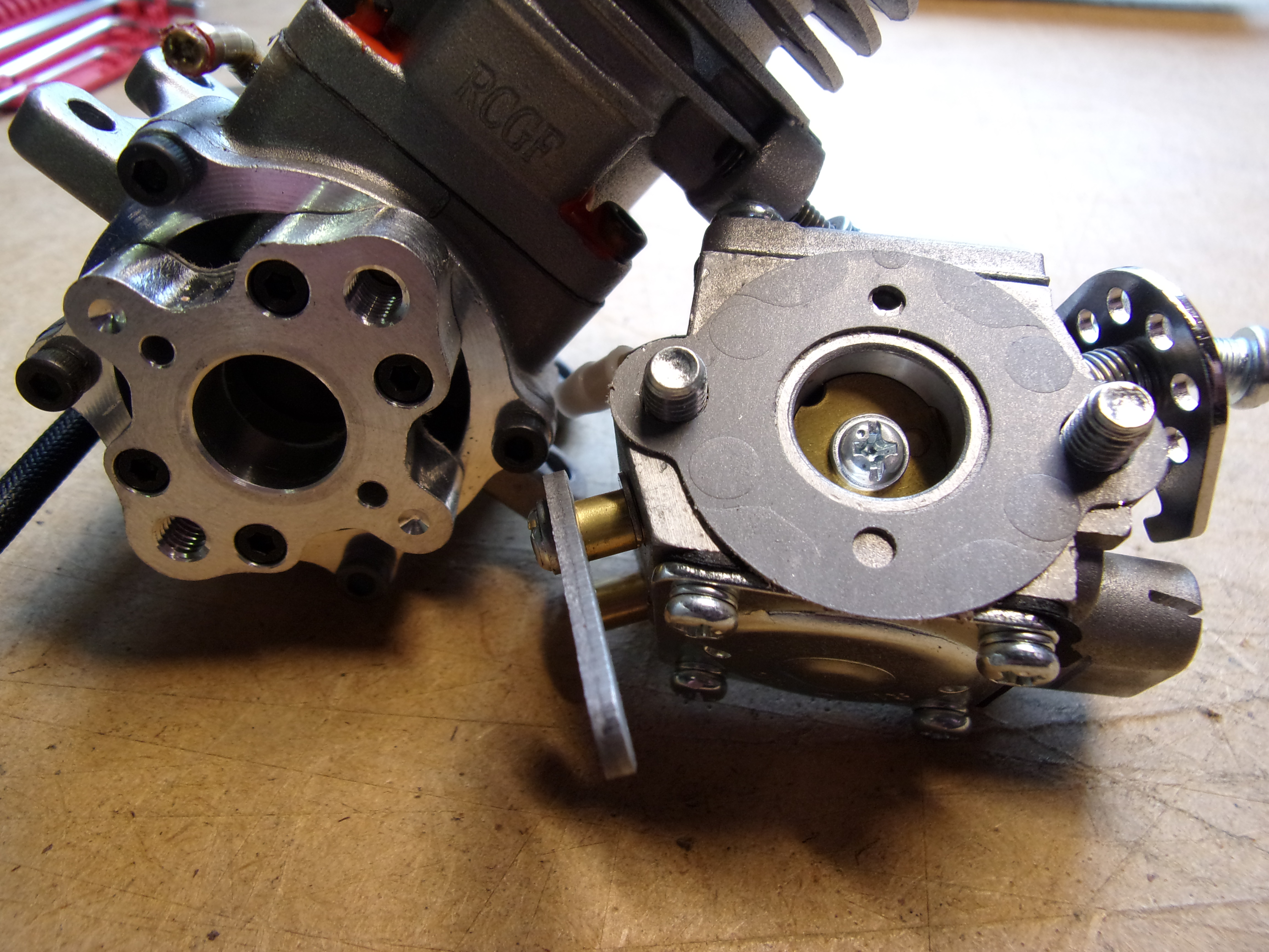

carb was turned 180° to make a real easy connection with the throttle servo. As you can see, the mounting plate and the gasket have two holes to supply the carburator pump with pressure. No mistaking.....

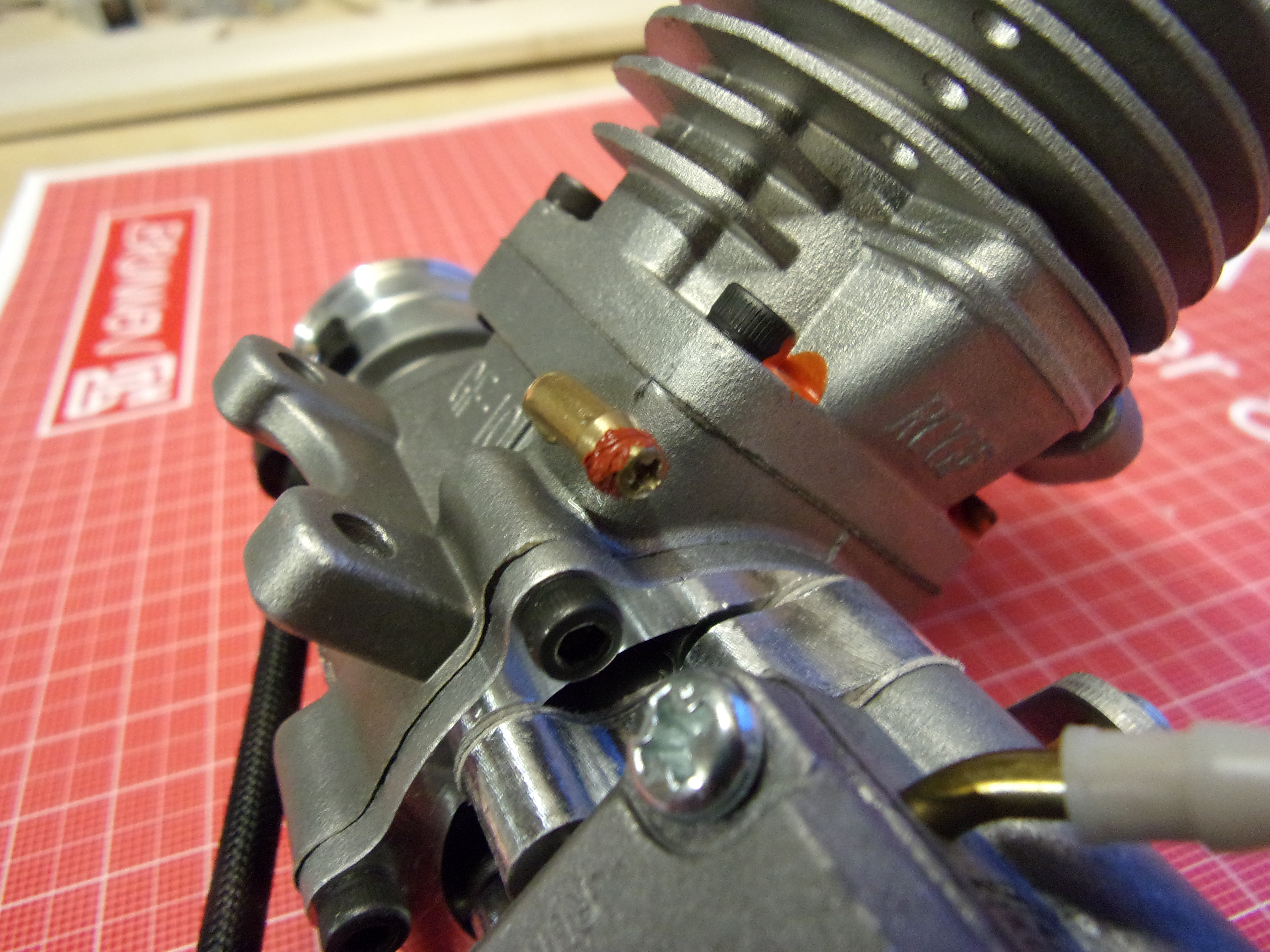

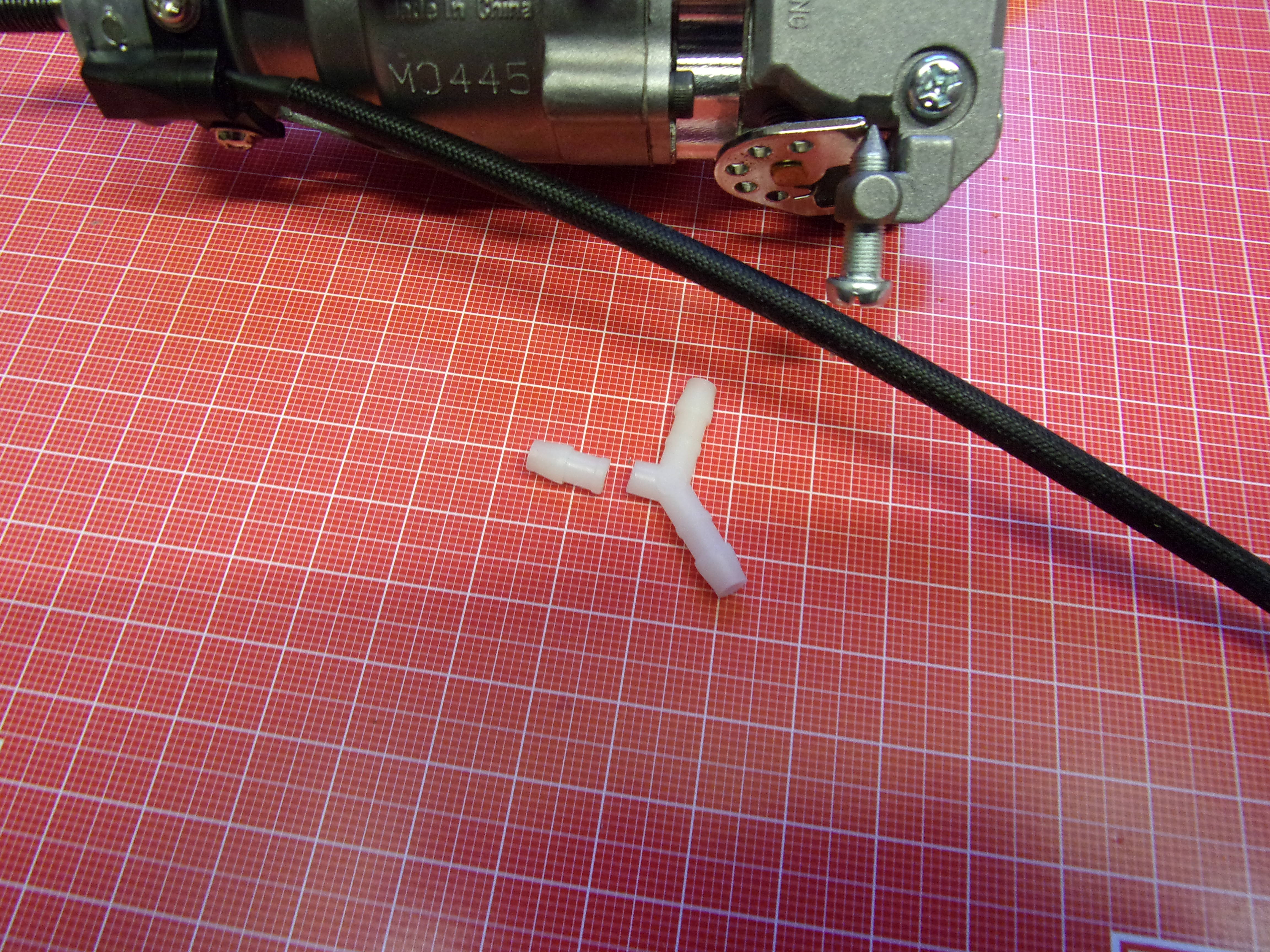

To fit the normal, big Tygon tube I had to modify the carb nipple (brass tube) with a piece cut from those plastic parts used for garden ponds or aquariums. The former nipple, for driving the separate fuel pump, was easily closed with a M2 screw and high temp silicone. Just turn it in!

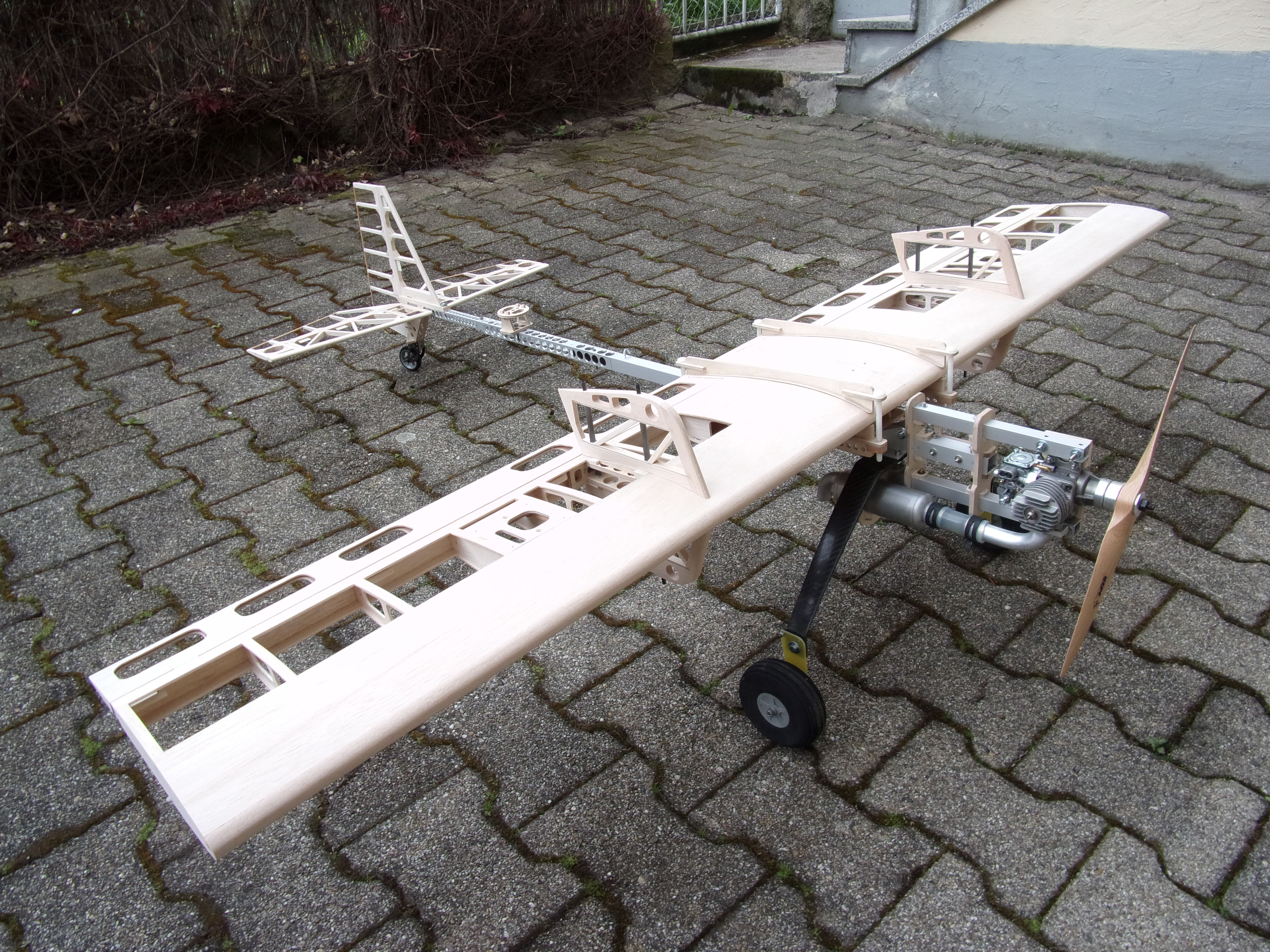

Hope to get my downsized machine ready to fly soon! Curious to see how this RCGF performs in the air and how my new SFG´s will work....... greetings from germany....Pedro
