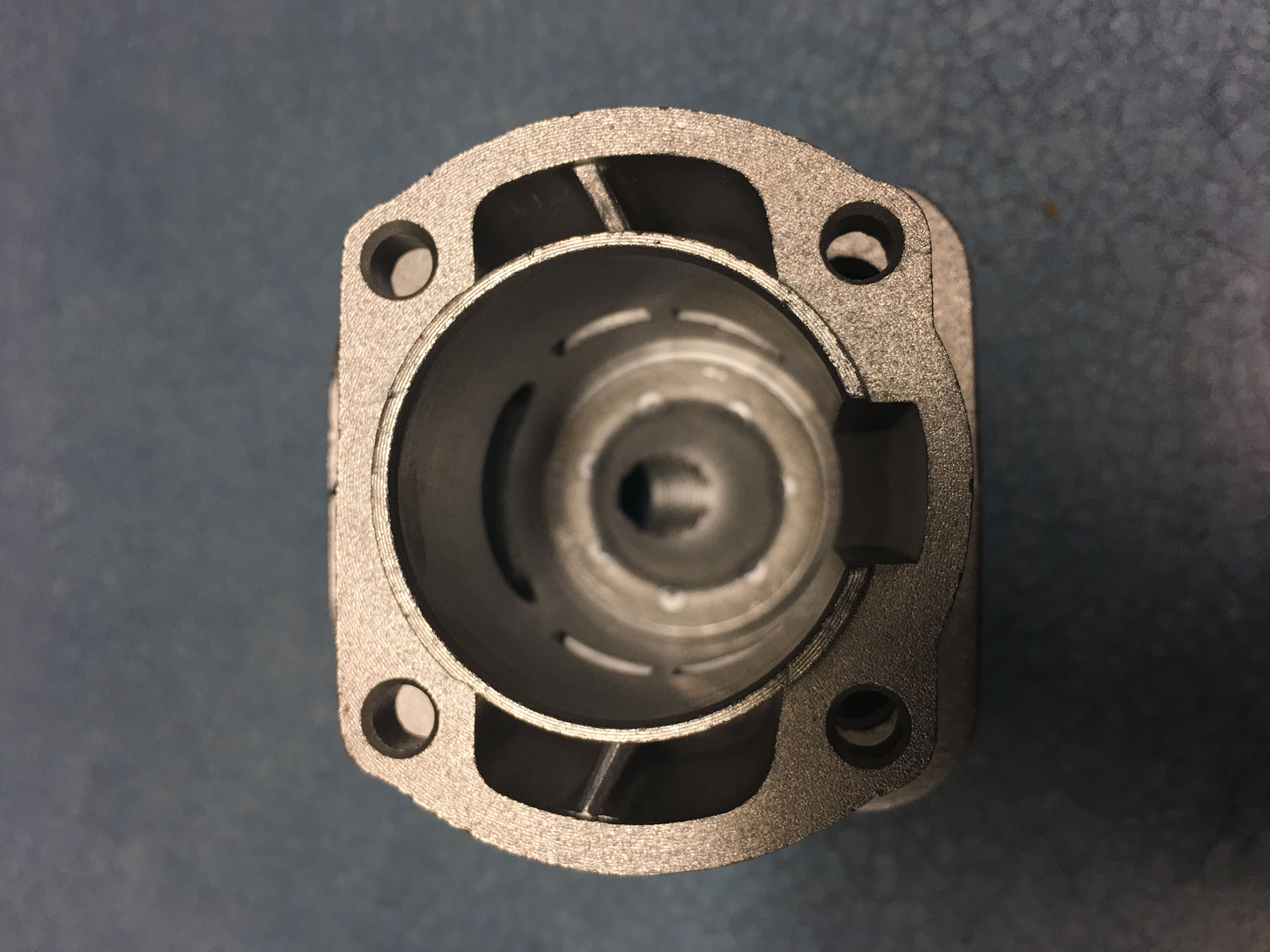

I'm starting this thread to see and share just DLE engine mods and results.
For starters I'm playing with a 20RA that's being rebuilt post crash. The head and crank took most of the impact straight in so I'm replacing the head, gaskets, both bearings and the piston ring. The crank checked out but the main bearing seems tight so for $3 a piece I'm replacing both. I considered BOCA performance bearings but I'm looking for a certain result first before I go that far.
First mod:
The left and right transfer ports have this nice blunt divider leading edge so I filed it to a sharp edge.

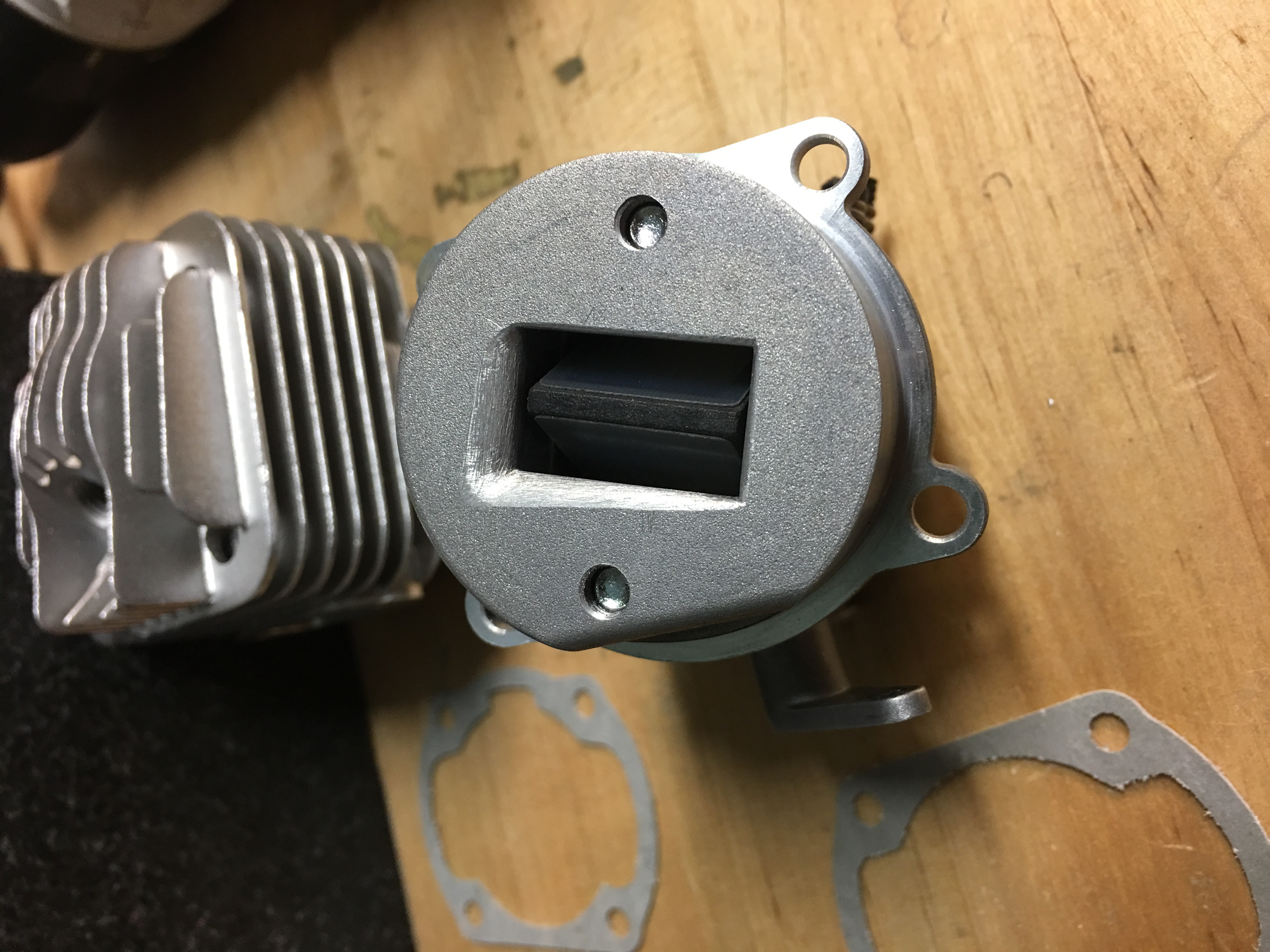

Back cover mod: The back cover helps reduce the volume of the crank case. That's great but it's also not optimized for flow. I'm going to port the cover to favor the engines natural direction and suction on the power stroke. I'll post a pic on this later. The idea here is to improve flow to the transfer port when the charge should be at its highest velocity. The port opening has very sharp square edges. I'll be adding a radius and smoothing the edges.

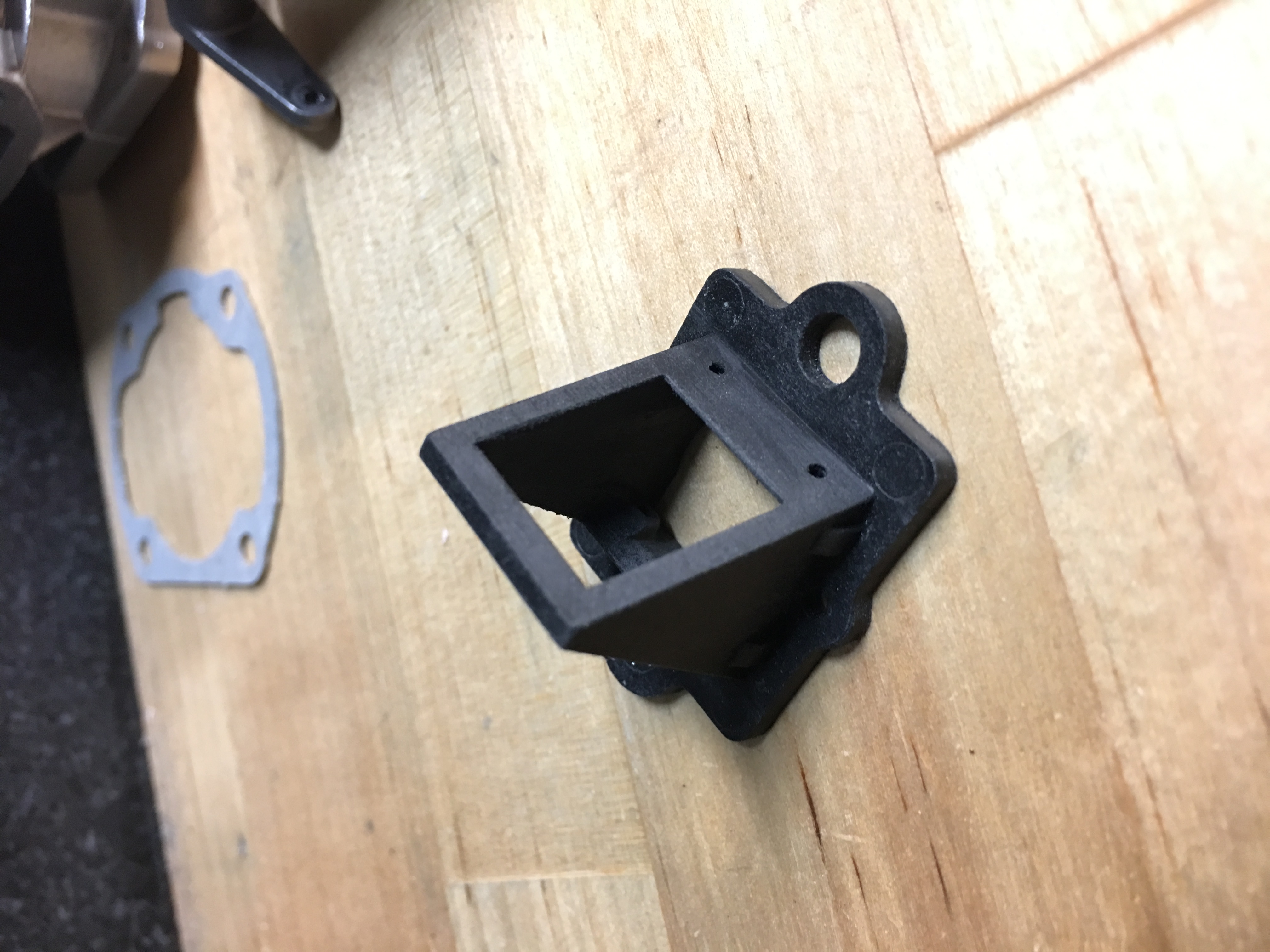

Then theres the dreaded intake reeds. This wasn't done before I was given the engine so I'll be blueprinting the reed block and making sure the reeds seat tightly to the surfaces.

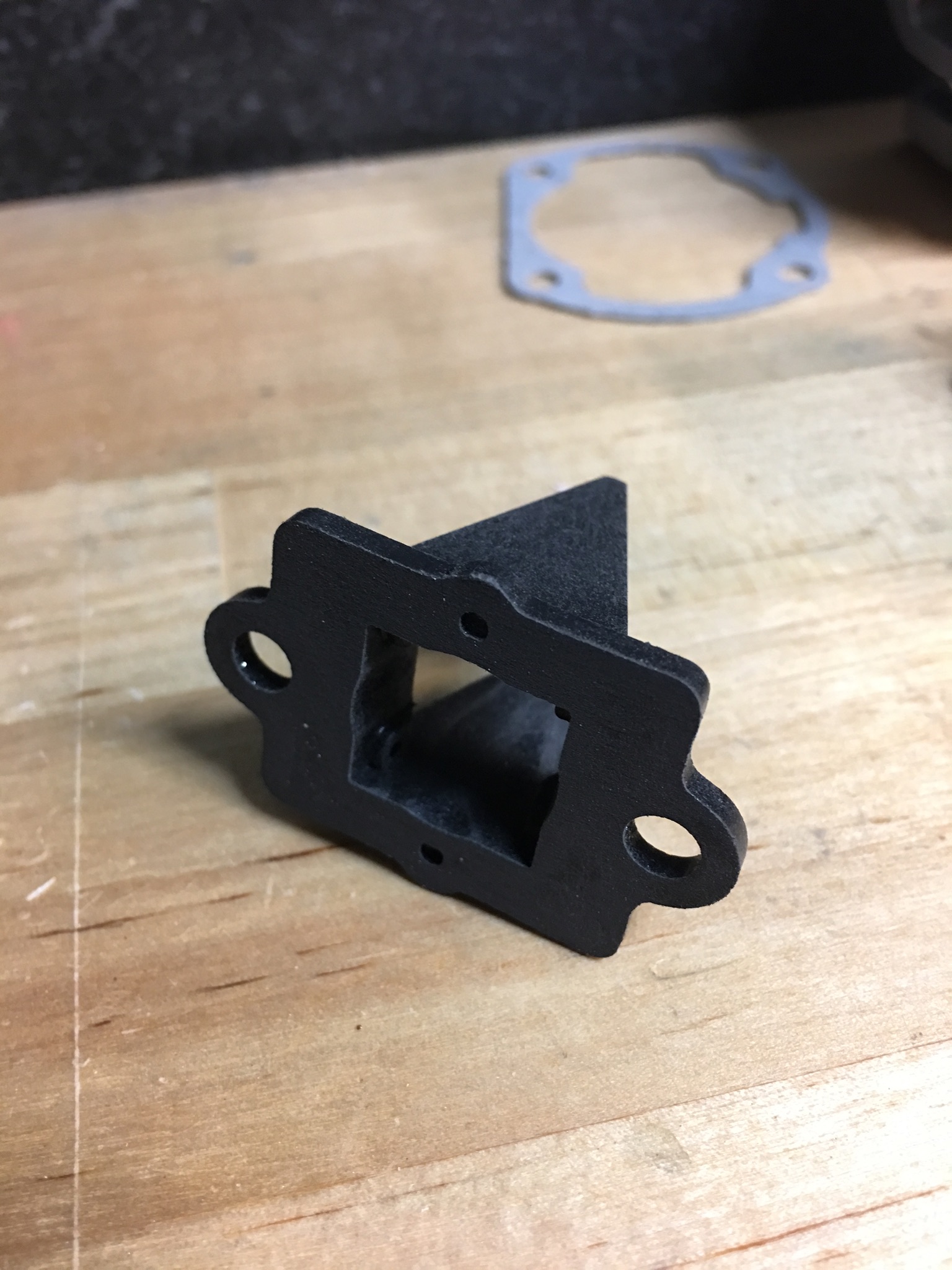

This is the back plate with a radius added to the port edges.
This is the reed block block which has been block sanded and cleaned up inside and out.

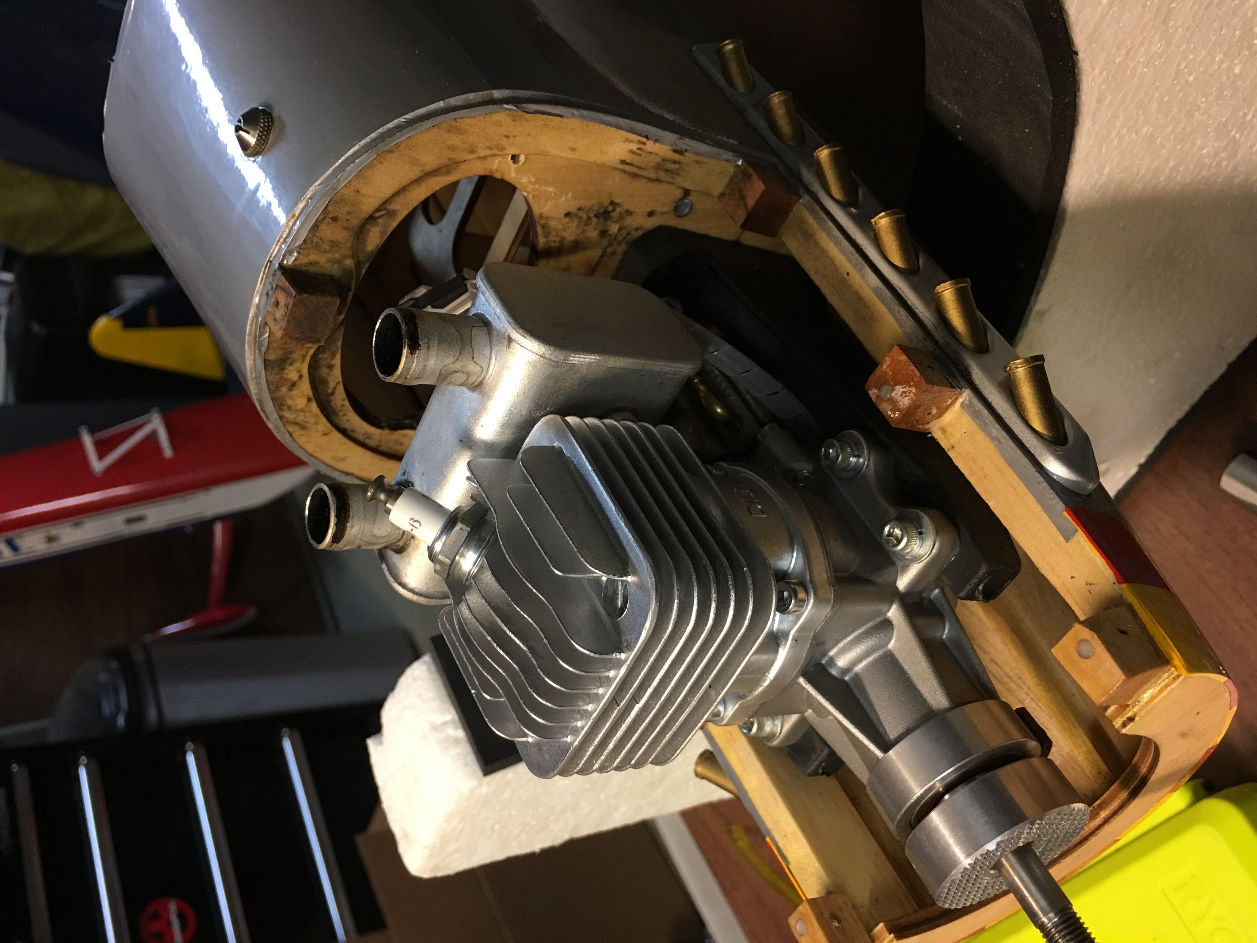

Old 11-20-2016 | 03:24 PM
Chris Nicastro's Avatar
Joined: Oct 2005
Posts: 3,148
Received 24 Likes on 22 Posts
From: Coeur d'Alene, ID

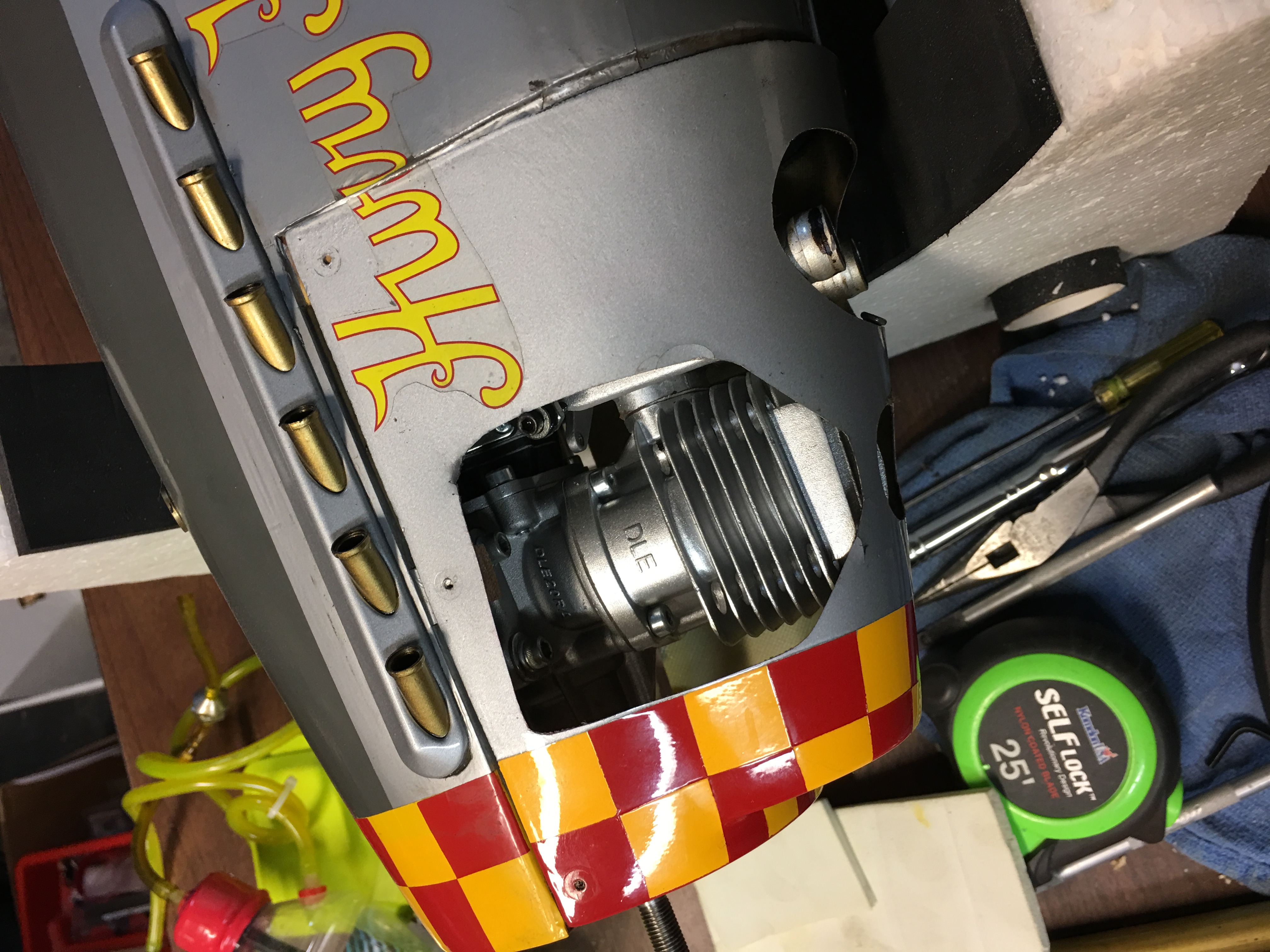

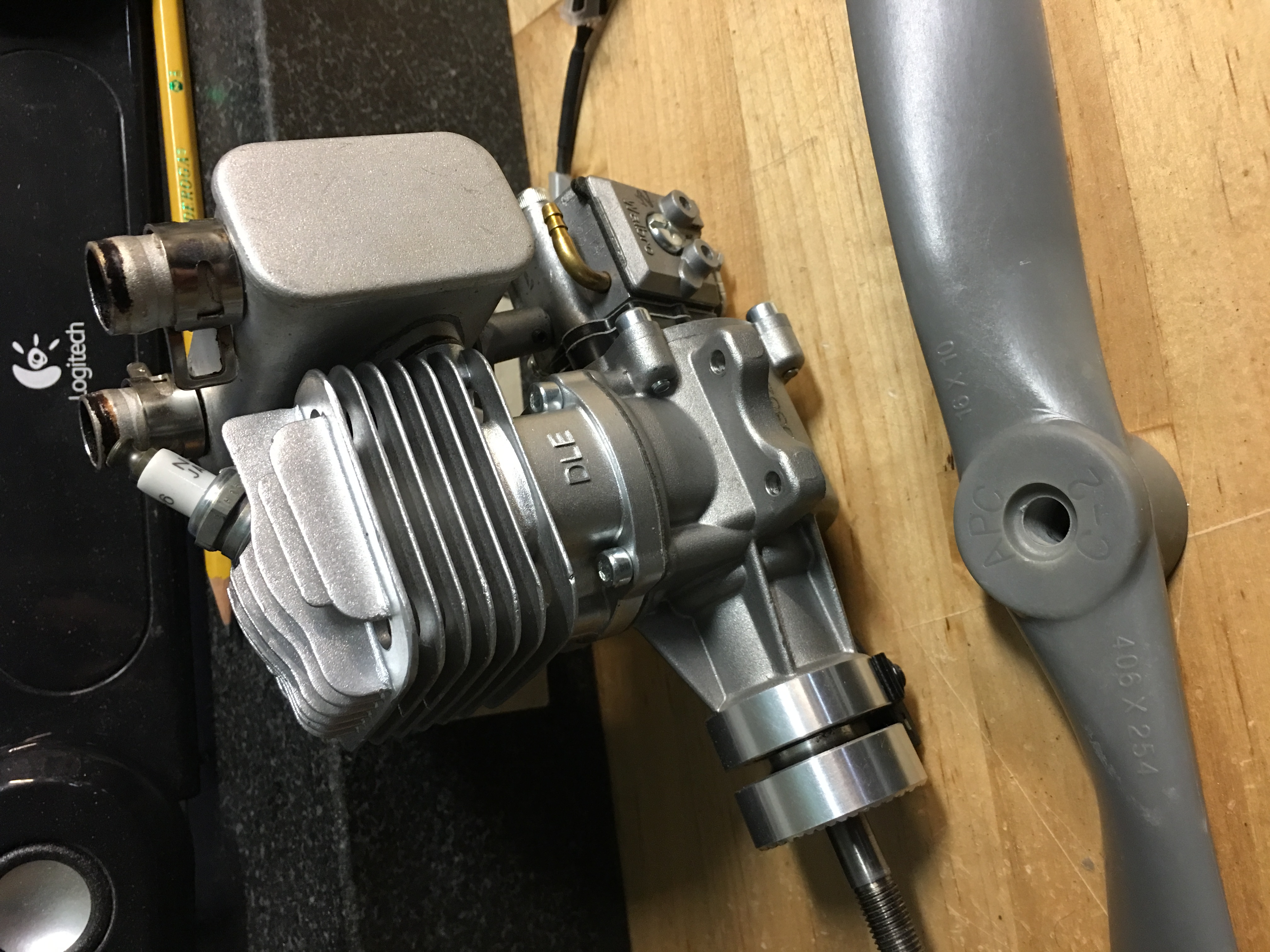

Here you can see I replaced the 20 with the RA. Huge difference and much cleaner installation I think.
