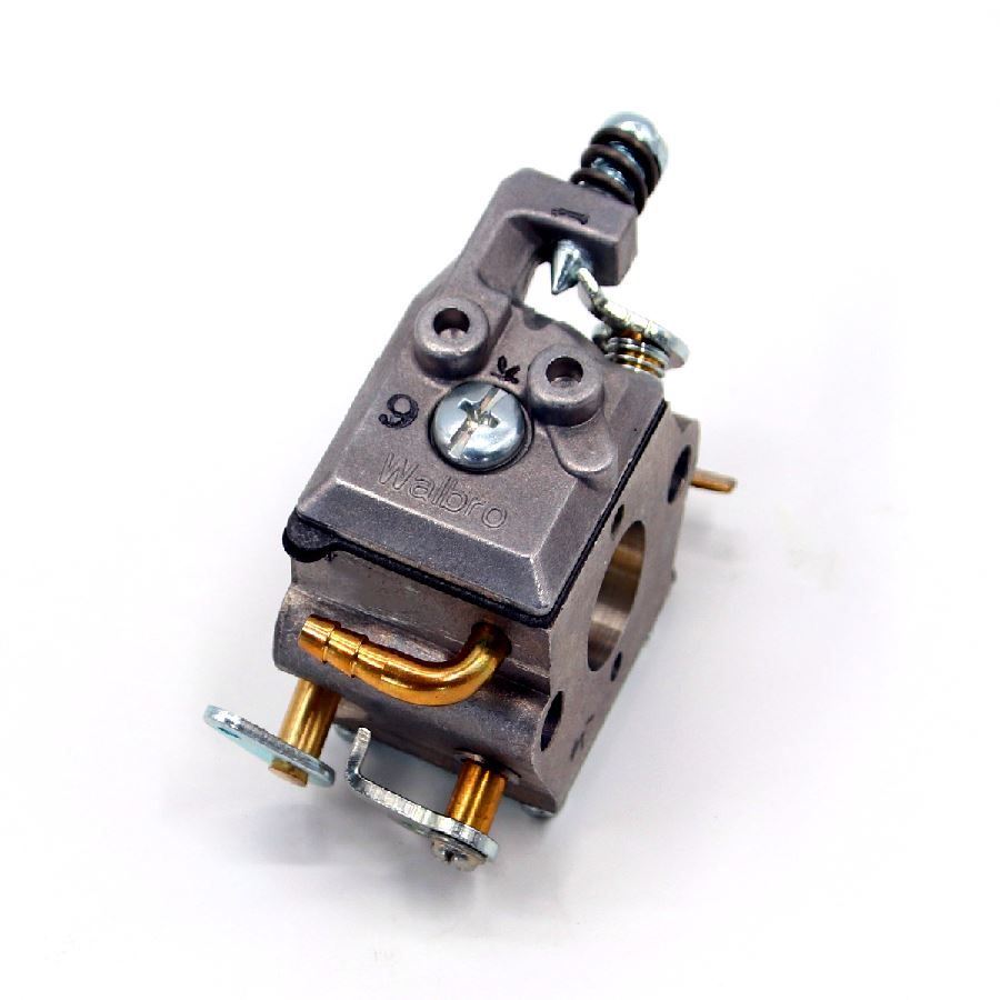

Good afternoon,
I have a problem with my RCGF 20cc: the idle is too fast. This evening I will try to replace the entire fuel line and check if the throttle butterfly is too loose. Throttle servo is ok.
Last chance I can change electronic ignition and carburator. 20cc has the same carburetor of the 15cc?
Thank you in advance
Andrea

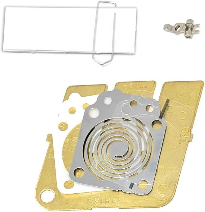

It has been a long time since a question like this has come up. The stickys above this forum have a great deal of info on common problems.
I recently had a problem with a plane I took down from storage (about five years). The problem was the regulator diaphragm was now stiff and holding the needle wide open.
I replaced the diaphragm problem solved.
So look through the stickys and go over some common issues. When I am setting my idle I often put a idle stop screw in (temporarily) so that I know the butterfly valve is very close to the idle jet to start.

Walbro K1-WYTA upgrade spiral kit
The same carb is used on all these: https://www.rcgfusa.com/product/stin...6cc-20cc-twin/
The carb is a Walbro WT 1183, I just ordered the upgrade regulator diaphragm for mine.
They use the same, WT1183, on the 10, 15, 20, 26 and 20 twin.
Walbro WT 1183-247, I don't know what the 247 designates.
