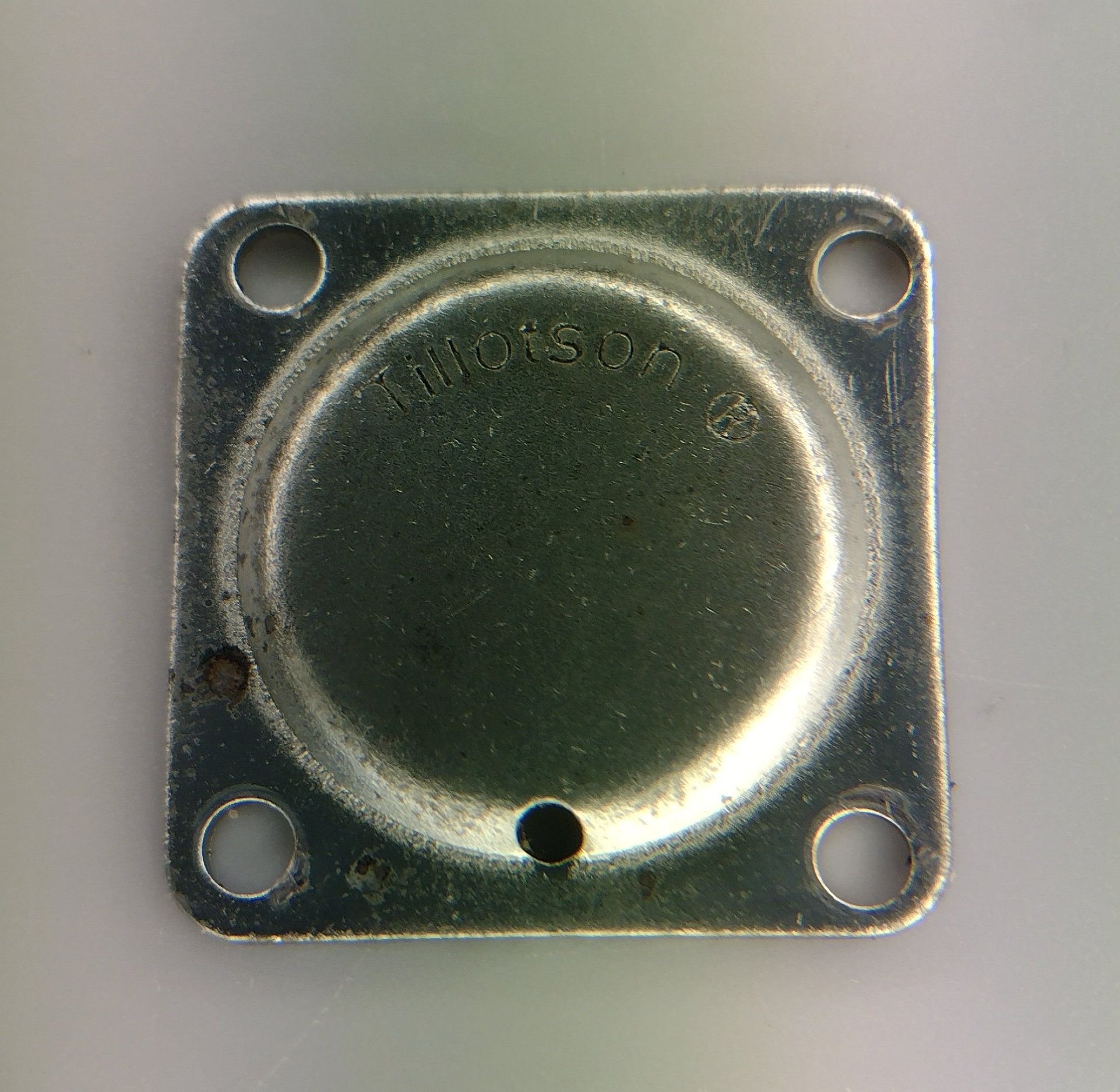

Now, please let me "pick your brain(s)" on one more item regarding this carb: Previously the engine has been running with cylinder pointing upwards but my Bucker Jungmann 1/4 scale requires me to invert the engine not to destroy its scale looks. My understanding is that the small hole in the quadratic pump cover(see attachment) should always be placed with the open hole pointing downwards in order to drain any excess fuel “outside” of the membrane so I must turn the cover accordingly..?!?!
Please correct me if I´m wrong here. My manual says nothing about this.

Having the hole pointing down is NOT because of "excess fuel", because if there would EVER be fuel coming out of that hole, the pressure regulator membrane is defective.
Having said that, there are other ways possible for moisture to collect behind that cover, like rain, condensation or perhaps fuel spillage. All three far fetched, but having the hole face down probably won't hurt, just in case.
However:
That hole serves as "atmospheric sensing hole" and in rare cases, flightwind affects the pressure regulator, if for example the propwash or such blows straight into that hole.
Some people therefore solder a short piece of tubing on the hole, and slip on a piece of fuel tubing that leads to a "quieter place", for example in the fuselage behind the firewall.
It is rarely necessary, but I have seen it once or twice that the engine ran perfect on the ground, but became unpredictable and erratic in the air, with no needle setting that would cure it. In those rare cases the additional fuel tubing, quieting down the wind roar in the sensing hole would solve the issue.
Since you are relocating the engine to another plane, the possibility arises that this engine, once running great in its previous situation, could act up as these things are unpredictable. Rare, but unpredictable.

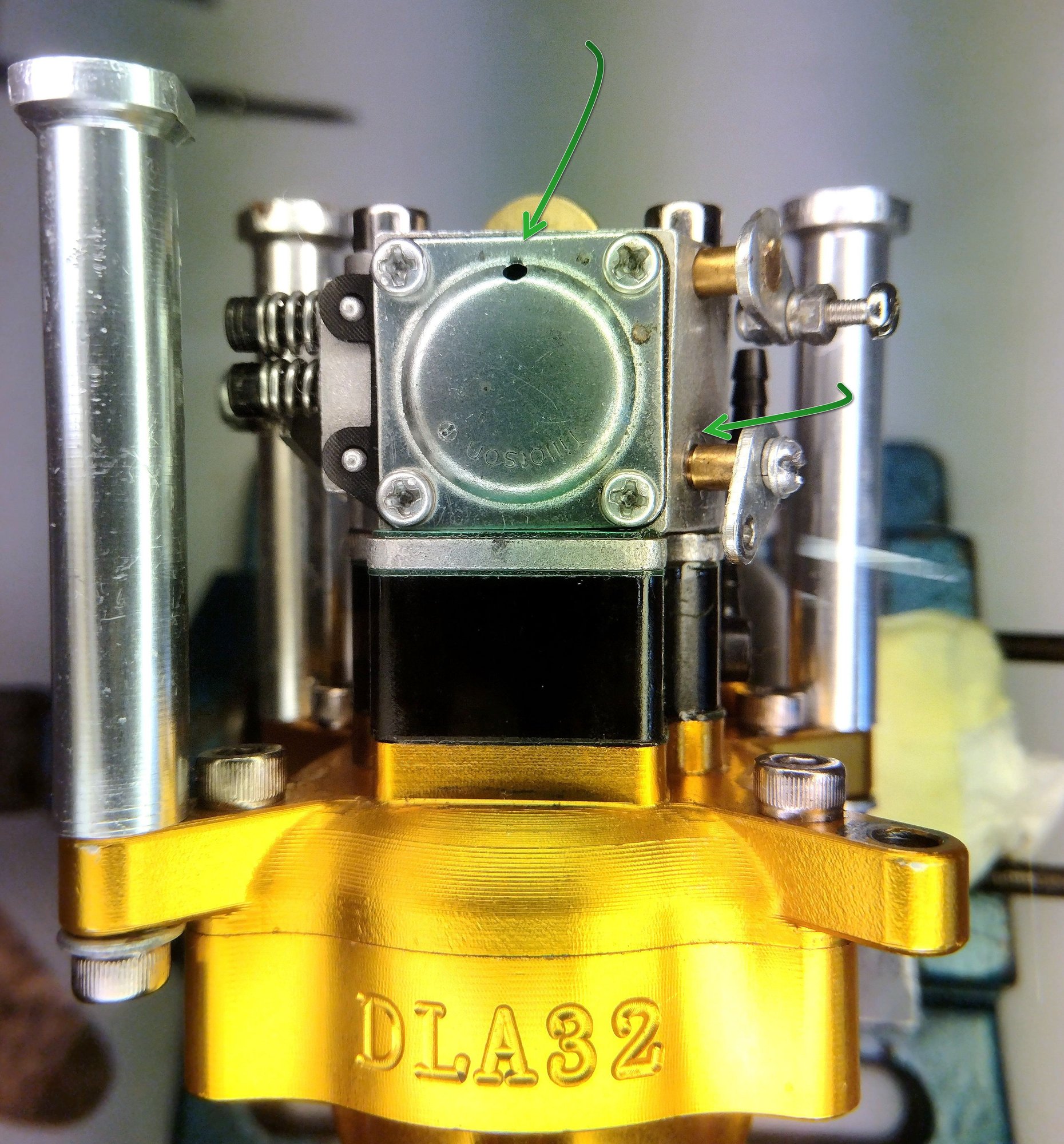

Now the carb is assembled and mounted to the engine. As you see it is not about up or down - sorry my fault - but rather forward/rearward or sidewise for the sensing hole. I guess no-one can say for sure which way is to be preferred.. so I will let it point rearwards for the time being
. Viewpoints please..!!

That location should not be any issue. Being unfamiliar with the engine I assumed (yes, I know, I shouldn't have done that, it's got the word "ass" in it) that the carb would be mounted on the cylinder, sideways (port-induction), like many of the Zenoah's, which would much more expose the carb to high velocity airflow.
I do not expect any issues there.

Thanks again brutus.! If you look at the second green arrow to the lower right you will notice that the C-clip is missing from the throttle axle. This is intentional since the throttle axle will not move freely and will not close butterfly completely with this clip in place. The reason is that the return spring pulls the axle axially, forcing the C-clip to rub hard against the throttle body....! My intention is to have the butterfly pulled by the servo from fully closed to "full bore" and NOT utilise the idle speed adjustment screw on the carb. This enables me to shut down the engine with the throttle if need be. Does that make sense to you..?
The spring is a rudimentary thing because these carbs are mainly intended for gas powered tools and such, and you need a returnspring and idle screw for those applications.
For RC use, you can omit the spring, and IF that allows reinstalling the circlip, I would do so: Any additional clearance and vibration will cause wear at the bore eventually. Better to minimize that.
As for shutting down the engine by means of the throttle, I would not rely on that. Butterfly carbs, unlike barrel-valve carbs, do not necessarily seal off the intake (they can, they should but it is not inherently guaranteed by the butterfly design) so chances are over time, this method of stopping becomes less and less reliable.
